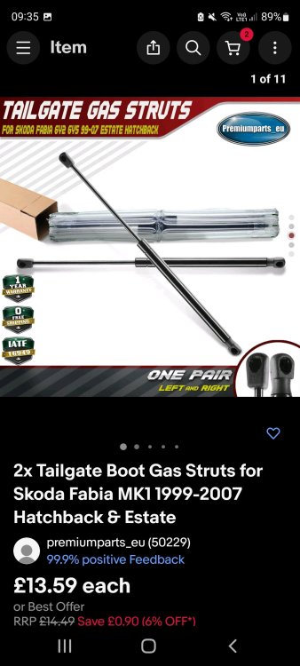

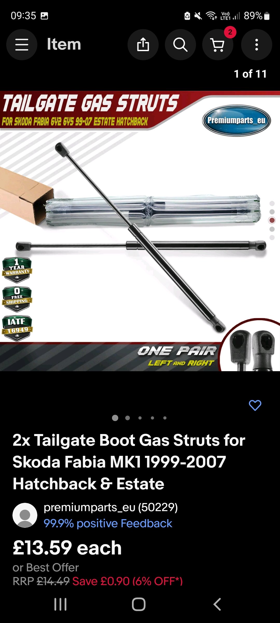

Jeez a lot of overthinking going on here. These are what I've got, they're very good.
Just as a note for the OP.
The vehicle check thing on eBay continuously recognises my 2006 Mk1 Fabia as a Mk2 for whatever reason. To overcome this I enter the info to say its a 2005 model instead.
Screenshot_20220912-093529_eBay.thumb.jpg.b2f668ff6086d19c34f99cef567b1213.jpgi
i ACTUALLY ORDERED THESE BEFORE i SAW YOUR POST - HAVING CHECKED WITH THE SUPPLIER - BUT THANKS
