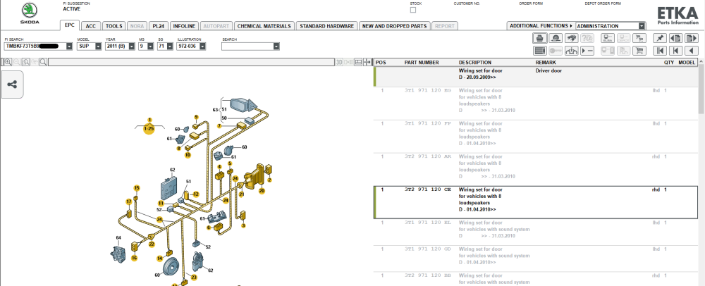

32 minutes ago, Breezy_Pete said:
3t1 part number would be for a LHD car, no?
Usually yes
21 minutes ago, 2thin2swim said:
And 3T2 rhd?
Usually yes

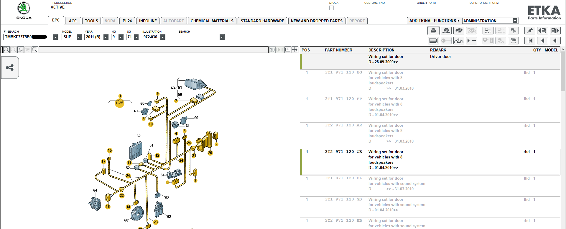

The cars made up to 27.09.2009 only had 3T1 looms
After this date then you have exactly as you say 3T1 LHD 3T2 RHD.
The image above was because that's the closest we have to you loom label you pictured.
Hopefully tomorrow I can get details from VIN search as to what was fitted from factory (we can perhaps assume the label is incorrect at this point)
8 hours ago, varooom said:
Usually yes
Usually yes
Interesting. You'd imagine that pre 09.2009 loom parts would be more abundant and lower cost? And I guess that's why I seem to be able to buy one from Slovakia. It's still €179 though!

Here is your VIN decoded (handy to know what was fitted)
TMBKF73T5B9------.pdf
And turns out my guesstimate was correct on the part number
Either order up this part, or maybe send the loom over to @Breezy_Pete to see if he can fix your old one?
