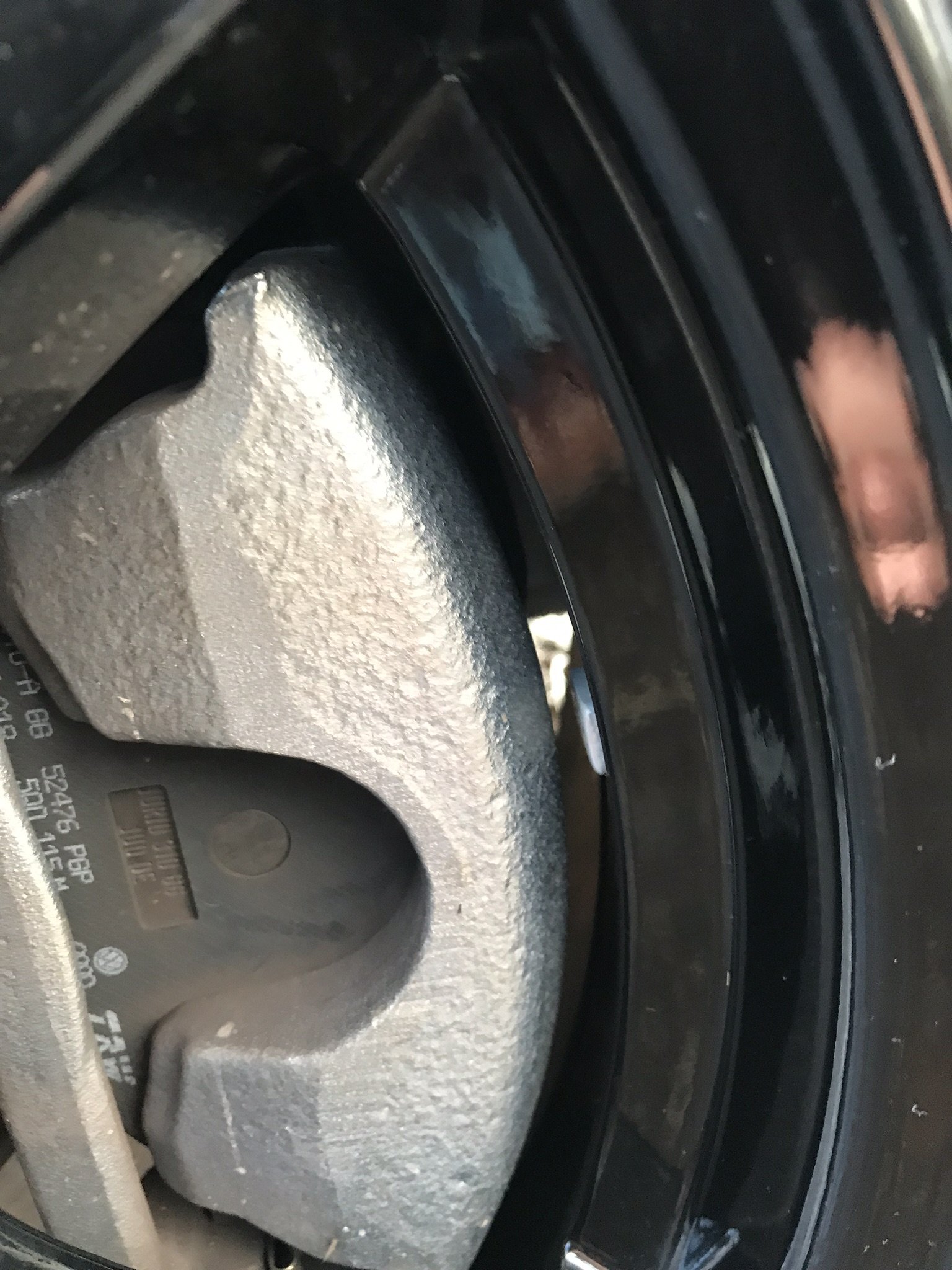

If I can find the funds the wheels will be 18"ers, not going for the 17s, too tight clearances and the speedo is going to out as well, so I'll stick with the 18"ers

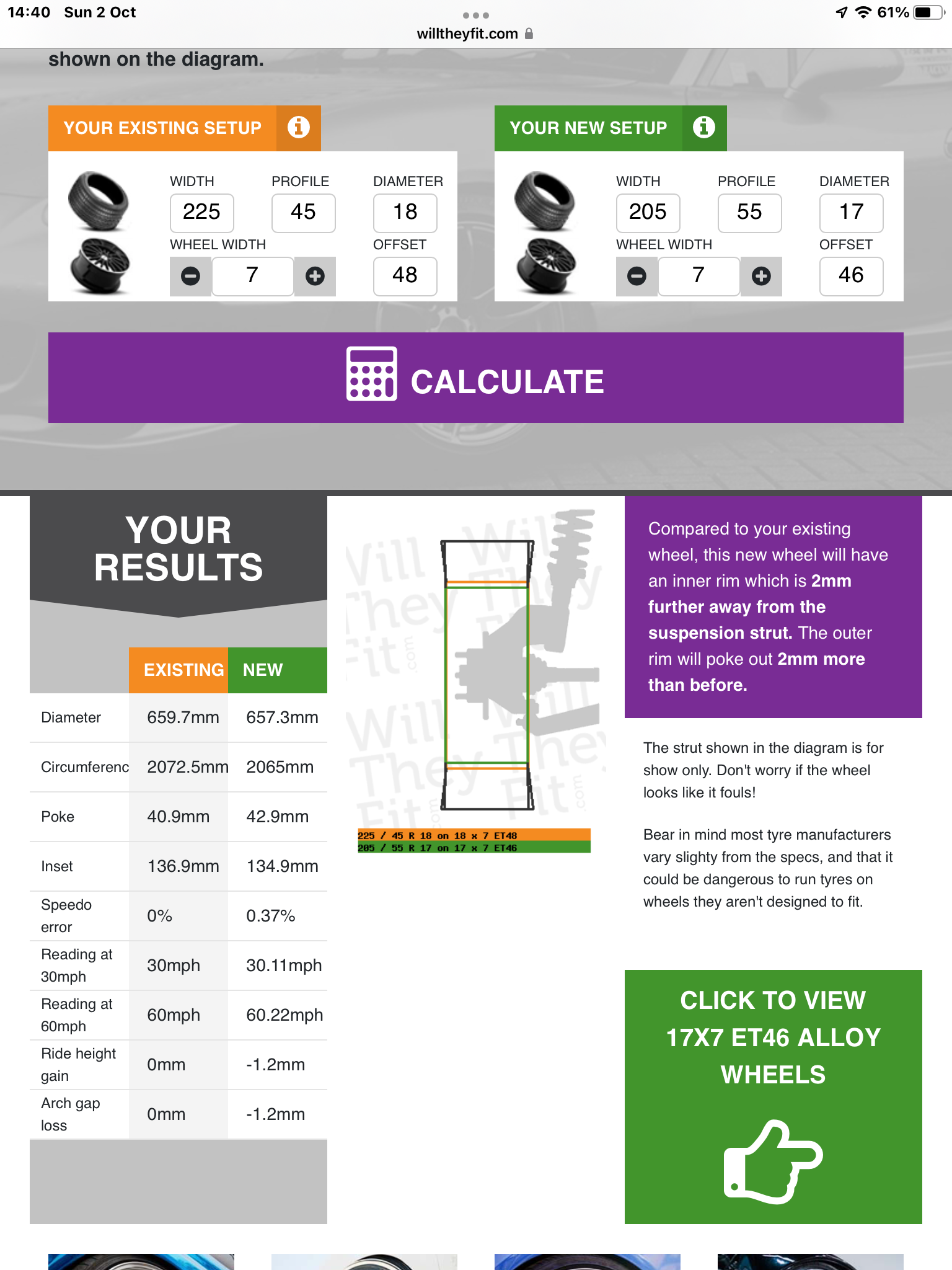

The speedo won’t” be out” fitting 17” wheels with the correct tyres. As you can see the overall diameter/ circumference difference is negligible.
There is about 4-5mm difference between new tread and worn tyres (which equates to 8-10mm diameter difference) so there is no point in even thinking about a 2mm diameter difference.
Winter tyres often have deeper treads (7.5mm - 8mm) so overall difference might turn out to be under a mm
