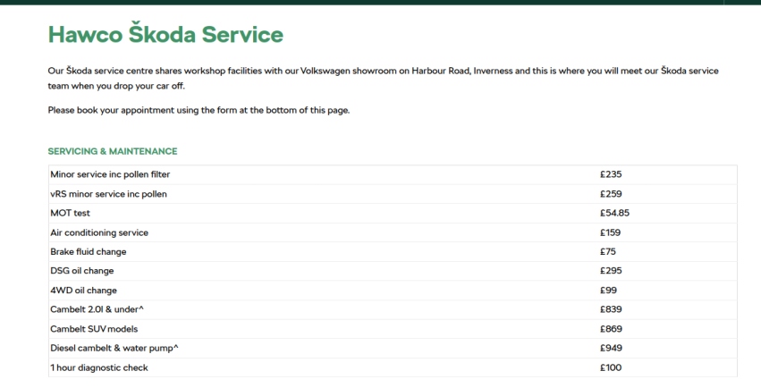

@Yeti333
Skoda fixed price offer on Spark Plugs is now £120.
As to £ 500 flat rate Timing Belt replacement any model  forget that, think more like £1,000 (even near to £1,200) on a 1.5 TSI ACT, and that is not including a water pump which is not required.
Petrol 1.2 TSI might be the cheapest, and maybe a bit more on a 1.0TSI or 1.4 TSI. and more on a 1.4 TSI ACT. but a lot more on a 1.5 TSI ACT when it is over 6 hours labour, some are still saying 7.5 hours.
(There are Service Desk staff quoting £555, but they will soon find out that is a mistake on their part.)
Then there are those Official Repairers with their own prices and no longer 'Participating Dealers' doing  'Skoda Fixed Price Servicing & Maintenance, 3-10 year old cars.

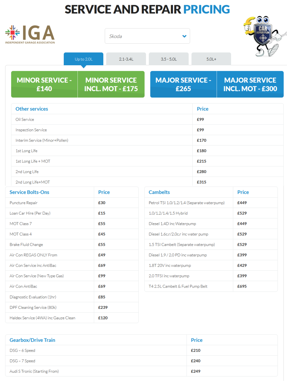

https://lvsag.co.uk/services/service-repair/
This is our local Independent VAG service centre LVSAG at Lincoln service rates.
I get them to do anything I would rather not do myself like cam-belt change
