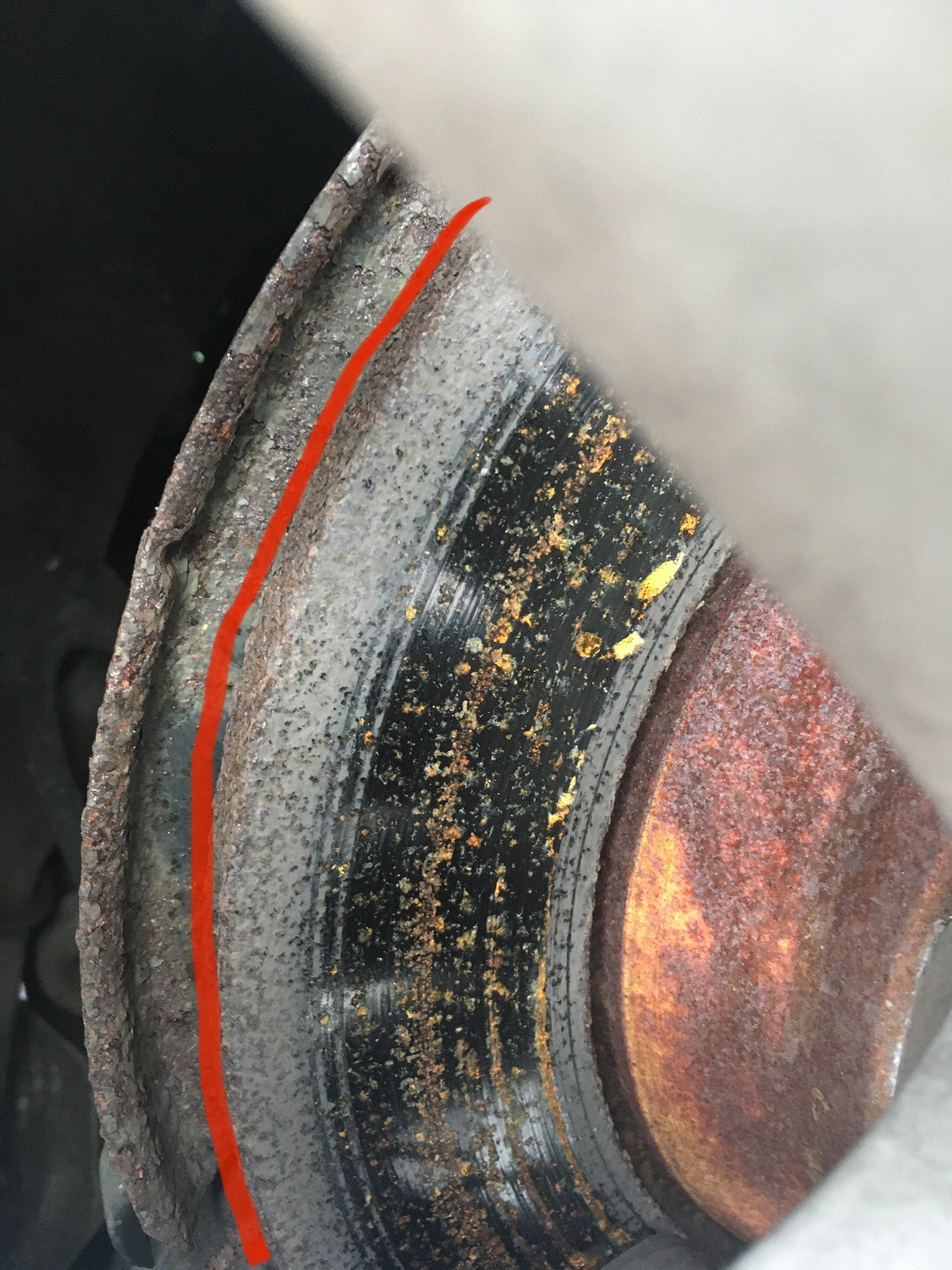

What do your rear discs look like? Upload a picture if you can as it’s always a laugh
This was mine before I replaced, ignore the red line. This was at around 37k miles732F1C78-17CE-4F82-BEBE-461F975BEE1A.thumb.jpeg.1876116cb211691021a8df5a94893137.jpeg the outer section was never used 😂
Edited by Danoid
They're not too bad, but definitely have some wear.
