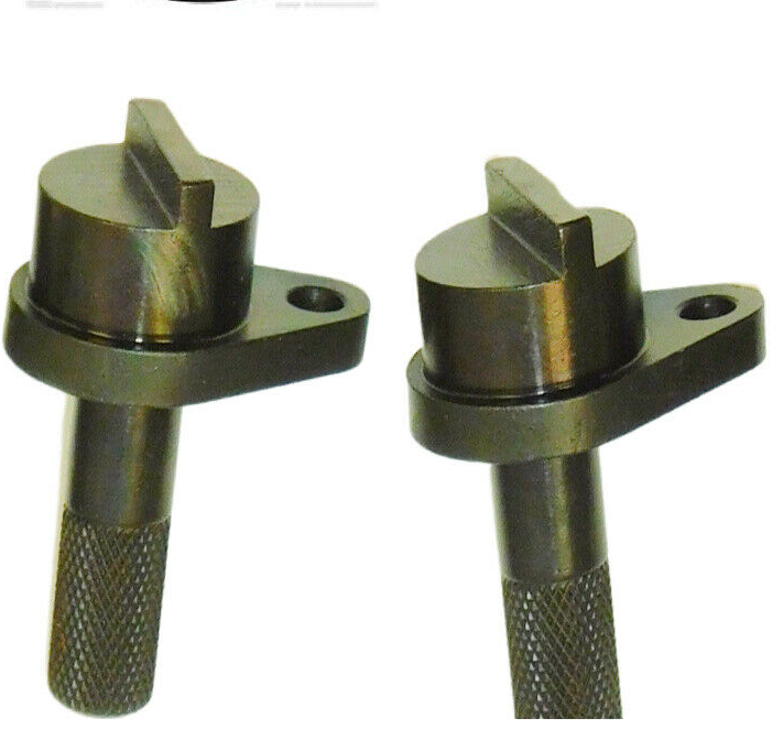

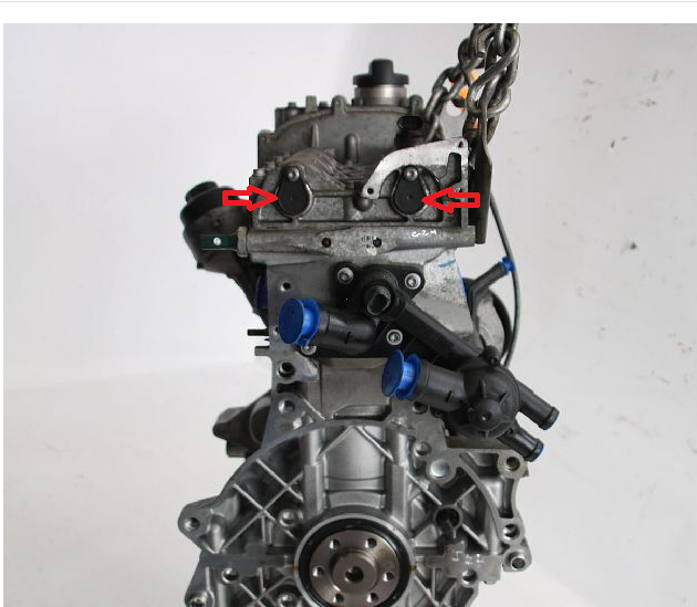

On the end of the engine nearest the battery there are a couple of removable covers that reveal some features on the end of the cams when opened. These features are slot-like and should be parallel to one another if all is well with the inter-cam chain timing. They are used to fit timing tools such as these into during chain work:
If they aren't at parallel angles, some slip has occurred, and you should probably get the garage to inspect for valve damage.
The covers to remove for inspection:
