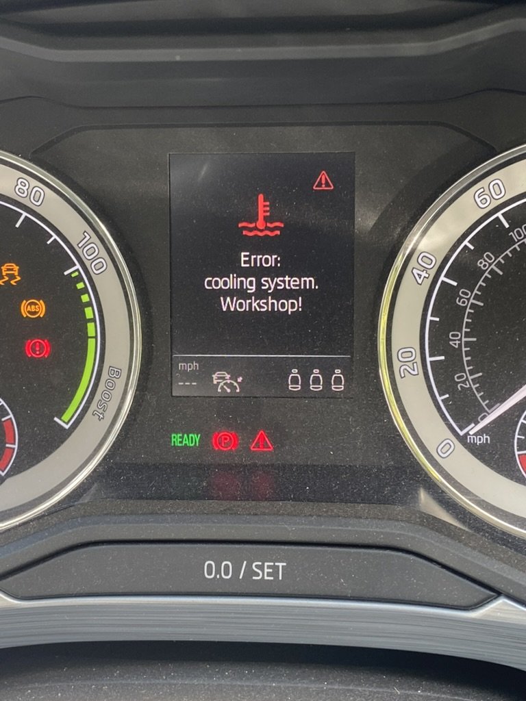

Just run into this issue with my second-hand SKODA SUPERB SE TECH IV PHEV S-A (2001).
Warning light came on:

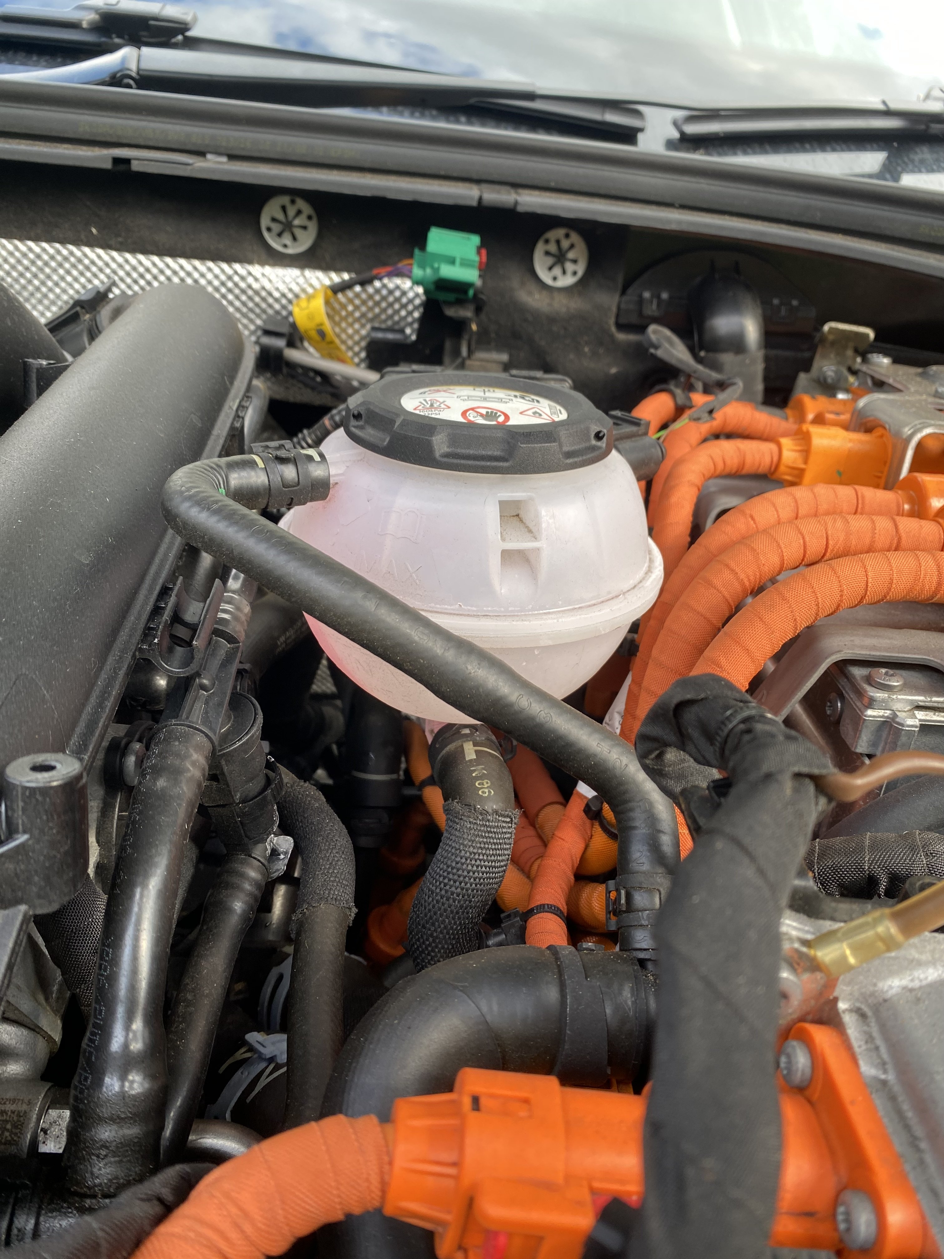

Checked coolant:
Interesting to see that there's no tamper seal on the coolant reservoir - should there be?
If so it could be indicative of a prior problem that the previous owner encountered.

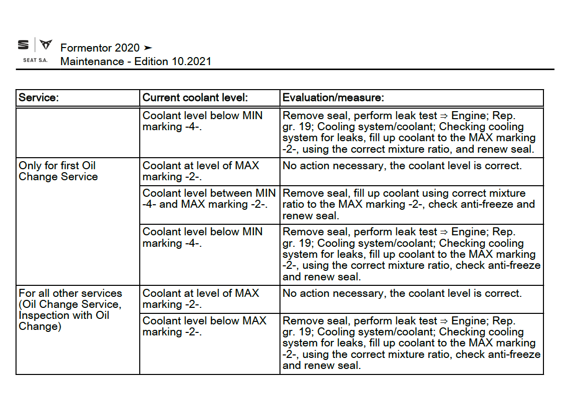

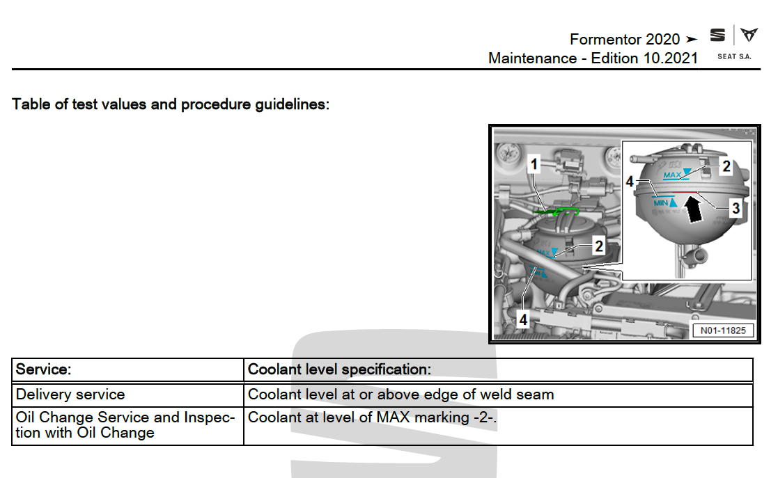

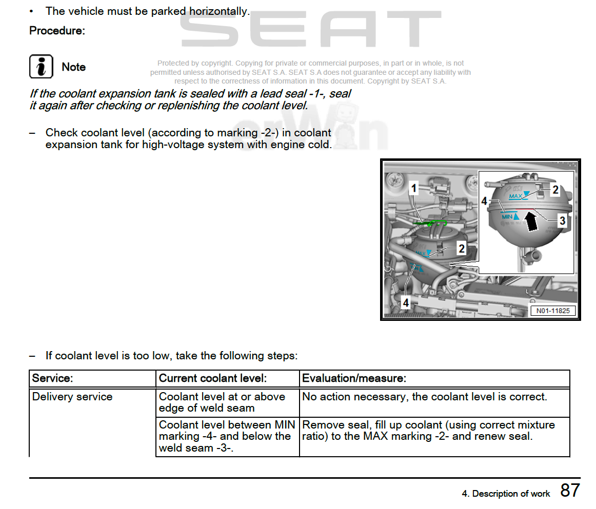

Annoyed by the fact that both fluids are low (one below min.) I dug a little further, and checked the Service Manual. The cooling system for the HV-system has a dedicated section obviously.
It seems that only for the Factory delivery it's ok for the coolant level to be at the weld seam. For ALL the following service checks the coolant level has to be brought up to the MAX marking:
This piece of info is in agreement with what I noticed since I got the car (new): the coolant level was at the edge of the weld seam. However, at the first oil change service they should have filled it up to MAX level, according to the Procedure in their Service Manual:
Besides that, what bothers me most, is that at the first oil change service that I had more than one month ago, the service sheet that I received clearly mentions that they checked the coolant level for the HV-system and the integrity of the seal...
However, the fact that the level is at the minimum for this one and 1 cm below min. for the ICE coolant is clearly indicating they didn't check a damn thing. The probability for both fluids getting so low since the oil-service is too small.

I had the "error: cooling system" "please visit workshop" message pop up last Saturday. I managed to get into the dealership today, and they confirmed the heating element has gone.
The car is 3 years and 6 months old. (Octavia estate IV 2021) So my warranty had run out.
£1350 to fix 🤢
