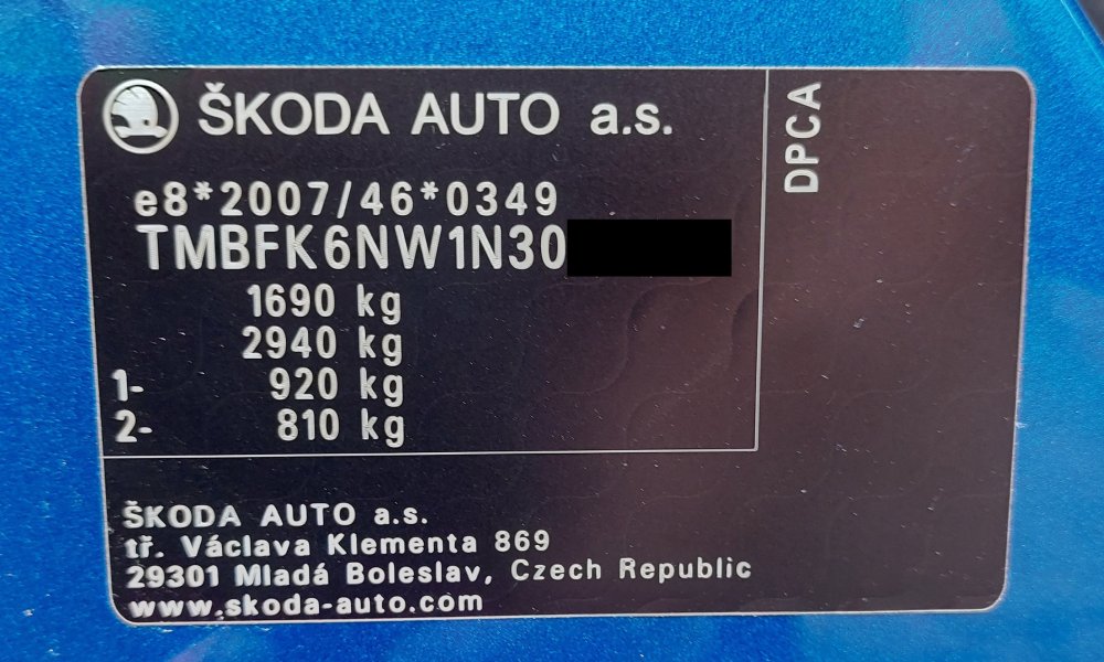

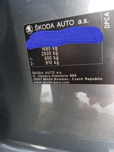

Yes, it came plated for towing - which is the odd thing. Apparently some cars arrive with (see pics attached) figures A & B the same, i.e. zero towing capacity. Has anyone on this forum got a VIN plate with zero towing capacity?
My car was definitely ordered without towbar prep. When the towbar was ordered they also ordered the prep kit and ran cables rear to front to connect to the back of the fusebox below and to the right of the steering column. Then once it was fitted they did the coding.
I didn't need to ask the replating question of the dealer because of the above, but my logic is that they should be able to replate a standard Scala because the towing prep is about some additional wiring and coding rather than anything structural. (On some bigger Skodas I believe there is additional oil cooling? Can't remember.)
I agree that zero towing capacity is an issue with insurance and legality. But I still struggle to comprehend the possibility that most second-hand towbarless Skodas on the market cannot be purchased by someone who wishes to tow something because they will never legally have towing capacity. I know that the brochure says "Please note, if a tow bar or tow bar preparation is not fitted on the car, the VIN plate may not show any towing weights and the car will never be eligible for towing. As such it may not be possible to retrospectively fit a tow bar if the car is not fitted with tow bar
preparation at Factory. Please speak to your Retailer to confirm the exact towing eligibility.", but has something been lost in translation? Because the dealer I spoke to doesn't agree with what is in the brochure.
