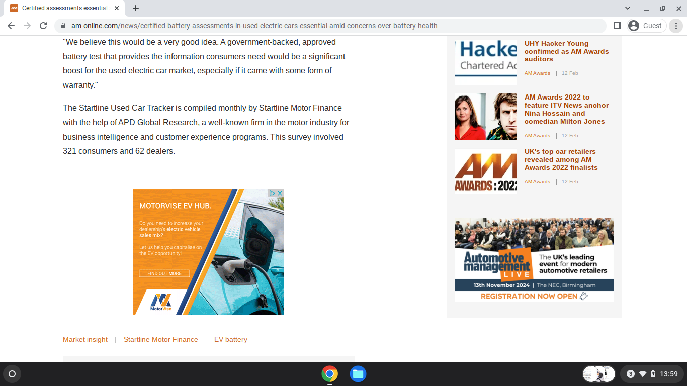

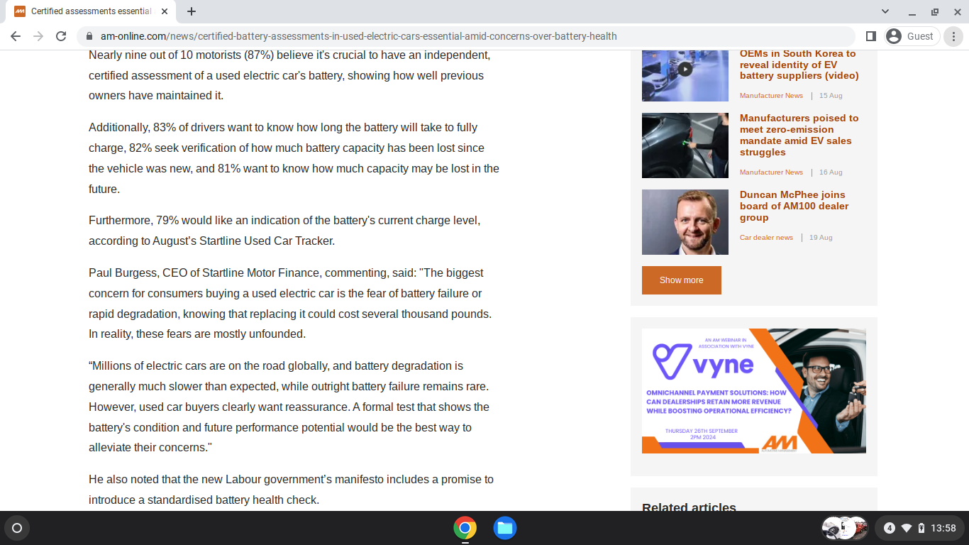

  • Less risky. Battery condition can be checked far easier than an engine in an ICE.   Most EV drivers are nor stupid and are not charging to 100% with ones they own, maybe not Rapid charg
  • Arm yourself with Leafspy or similar tool, plug it in and read the SoH value. Job done.   Just buy one with average miles, give or take. As long as it's being used most days, it wouldn't mat

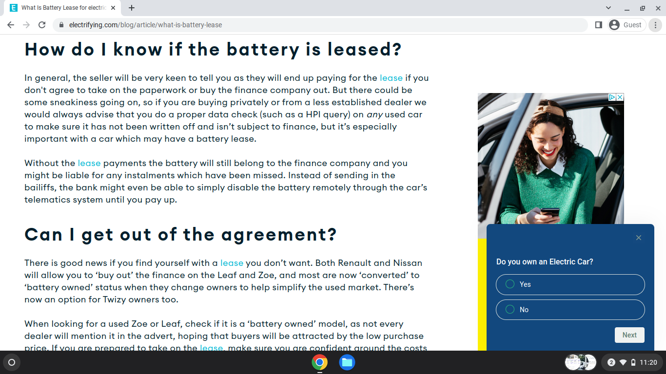

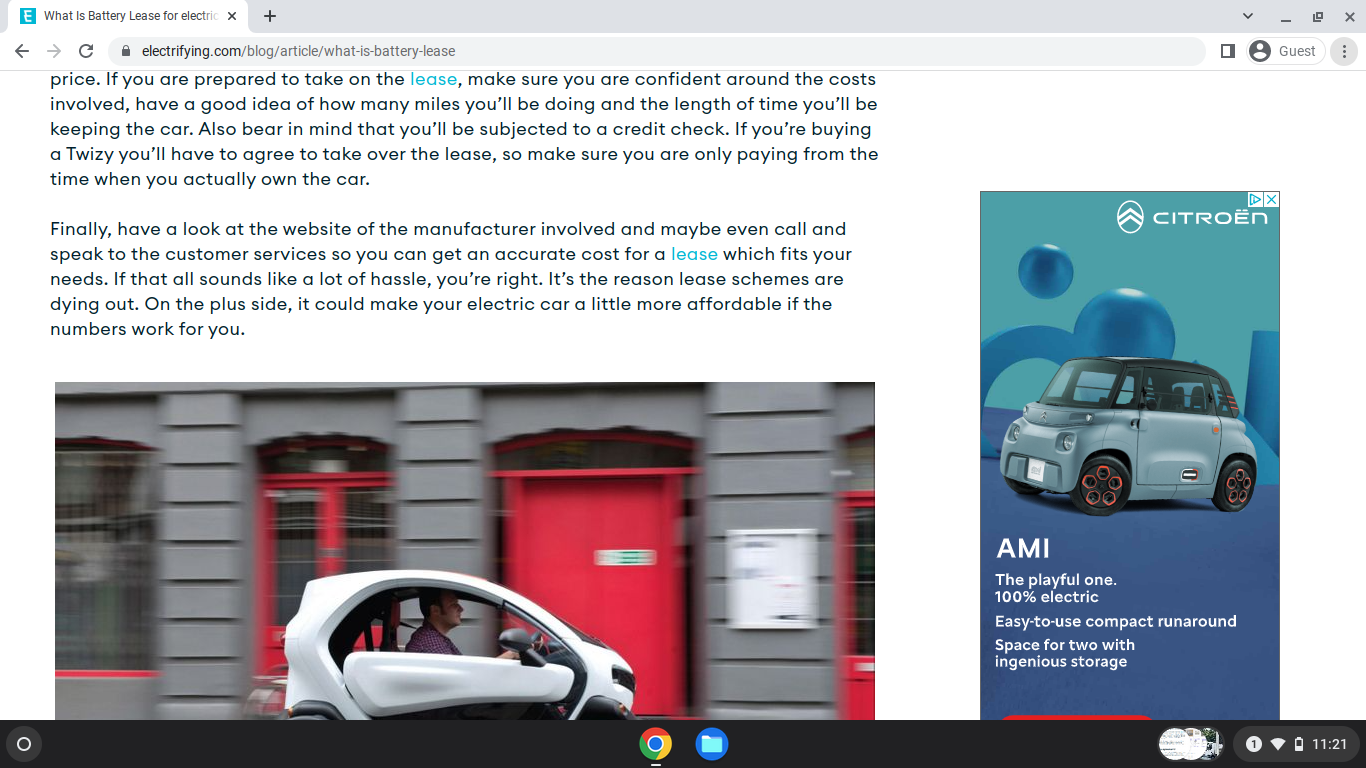

How am i to know there is a Battery Leased if Renault UK are not the Registered Keeper, or the person with the V5 & the car and they do not tell me they only own part of the car.
(Same thing if you buy an ICE vehicle that has a new engine and gearbox that the Registered Keeper got a loan to fit, or paid with a Credit Card and it has an  outstanding balance to pay.)
Are Renault UK going to try and get the car i am now the Registered Keeper of, are they taking me to a Court in the country i live in or keep the car in.
What legal redress have they against me, or even who i bought it from who also never knew there was a Leased Battery and never signed any agreement?
***There should be a Plate on the vehicle that is not easily removed, or a message that appears on the car when charging stating.
Battery owned by Renault UK. Lease payment agreement required or return battery to owner.  Return Postage paid..***
LOVE THE BIT ABOUT A BANK MAYBE BEING ABLE TO DISABLE THE BATTERY REMOTELY.
Is this a UK Bank & is this after some COURT JUDGEMENT or something issued by whoever?
Can Court Bailiffs in which ever country of the UK actually seize a vehicle because part of the vehicle is owned by A.N.Other and if the person requires the vehicle to earn a living can they even disable it?

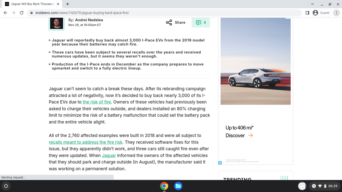

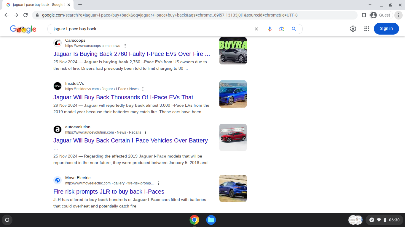

No Buying back of 2018 Jaguar I-Pace yet in Europe / EU.
As far as Germany and Porsche Taycan, what have Dekra to say about the many many recalls on early and not so early models of them.
