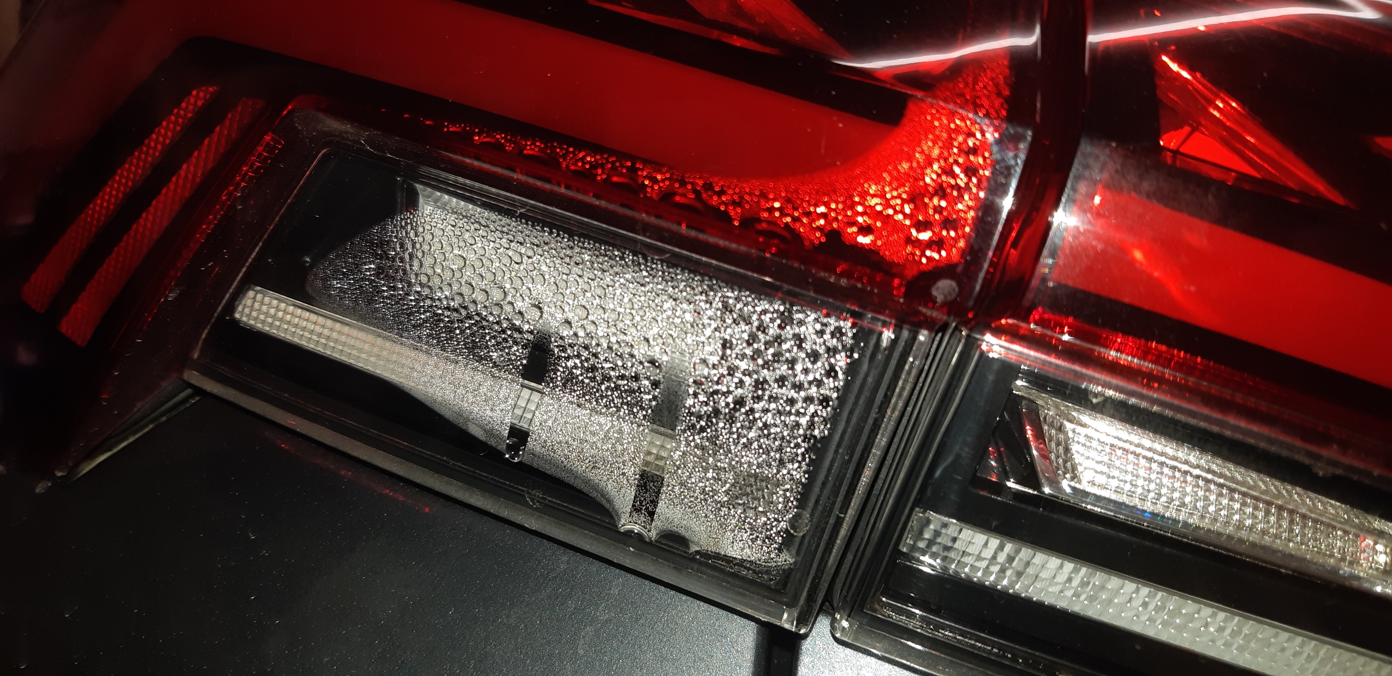

On 07/12/2022 at 10:18, luxdog said:
I've also got it in the rear lights...
they were changed for me

Do you have any picture showing the rear condensation that led to the replacement?

@Combi_NX5
Ouch! That looks nasty! Mine were only half of what you had, just the clear part (without the red section), but I only checked the next morning when it was already clear&nice weather outside...
