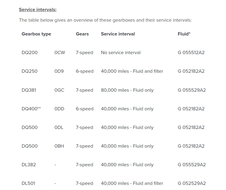

Not all DSG's need serviced at 40,000 miles, some are at 80,000 miles, and some not anytime.
So is the TDI a 1.6 or a 2.0 TDI?    (To know what DSG it has.)
You get Fixed Servicing, 9,400 miles / 372 days. or Variable / Flexible 24 months / 18,000-20,000 miles,  your might well be on Variable since it never showed as due in October.
Fixed Servicing shown below.  But not actually accurate.  Just General info.

So a DQ381 7 speed wet clutch and Skoda / VW are still saying at 80,000 miles.
That might change eventually if cars start having issues earlier and the owner has a 4 or 5 year warranty, or a Approved Used Car with a Warranty valid.
