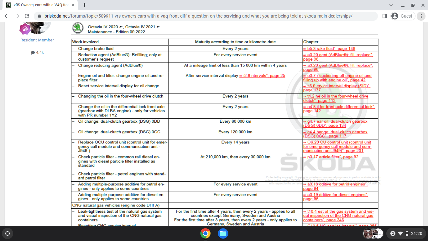

vRS Owners, cars with a VAQ front diff, a question on the servicing and what you are being told at Skoda Main Dealerships?
My local Skoda (and Cupra) dealer said it's not two years but three when dropping the VRS off for it's two year service.

Was that the Service Desk staff that told you or a Master Tech?
They should know, and if the car is not driven hard then best do what they recommend, just as long as the person understands that it is a VAQ and not  Haldex /4x4.

It was the service desk. I'll follow what they recommend as it will always be serviced there.

My Skoda dealer never mentioned it until I asked about it and they said oh yes every 2 years!
When they told me oil change only via top up/drain plugs, I took it to a VAG registered indy who removed pump , checked strainer and renewed “o” rings.

It definitely isn’t every 2 years in NZ. I want to say 45,000km but don’t quote me. I have the prepaid servicing for 5 years. It’s included in that but not in the 3 year one from memory

Officially, in the UK, it is 30,000 miles or 3 years - whatever arrives sooner.

It is officially @3:years / 30,000 miles in the UK for MK3 Octavia, but tuners like Awesome GTI they recommended 20,000 miles. MK4 Octavia are officially @2 years / 20,000 miles. I remember the thread that got a bit heated on the VAQ diff. I remember all threads I post in. But I think it was deleted because of abuse by a member and it was not me. It was a member that did not like this forum because we bullied him. Because we did not take what he said as being fact, because it was not.
