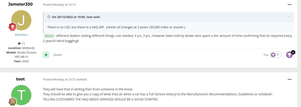

vRS Owners, cars with a VAQ front diff, a question on the servicing and what you are being told at Skoda Main Dealerships?
Are you being told the VAQ requires a Service @ 2 years or at 3 Years / 30,000 miles?
How much have you paid for the VAQ diff service or how much are you being quoted?
Reason for the question.
Different info from different sources but from people that should know.

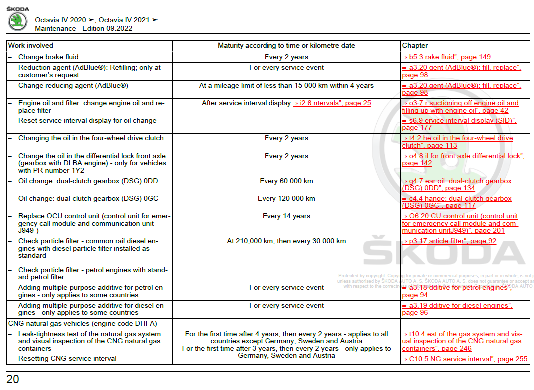

My car is 2 years and 1 week old with 42 000 km (26k miles). Had two services at 15k and 30k and I'm due to next one in 3k km. I can report in 2 months if they will change the oil or not at 45k km.
Diff oil change interval is 2years/60k km, which is faster. I have all service dates on o paper from skoda dealer
Table from dealer. In the left side of table is my numbers. Diff time exacly the same as dealer sayd

By dealer diff oil change is 60k km or 2 years. You can chamge sooner, but this numbers are talkink about car warranty this is red line to change . Sooner better but not later than 2years 60k dealer words... I dont know in other countrys, intervals may be different because for example for miles not km. But diff oil service are about interval change not between intervals
Edited by Lukasik
This is the recent maintence document for Octavia iV, and this is what it shows...
VW Group / Skoda are big on this 2 year interval stuff including the first brake fluid changes.

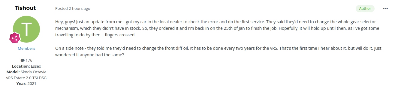

So went in for my first service at just over 15.5 k miles and 21 months old car. I have an issue with the gear selector lever of the DSG, so while the car is in, thought to have it serviced. After I left the car, they called me and said - "oh, it's recommended to change the brake fluid, but that's not covered in your service plan. Here's an invoice for 91 quid. Also, it's recommended to change the oil of the front diff (I only have 1 diff, but hey-ho) every 2 years - £120 (or something, can't remember, but will confirm), but we need to order the oil first, so we'll have to rebook you to come back." I'm like - erm, I booked the car for servicing more than a month ago. Surely you knew it needed oil change of the front diff... They said - well, every car is different, and blah-blah... anyways, so back in on the 25th for the gear lever mechanism change and diff oil change... At least they fixed some of the software issues I had, but took my engine cover away. After asking them if a replacement is coming, the answer was - nope, we just remove the old ones and throw them away... so much fun
Edited by Tishout
Typo
Fingers crossed. Someone here posted from NZ, I think, and they had a replacement. I'll chase the dealer like a lion, lol. Anyways, deviating from the VAQ topic....

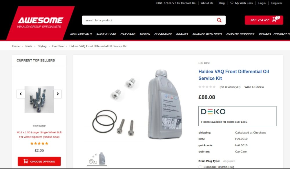

I am not yet there, I am planning to do this on the third year. All seems to be feasible, I did a check the other day and, besides the tricky position of the filling plug, not a complicated thing to do. In my case, I am stuck on the pump relearn. I have already checked basic setting on control module 32 ... but I do not have the option of pump motor. Somebody sorted it out?
Cheers
I just had mine done by the local dealer... they charged £128.60 for the oil, labour and 2 plugs.
Hi,
I can report that my VAQ diff oil was changed together with the regular service at 45 000 km and car being 2y 2m old. They charged me 69.30 EUR. They didn't change the brake fluid tough.

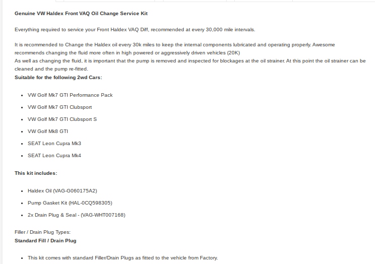

Hi guys ... for those who have already performed the VAQ diff service .. do you know If the pump was removed and filter cleaned?
I don't have this information. On the service report all it was written was "vaq diff oil change"
The same…
Thanks for the feedback guys ... I guess (Hope!) that I will find something between today and December.
