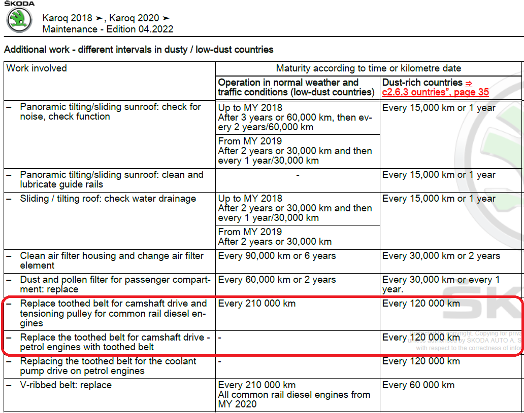

Here are the details for Cambelt change for up to MY 2020 (Manufacturer Year)  Note the document is dated 04.2022, so it's not an out of date file.
This is from the factory maintenance, now Skoda UK, Skoda Czech can recommend you do it at XX Km or Y Years, but that's to cover their ass basically.

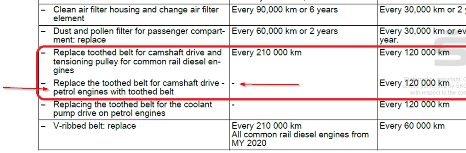

If I am reading that right.... In a "normal dust" country (e.g. the UK) it is saying " - " for changing he belt on a petrol car which implies it never needs to be changed.
Yes this is the conclusion we made regarding the 1.5 engine, it's in the engine manual too that this is a lifetime belt.
But the debate rages on due to being the internet, and Skoda UK (or other importers) cover their own ass by overruling the factory, or saying it is "recommended" and therefore spreading doubt.
Once they know more about 1.5 TSI ACT's at 6 or 7 years old that maybe do 5,000 miles a year or 25,000 miles a year in dust free countries they can revise their advice.

They can be obtained from erWin Skoda for an eye watering sum of 7 euro's, each year I buy Audi/VW/SEAT/Skoda manuals and download the lot to help others.
Make account, pay for 1hr access and have your VIN in a text file, then you can grab these things, and get a build sheet whilst there of your PR Codes that say what was fitted at factory.  If you have a PDF printer, then you can go into the TPI documents (Technical Product Information) and get a list of faults you can lookup regarding your motor, so if your gearbox was say only allowing you to select 1, 3 , 5 for example, then they would have something there if it's a known fault and the remedy.
I think myself I would change at 210,000km perhaps if you are nervous about it, so about 135,000 miles roughly (or again earlier if you wish) this is taking on the Diesel schedule.

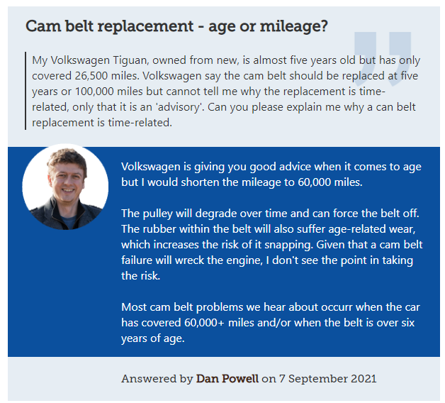

Honest John's take on this:
