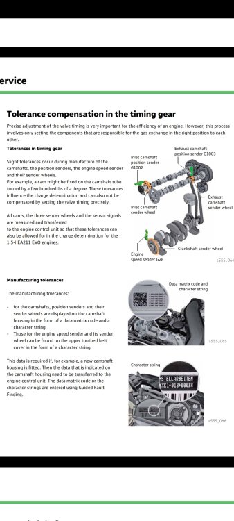

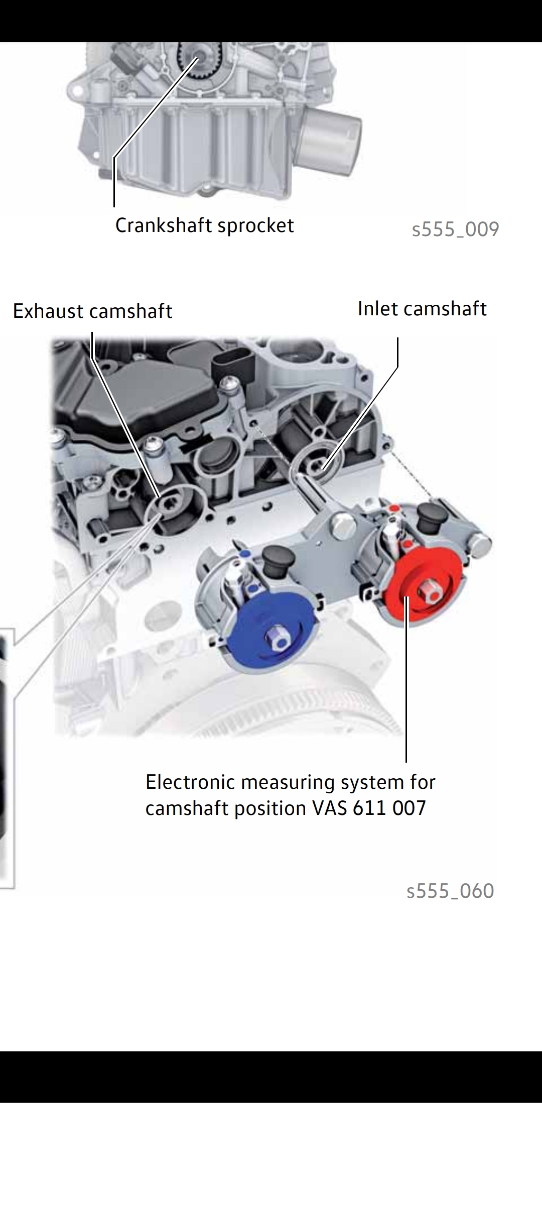

Not sure if this will help, but if you have this calibration printed on your engine, you will have the expensive cambelt change.
Look for this...
Screenshot_2023-01-25-20-10-19-400_com.google.android_apps.pdfviewer.thumb.jpg.3df339c6a69a3435eb7d2a28c9180040.jpg
VAS 611 007 Calibration tool needed
Screenshot_2023-01-25-20-10-47-939_com.google.android_apps.pdfviewer.thumb.jpg.46df000167dcafab077b5a5ab2cdb1d2.jpg

Lets be honest - the diagram above would not look out of place at a space centre - Car's should not really need to be akin to rocket science.  Too complicated for even the VAG mechanics to work on easily (as appears to be the case).

Thanks Varoom for taking the trouble to post those diagrams.  It explains exactly why a cam belt change is so costly as half the engine needs to be dismantled.
