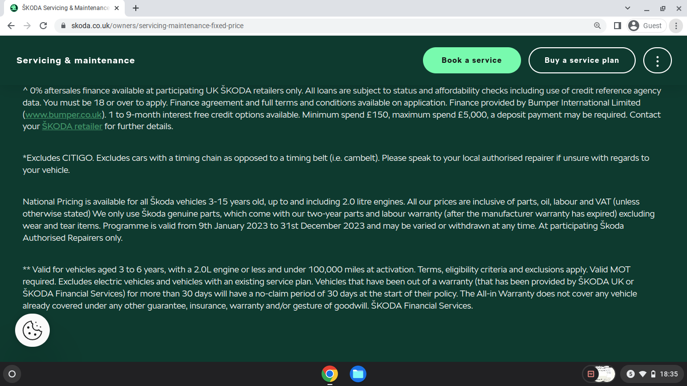

One main dealership quotes £539 for a cambelt change, but only for cars on fixed service intervals. They clearly don’t like the variable service regime that keeps cars out of the workshop.
Well everyone needs to earn a crust.
I was also mis-quoted a figure of £580 until I pointed out my car had ACT.  They then admitted their mistake and amended their quote to £1300.
@DriveucrazySomeone on a Service Desk or on the phone may not know about National Pricing on Servicing and Maintenance and the T&C's & are going by what it used to be on 3-10 year old cars and Fixed Servicing, @ participating dealers etc.
As to Cam Belt, Water Pump and other jobs it is 'Price on application' now and they might well quote wrong on that as well.
Some were clueless back in 2019, then it was all change in 2020 with Skoda UK and still they were all over the place with servicing and maintenance and prices.
So it changed from Minor or Interim and Major, and paying a price that was fixed even if parts were not supplied & fitted.
There are places that do a proper job for the money charged.  Just a pity they can not all do that.
http://briskoda.net/forums/topic/477630-major-service-costs
Edited by toot
No, published on their website and stating that Skoda publish the standard prices but dealerships can offer promotions etc
