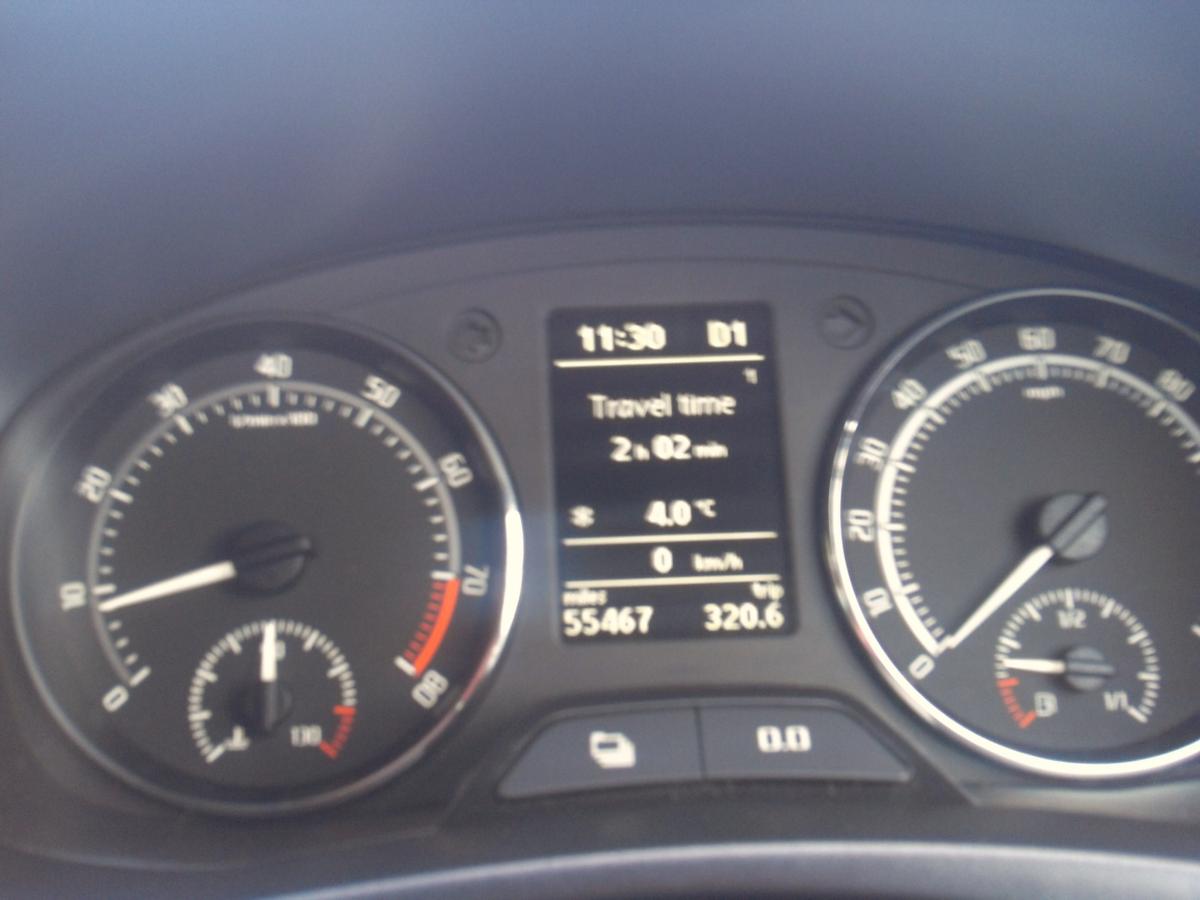

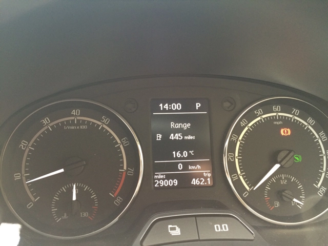

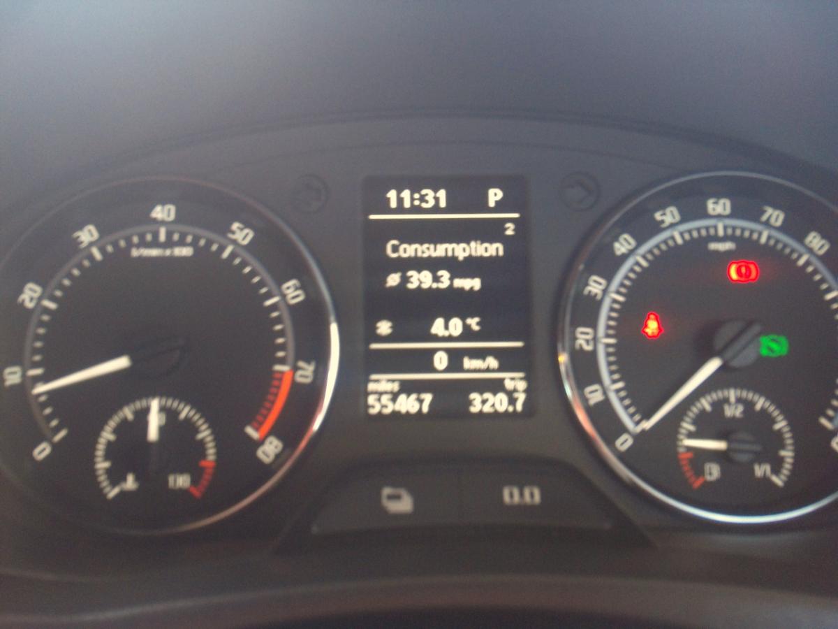

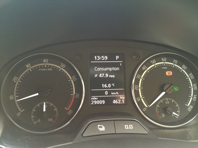

Looking at this again it idles at 650 RPM as @edbostan states
@toot Thanks, in drive remains at 650, S increases correctly to 1000 RPM

@Crucian
So is that foot on the brake and the DSG in D?
Because in N and parking brake on is different.
As is AC on.
But below 800 rpm means something is not right if foot on Brake Pedal and in D.
PS
@Edbostan has a 1.2 TSI.  He does not say if a DQ200 DSG, but even if it is the  where is the 650 rpm being read on an not accurate rev counter?
Cold weather hot engine foot on brake pedal, and just in P. Normal idle.

Checked and increases to 800 rpm in D with foot on brake
Being worrisome on my part I think
