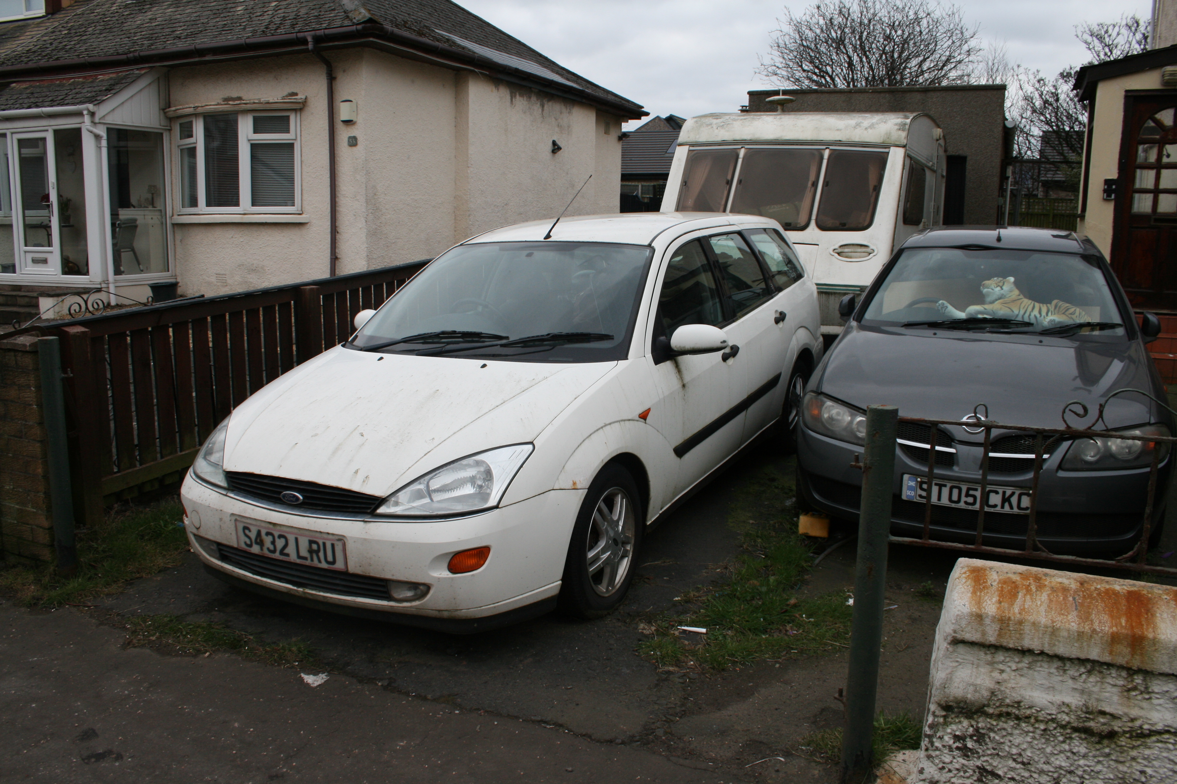

I wanted to jack it up. Access is fine at one side, but on the other the Almera is far too close so the car will lean and hit it. The driveway is a tight fit and you'd need to be a thinner man than I am to fit through the gap between the Almera and the Focus. :D
