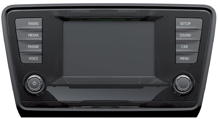

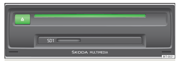

So my Infotainment looks like this, It's apparently the Bolero!
It only has one SD Card Clot and no 'NAV' function...
But all the versions of the upgrade unit I can find for sale, when they show "Requirements" All show a glovebox unit with 2x SD cards and the Screen has a 'Nav' button, I think it's the Columbus (or somthing)
So my question is, does anyone reckon it will work with my set up, or am I stuck just streaming music via Bluetooth, and relying on my phone screen for Navigation!?!?

it should work.
my guess is that the glove box unit has no influence. The unit just switches and takes advantage of the screen.
You should be good to go.
