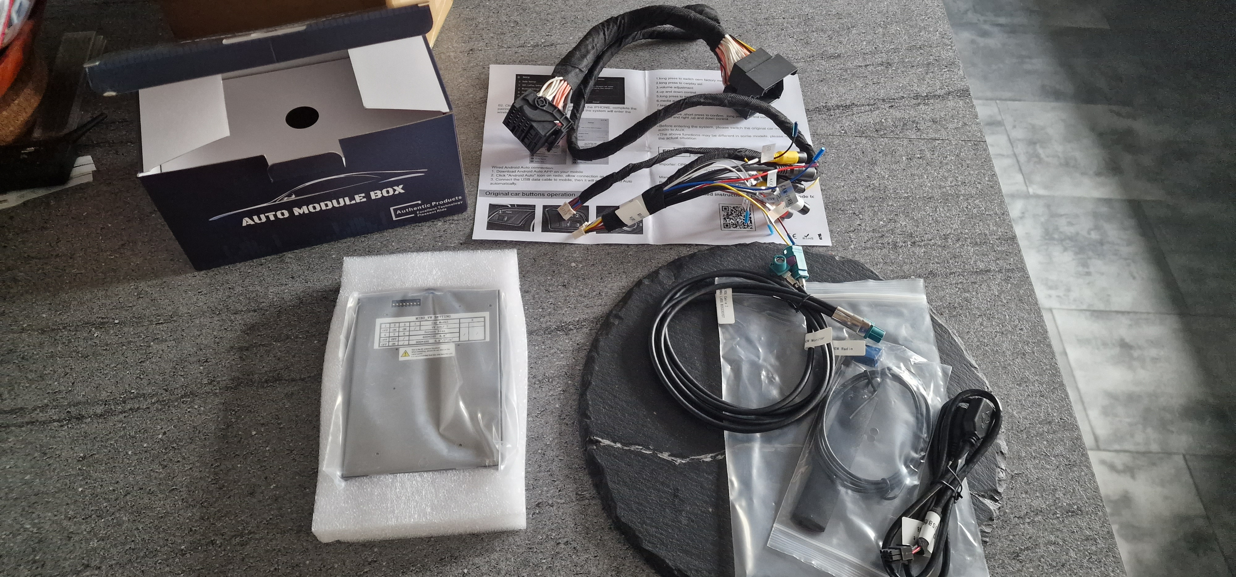

  • Arrived today, however car is in the garage having a replacement ECU so I will post back once I've installed and got it working...

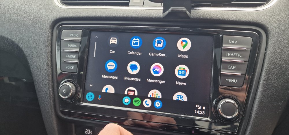

On 18/03/2023 at 16:58, Cactusjack said:
Installed and impressed, works well with the larger screen little to no lag present when working through the menus and apps.
Only problem is with my reverse camera... Can't connect it to the new MIB loom as has an RCA cable for connection and my camera has a small purple 5 or 6 pin connector. PDC still works fine however.
Hey, does the stock microphone work for you? Or do you need to connect an external microphone to the unit? Thanks for the info. :)
Stock works fine when it works... If that makes sense? Receiving calls and voice replies for messages are good, however if I'm making a call then it can take a while for the mic to connect even after the call is answered, so some people hang up on me... More bluetooth related than mic though that part I'm guessing!
