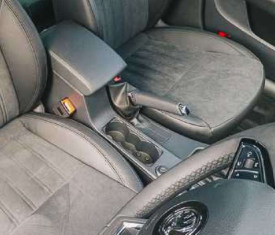

So we are now not talking Hand Brakes but e-Brakes as this is the Mk4 Octavia section.
There are PHEV's, Mild Hybrids, Petrol's and Diesels and DQ200's , DQ381's & DQ400-e,s and Auto Hold & Stop Start.  No manual parking brakes.
As to the foot on brake, good advice, if stopped a while and brake lights annoy those behind, weather conditions etc, use the parking brake.
If you go to the Fabia, Kamiq or Scala section you will find members with cars with a DSG & a manual hand brake.

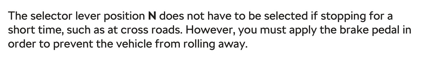

According to the manual:
"Stopping temporarily (e.g. at a junction): Leave the selected mode D/S and secure the vehicle with the brake pedal. (Also se autohold below)
Stopping: Keep the brake pedal depressed. Secure the vehicle with the parking brake.
Choose the P mode. Turn off the engine.
NB: When turning off the engine in mode D, S or R then mode P is automatically selected.
Autohold:
With Stop, the vehicle is automatically secured using Auto Hold. Auto Hold lights up in the instrument cluster. The brake pedal can be released.
With Start, the vehicle is automatically released using Auto Hold."
Seems simple enough. No need to complicate it. If following the manual would actually damage the car, I guess Skoda would be looking into some serious legal trouble.......

The term hand brake is kind of misleading when there are finger brakes / e- brakes as the Parking brakes and they do not even require releasing as that can happen by just pressing the accelerator if a gear is selected and the engine running.      As to the DSG,s being good enough for cheap cars.  Skoda are not known for cheap cars anymore. Ps North America, Australia and other non EU world regions can get the same models with 1.4tsi,s and 8 speed autos, but then they are showing genuine emissions and not WLTP kidology and engine management to suit testing rather than real world on roads.

But that is not what it says.
It says you don't have to select neutral if you're only stopping for a short time. It does not say that you should not select neutral if you're only stopping for a short time.
I'm not sure of the origin of the idea that putting a DSG in and out of neutral is somehow a problem, rather than leaving it in drive.
Personally, I prefer to sit at a set of lights in neutral with my feet relaxed, rather than wait there with my foot pressed on the brake.
If people want to sit at the lights with their foot on the brake, that's fine by me.
