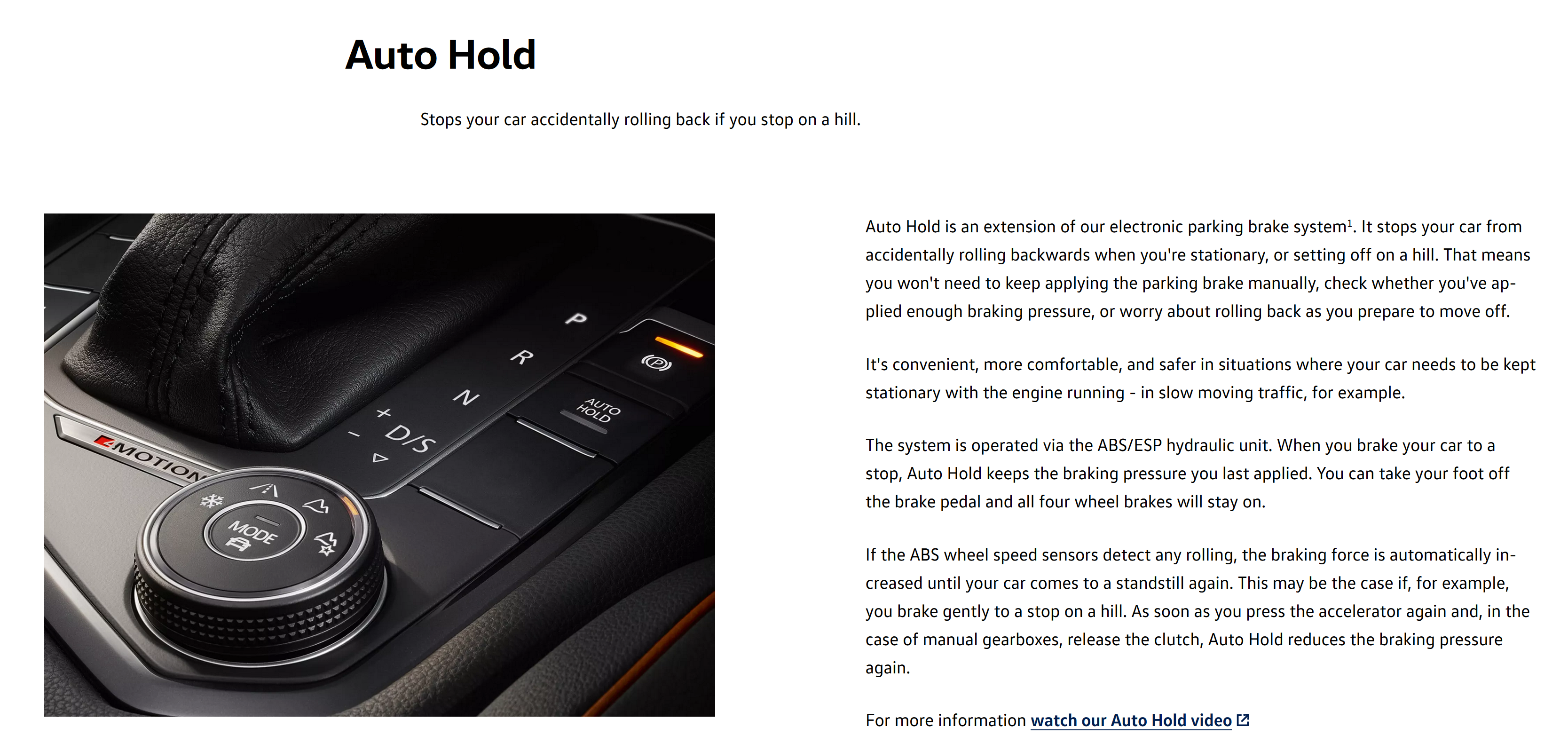

That said, it looks like AutoHold isn't related to the electronic handbrake, it's an ABS/ESP-based thing. So presumably it's technically possible to have a standard lever handbrake and AutoHold.
https://www.volkswagen.co.uk/en/technology/driver-assist/braking.html
Edited by EnterName
Added some VAG AutoHold info
