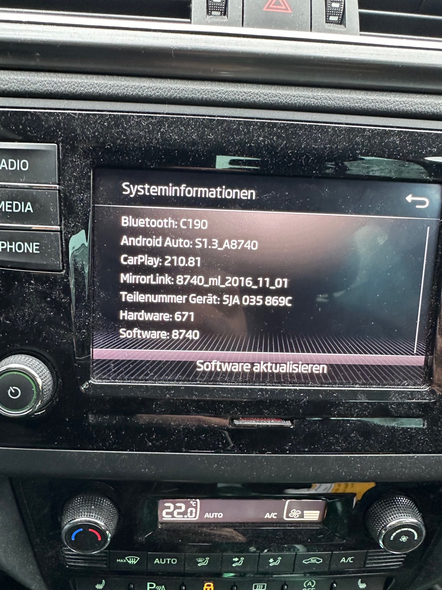

I own a 2019 skoda rapid with a swing radio, so hopefully I can do this update, too? Or is it impossible because of the old hardware?
I got the car without Smartlink functions and had to buy and install the license seperately.
Will I loose Smartlink/Carplay by upgrading to the new software version? If so, it would be a bad deal to solve the ausio issues but can´t use Carplay anymore 😉

Hi everyone,
I tried the upgrade and I it worked like a charm.
The process took less than 10 minutes and I got rid of the audio bug
it was neither a problem with the old hardware 671 nor with smartlink activated with an extra license
And it´s obviously not limited to a Fabia as it worked in my Rapid
Thanks again, you made my day
