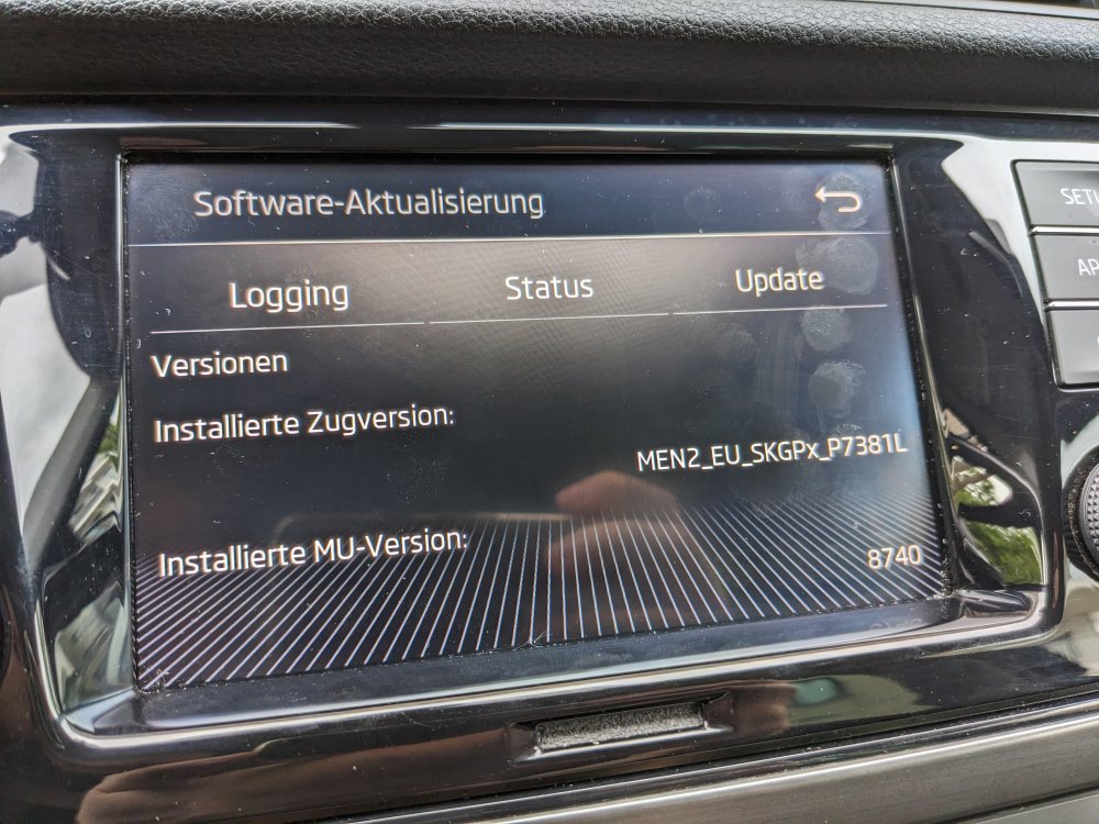

Hi, I am also having the same issue, seems to be quite a widespread thing.
Could someone please forward me the software update?
Currently installed versions: MEN2_EU_SKGPx _P7381L
8740
Thanks in advance
8740
Thanks in advance
Yes, I can send link to you

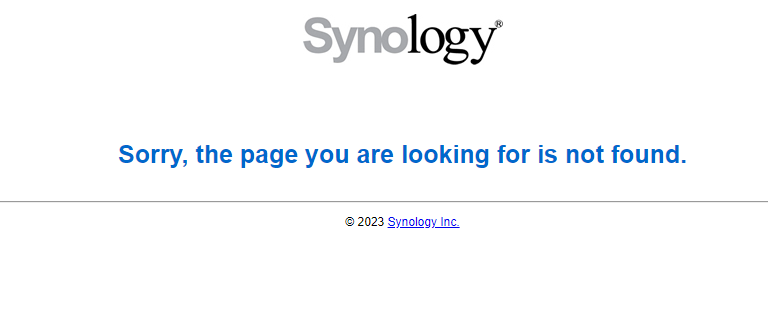

the link didn't work @varooom
hiya, i am UK, i have tried the link but i get an error message
3 minutes ago, Tdawber said:
hi
They expire after 24hrs is why you cannot get the file, I will make a fresh link.
