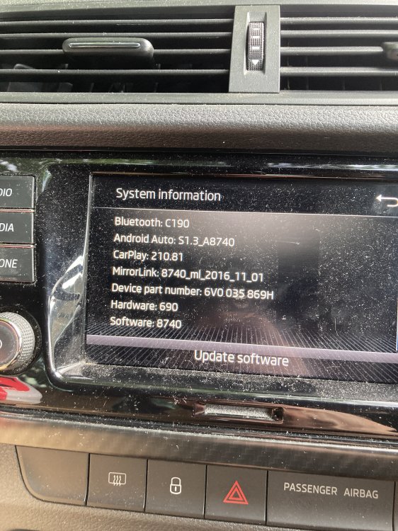

Have software version 8740. Happy to send email address via PM.
Thanks

I have managed to update the unit to 8755, however, during the process it showed a signature error and it didn't enable carplay (though it didn't have it before) anybody knows why is that?
Thanks in advance!
what car u got?
Skoda Rapid MY16 i have changed my original radio to the facelift version part no 5JA035871C
