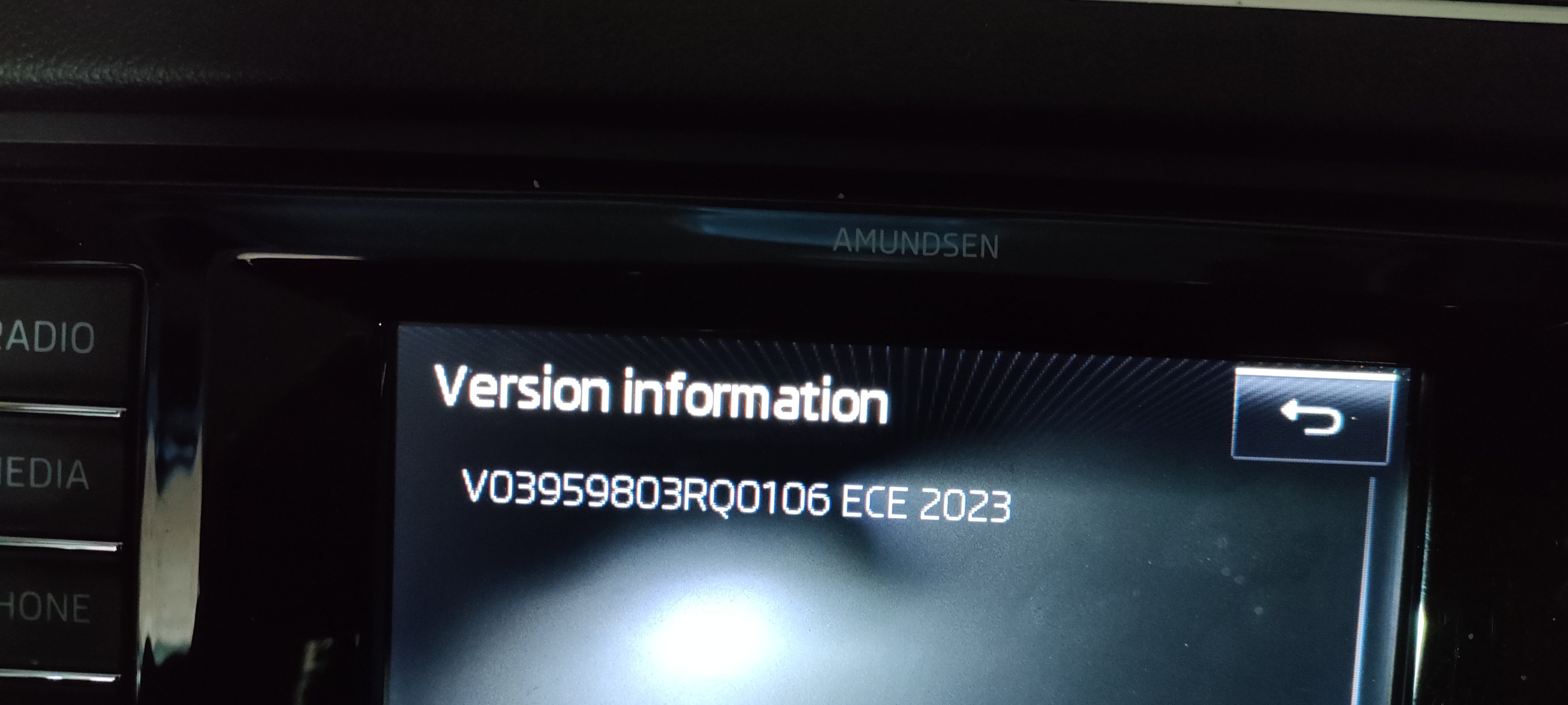

I've just done this update, so thank you for the above.
I just deleted the old info on the card and didn't format it. The file size was just a few MB too big so I just deleted a few countries I know I won't be driving in.
I didn't change any part numbers and it worked.
Attached is the current version. It does appear to be updated, but I forgot to take a pic of the old version.
Yes I've seen a picture with the A55 which was never in the original, with a finger pointing at it, by a satisfied person who got the down load working on Seat. They also went on a hacking session like you to get it to fit. Reckon that's the only difference with Skoda you don't have to do the part number edit. It was never sorted out 5 years by Seat people, with only 50% managing to update, then the world moved on to mib2 and the trail went dead. Nice to give them a boost with the maps more up-to-date.

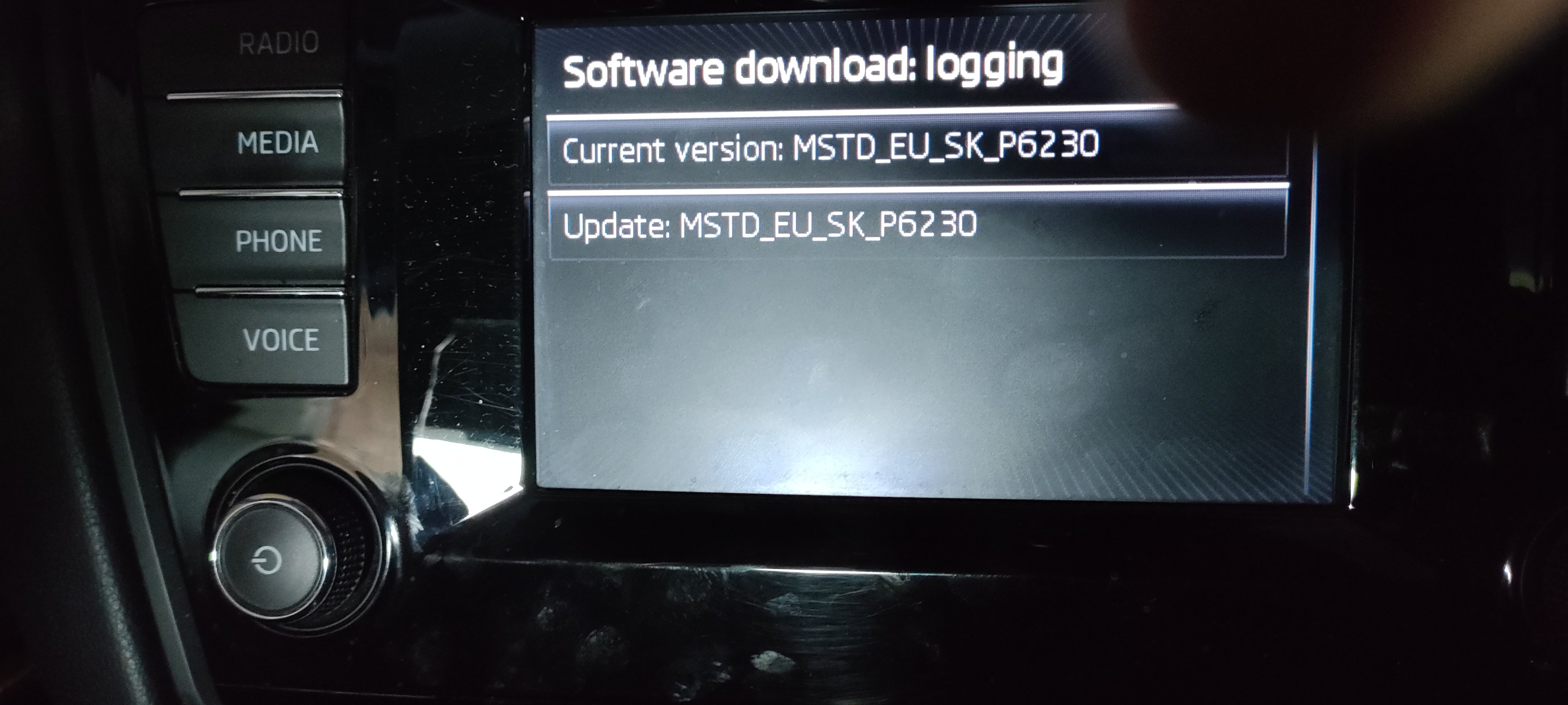

I´m from Germany and have a Skoda Octavia 1,8TSI  from 2013/14  with Amundsen MIB1.
I have just downloaded the P106_N60S3MIBS2_EU_NT (8V0060866S) and tried to copy the files onto my SD-Card.
They are not fitting on the card, because they are too big. I then deleted Iceland and the whole Russia Files and put the card in my car.
It says thes it sees new navigation data and the card contains the map data, but then it stucks while it says that the navigation data is beeing checked.
Then I reverted the card back to P94 and it worked again.
Then tried to replace the Germany Files of the P94 card with the ones that came with the P106.
Again I am stuck when it says naigation data is beeing checked...
What am I doing wrong ??

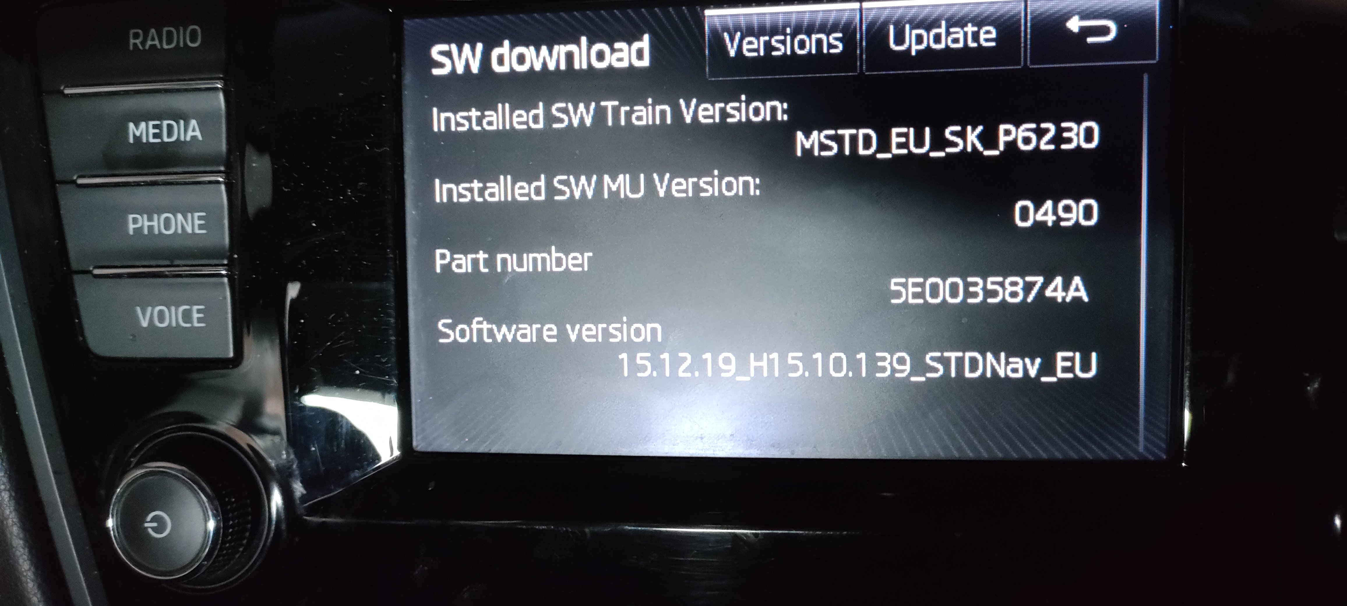

I have firmware version 490 on my Amundsen, with the help of this forum here, so this shouldn´t be an issue.
First I gonna try the workaround with the modified DBinfo.txt.. It is decent different between my original P94 and the downloaded P106.

All right. I just tested and it works.
-First I deleted all files on the 8GB SD-card.
-Then copied everything exept all of the "Russia" files onto the empty SD-card.
-This was the situation I had this morning, when it failes to start the navigation.
-Then I edited the DBInfo.txt and saved it on the card.
 -> DBInfo.txt delivered with P106_N60S3MIBS2_EU_NT (8V0060866S)
PartNumber1="V03959803RQ"
PartNumber="V03959803RQ"
ApplicationSoftwareVersionNumber="0106"
SystemName=" ECE 2023    "
to
-> DBInfo.txt edited by myself to fit my Skoda
PartNumber1="8V0060866M "
PartNumber2="5G0919866BD"
PartNumber3="V03959807NT"
PartNumber4="5F0060884CJ"
PartNumber="8V0060866M "
-Saved the new DBInfo.txt put it in the car and it was perfect.
This is the solution which works well for my Skoda with Amundsen MIB1 Firmware 0490 and VW Navigation AT card.

Where did you find the Part number 1, 2, 3, 4? Why did you change "part number 1" e "part number" and you set 5 different part number?
See above and you'll find another link via that
Resource of Seat and Mib1 and Mib2
https://www.seatcupra.net/forums/resources/updating-the-inbuilt-mib2-satnav-mib2-tricks-and-mib1.60/
It's just a file in the map directory. Pretty standard. Main thing don't delete your map card without taking a copy. Best to invest in an eBay mib2 card and use that, than try to hack down to fit on your existing map card. Some do... best to splash the cash for added security. Long press on the on /off on to get a reboot when changing map cards else it remembers the old stuff
Mibsolution.one web site also recommends using a file manager for the download.
1 minute ago, Tell said:
Guarda sopra e troverai un altro link tramite quello
Risorsa di Seat e Mib1 e Mib2
È solo un file nella directory della mappa. Abbastanza standard. La cosa principale è non eliminare la tua scheda mappa senza averne fatta una copia. Meglio investire in una scheda mib2 di eBay e usarla, piuttosto che cercare di hackerarla per adattarla alla tua scheda mappa esistente. Alcuni lo fanno... meglio spendere soldi per una maggiore sicurezza. Premi a lungo su on/off per ottenere un riavvio quando cambi le schede mappa, altrimenti ricorda le cose vecchie
Anche il sito web Mibsolution.one consiglia di utilizzare un file manager per il download.
Unfortunately I deleted the sd card before making a backup and now I don't know what the part number was anymore
Hmm I don't know why people do this... one keeps saying don't delete it. If it's like a mib2 card, printed in small print on the card is the release. If you post that up / a picture you are better placed. Then ask someone for the details. Have fished out people with this issue where you just replace it with a copy of the one lost and start the process again.
This is the picture of the skoda sd card. Maybe the number is on it?
