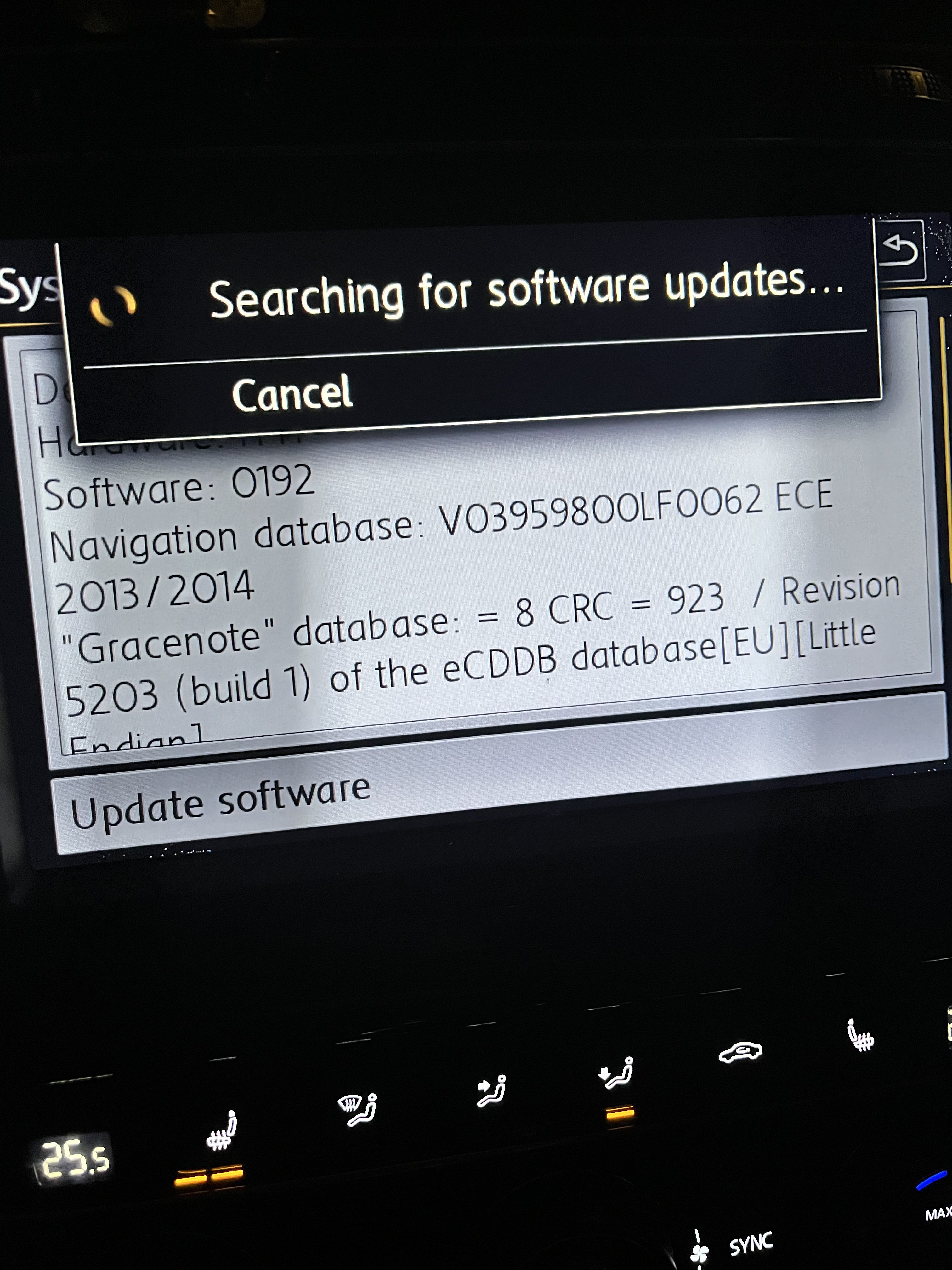

Could you also send the file to me? Thank you in advance. My current one is below version and I have no sound problem.
MHIG_EU_VW_P0344

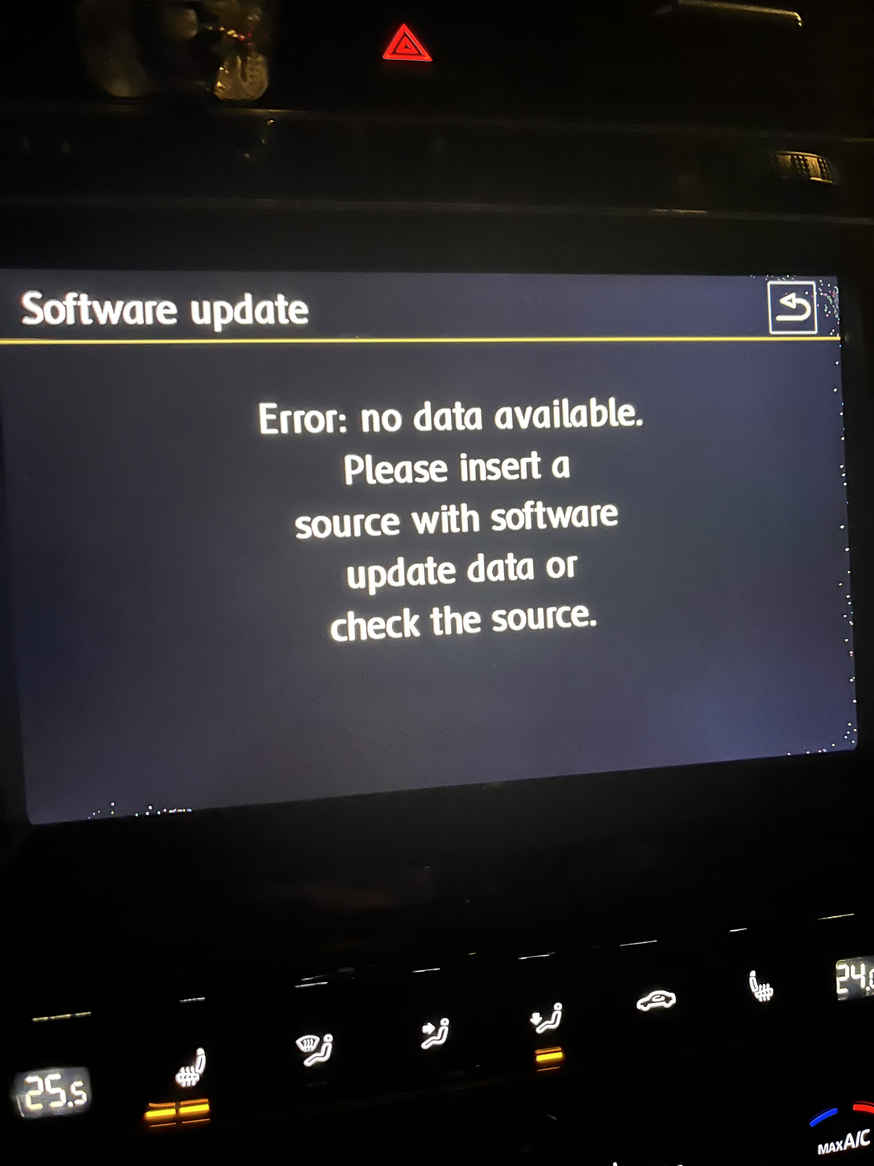

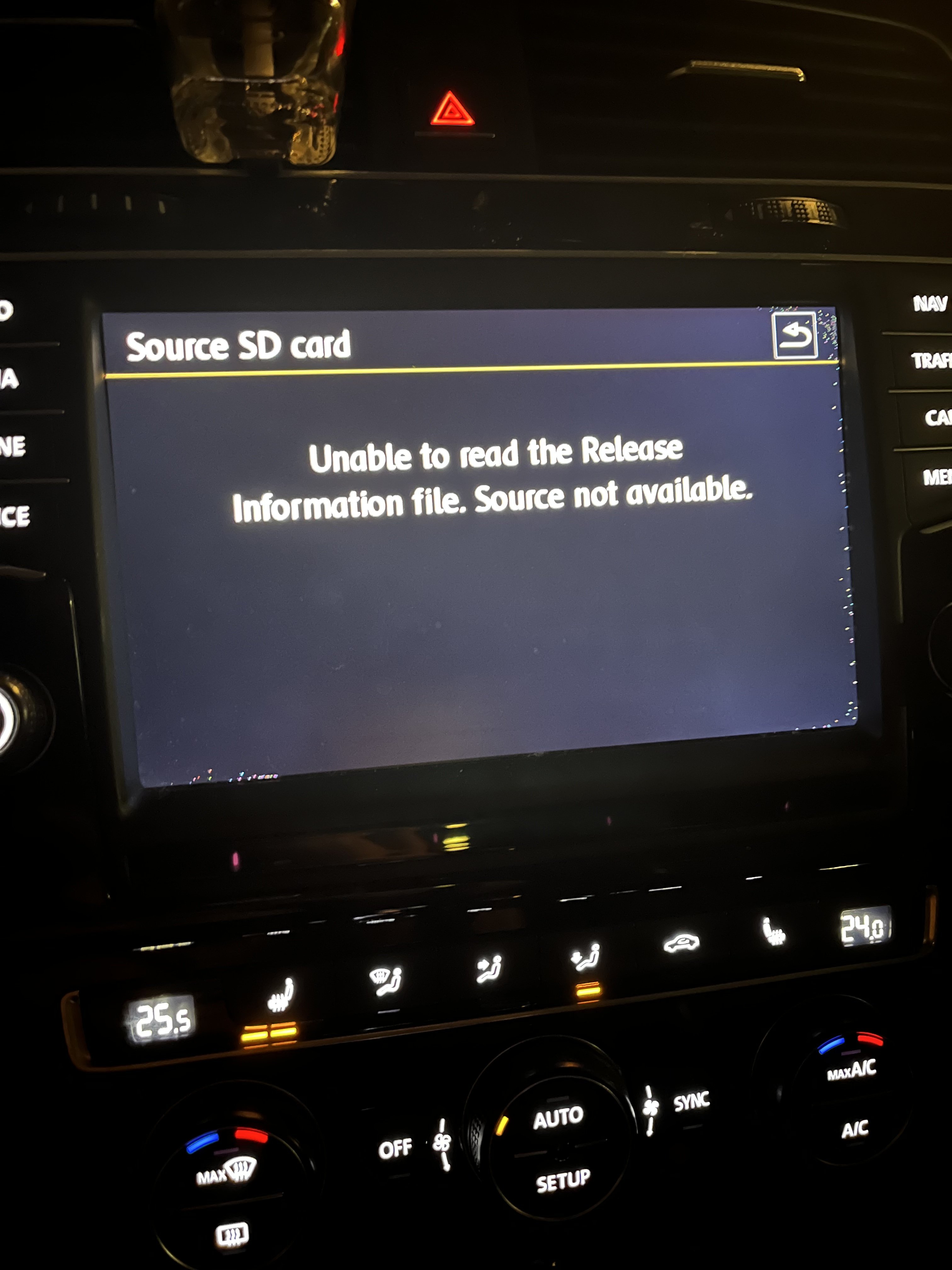

I found the file downloaded to sd card (non original one as I lost the original card) but failed. Anyone has any idea? Thank you very much in advance.
I was able to update. However there is still no sound. Any idea what oher causes might be?

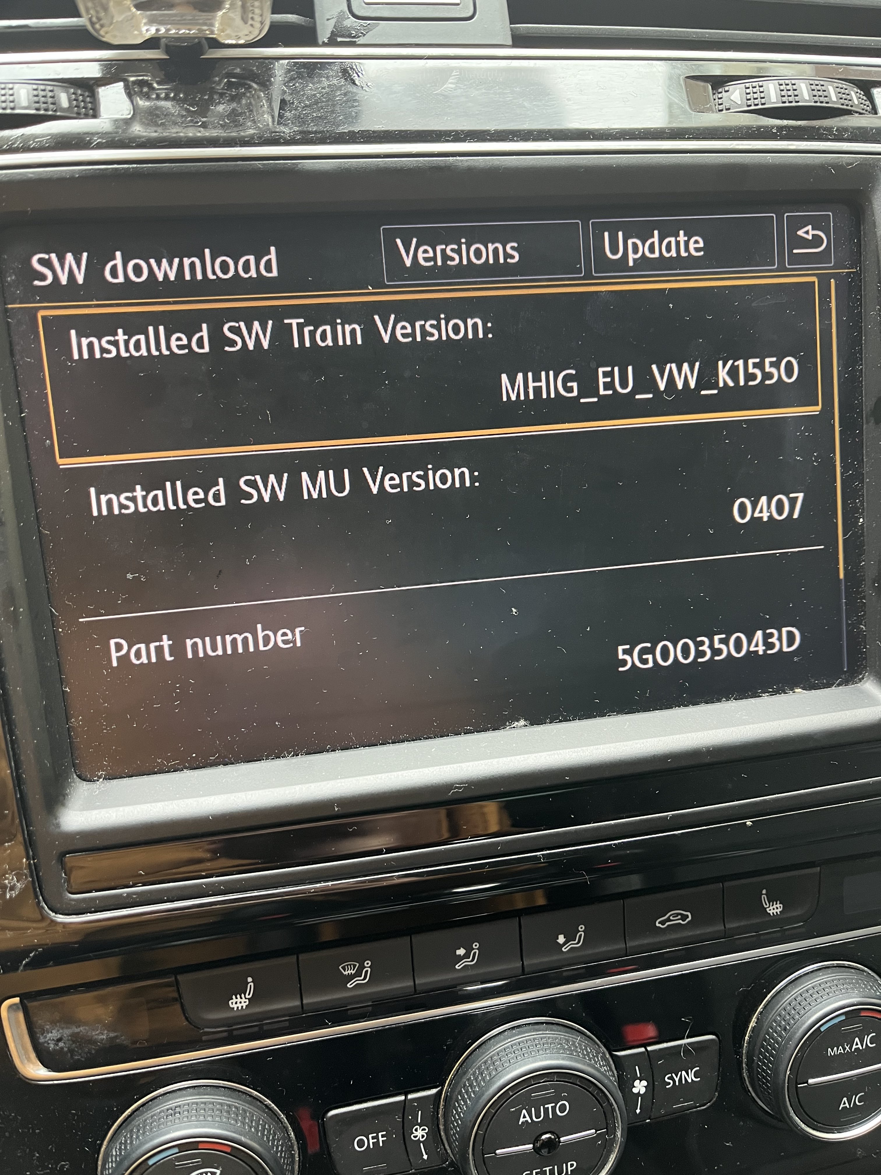

Hi,
Same thing for me on my Golf MK7 GTD from 2014 having random sound issues and woulf like to try a firmware update before
proceding to HW replacement. However as many of us already experienced, i am having a pretty hard time finding SW_MHIG_EU_VW_K1550_0407 firmware.
Device Ref : 5G0035043J
Hardware : H42
Software : 0290
Huge thank you for your help !
