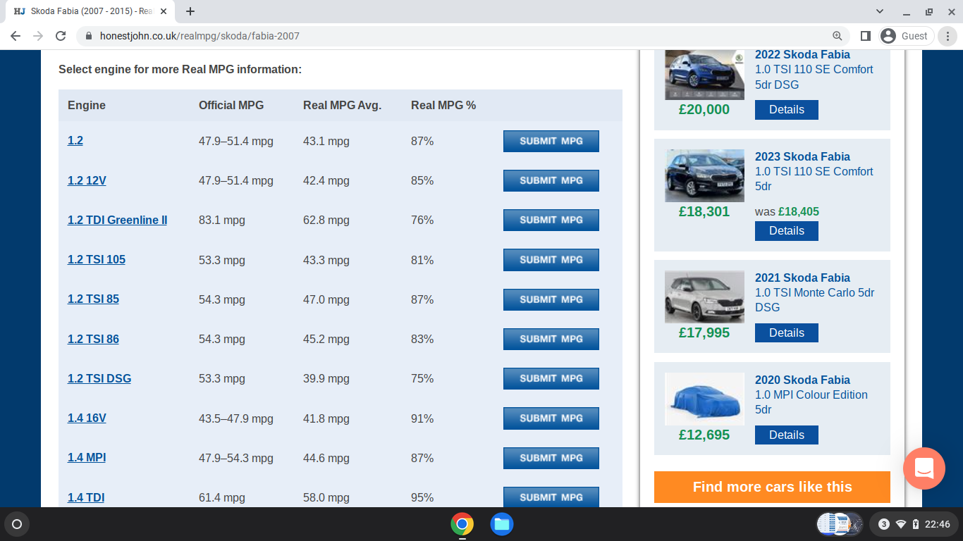

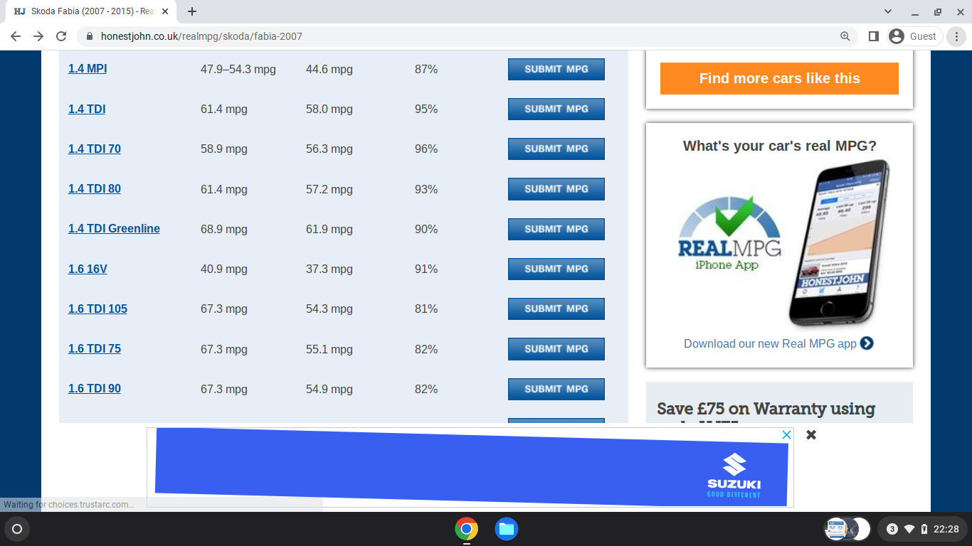

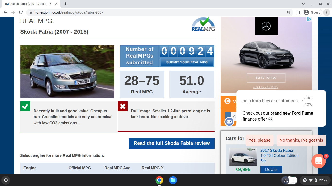

1.4 MPI's might be as low as 30 mpg with cold start short journeys, and cars might even be getting just 25 mpg.
45 litres used & just around 247 miles maybe.
40 litres @ 25 mpg 220.

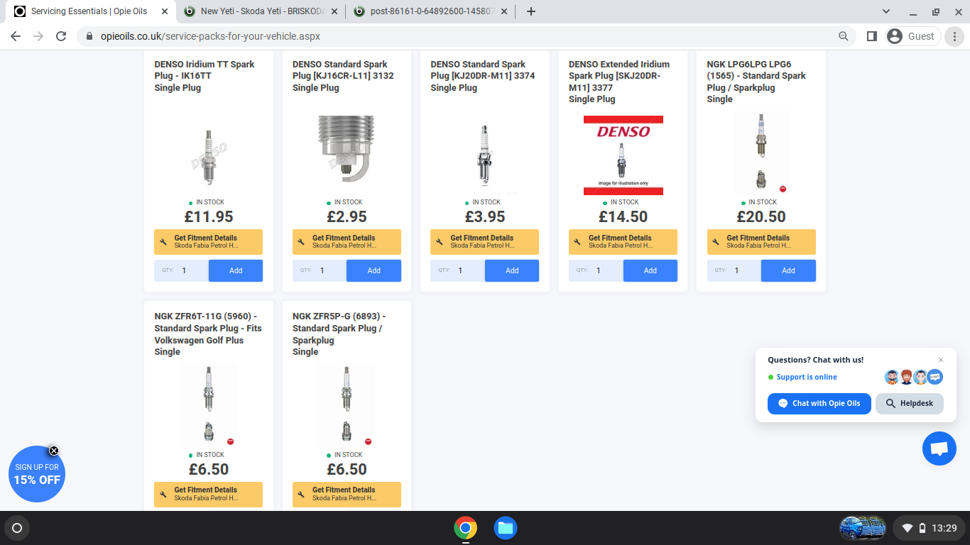

Is it worth me just replacing the 3 plugs as it's not expensive?
Well worth it if they were not done at the 'Full Service' 1 year ago, and they have not been looked at.
Brilliant will pick some up now, the service was done by a family mechanic, he passes back all the old materials so I know fuel/oil/air filter, oil and coolant was done but sparkplugs were left.
