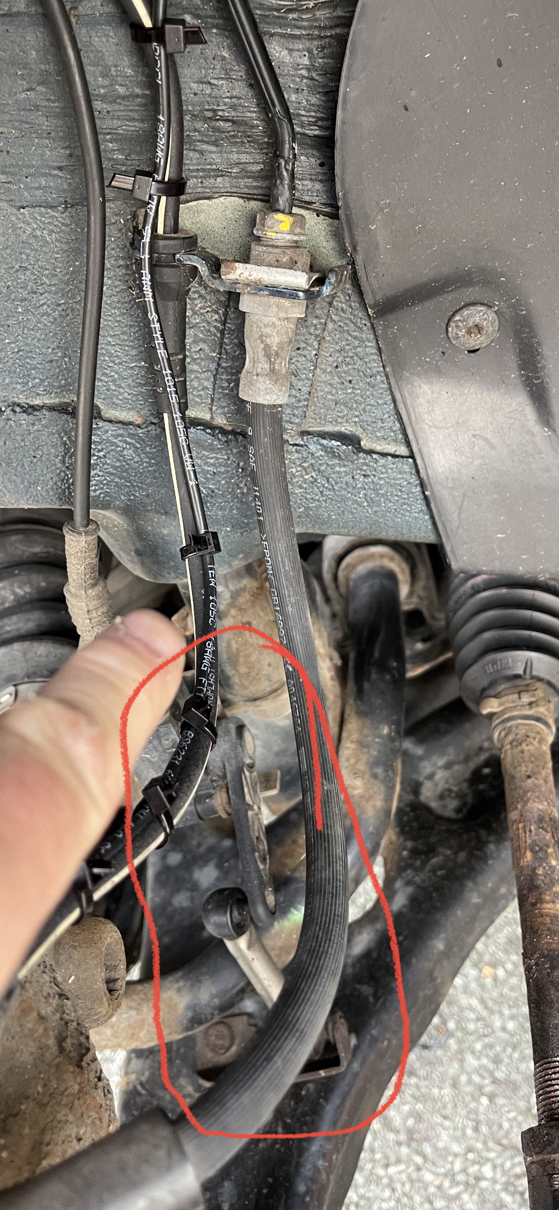

Mines got a sensor on front passenger side
it’s like a levelling switch with connecting rod on
it’s maybe became disconnected when they’ve change the springs.
no idea what it’s for
Edited by Snapper1725
That's the ride height sensor - needed for the headlights to adjust the level correctly.
So that could be his cause of his headlights been wrong then if it became disconnected.
