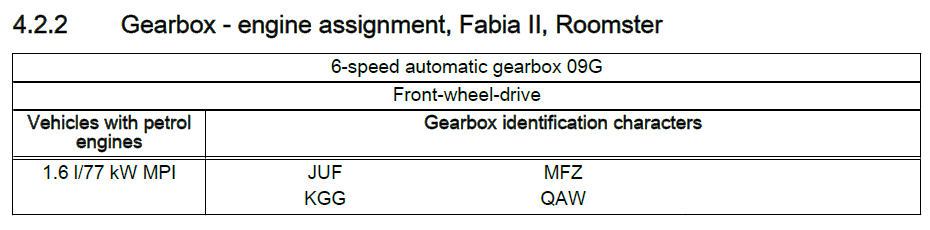

Yes my engine code is BTS 👍  learnt something new already today 😂😂
Do you know what TRANS. CODE "JUF" means? - and does the gearbox ever need a oil change/service?
Thanks again

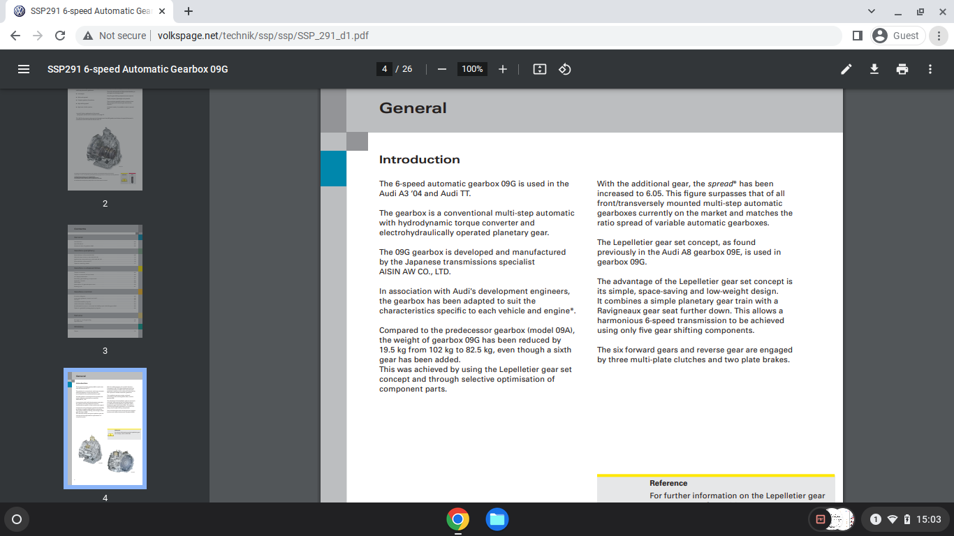

You have an 09G 6-speed automatic box

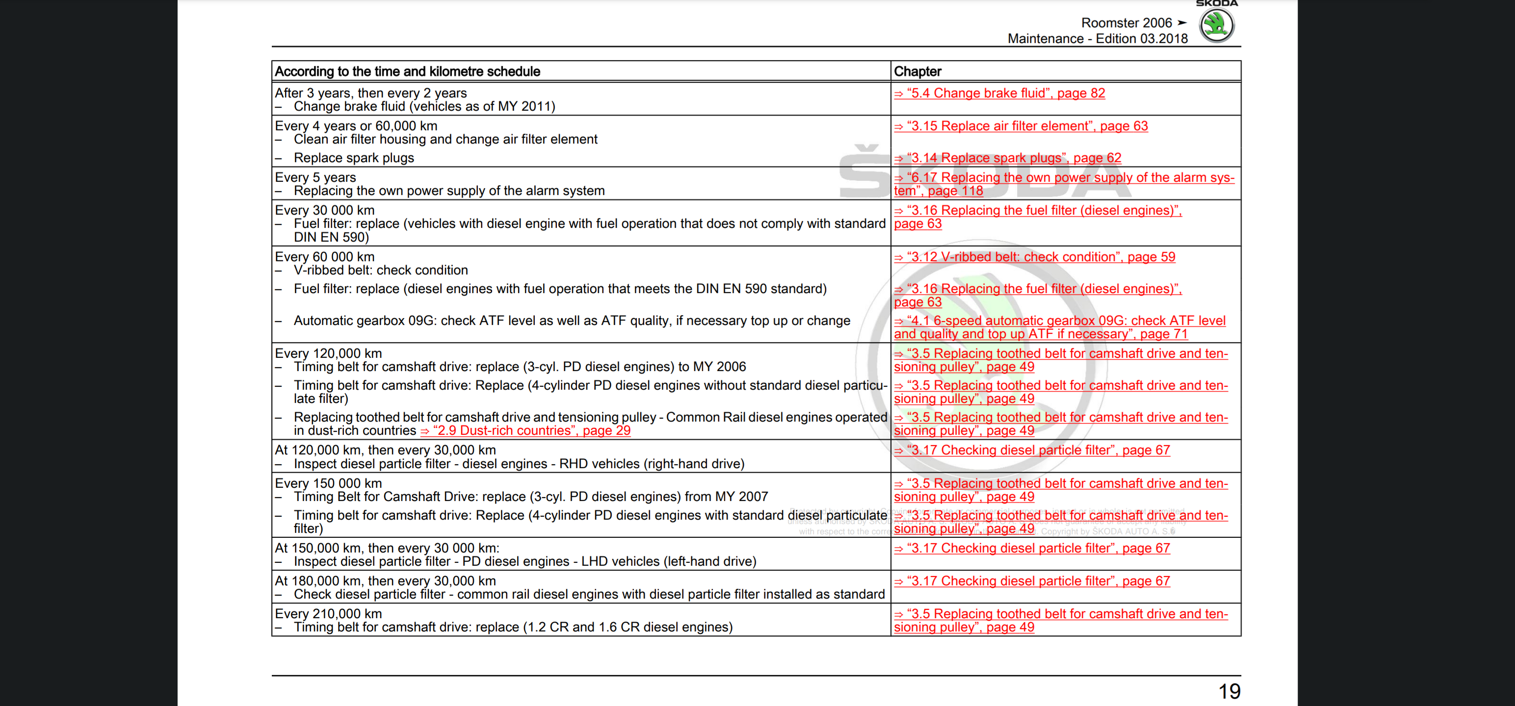

All I could see in maintenance is to check the levels of ATF fluid every 60,000km (40,000 miles roughly speaking)
No mention of a change in fluid being needed.
@toot Has all the charts for such changes, and will hopefully see the post now and let us know if there is a fluid change schedule I missed.

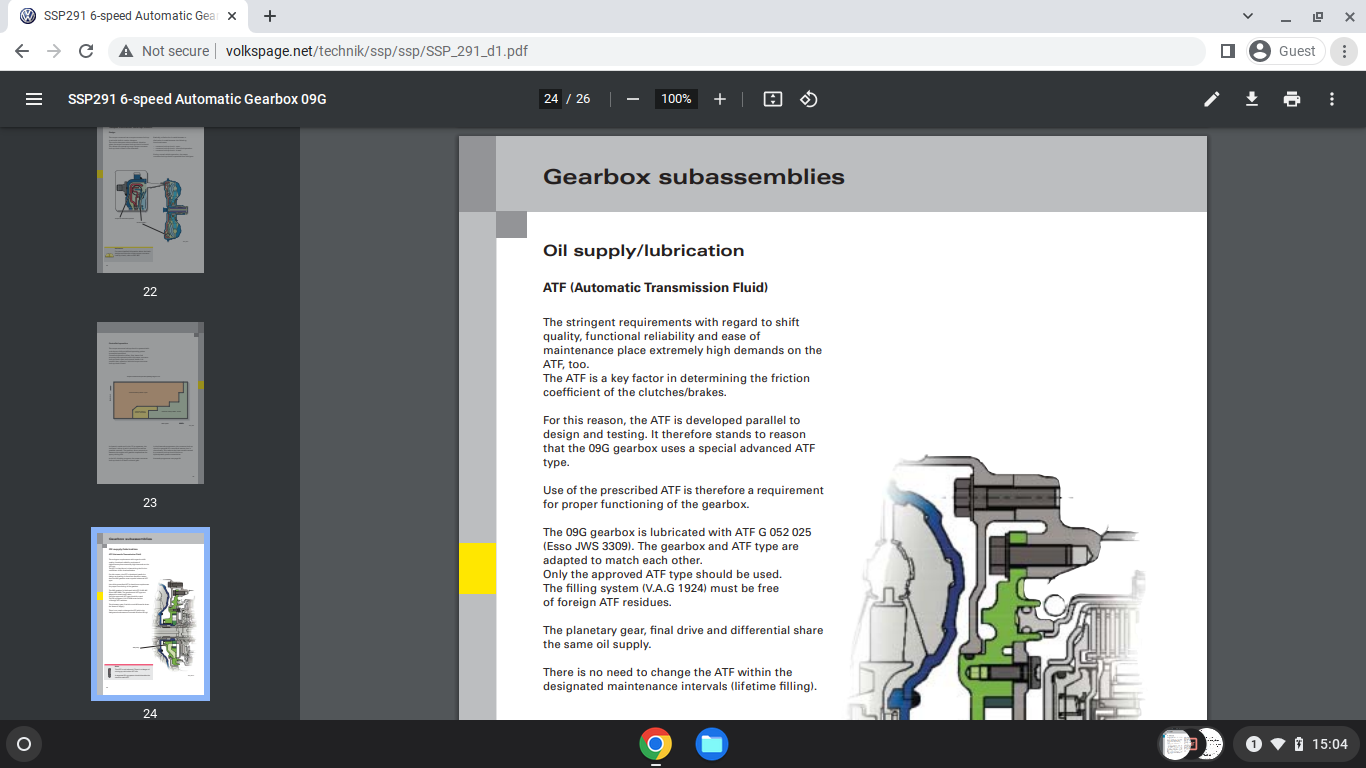

It is a Tiptronic gearbox and as far as i knew even after 8 years of them being introduced & ones over 100,000 miles there was no Service Schedule for checks or guidelines or recommendations.
It is interesting and helpful that @varooomhas found that.    It would be good to know what date that was published / available.
Here you are, it does state check level and quality, so might be a good idea to possibly change for peace of mind.
Edition 03.2018
