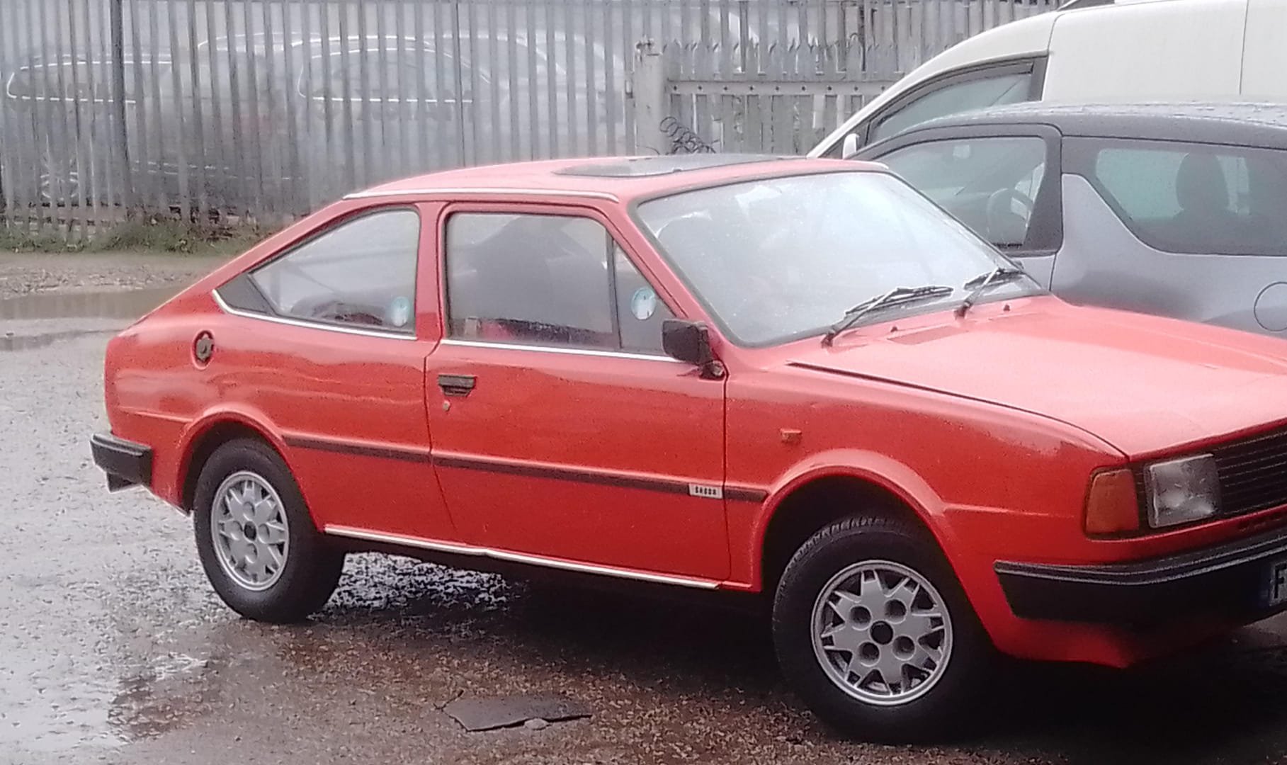

Finally pulled my finger out and finished (well started and finished really) the restoration on my Estelle. Its been a long time coming.
Took it to a local car show on Sunday and got lots of really positive feedback - many stories from people who had one, or whos parents had one (with the associated micky taking etc).
I have a few more jobs to do. Highest on the list at the moment is to sort the interior. The front seats are pretty bad (fitted some cheap seat covers) and the rear seats were completely gone (so not currently fitted). I had a few ideas, but the rear seat issue was a problem - couldn't buy aftermarket rear seats. I have managed to find a Mk1 Fabia VRS interior which should be turning up in a week or so which I am going to try and modify to fit. If I can make it work it should be pretty cool with the VRS logos on them (in cream and black).

Nice, particularly with the 4 door 2 seater look. :)

My Skoda Estelle Rapid ... Owned Brand New from dealership in 1988... I do require help & assistance from group members on a few items I need to keep car on the road.
The car works beautifully with only 30,000 miles from new but alas I need to source the odd item 😬

Red too, well done on keeping the colour.

Rowan Red 😜😏✌️😉 ...it was my first car ... The first car is like > first love, first cut is the deepest 🚘

Depends what car it was.  Yours was a great fun car and practical too.
