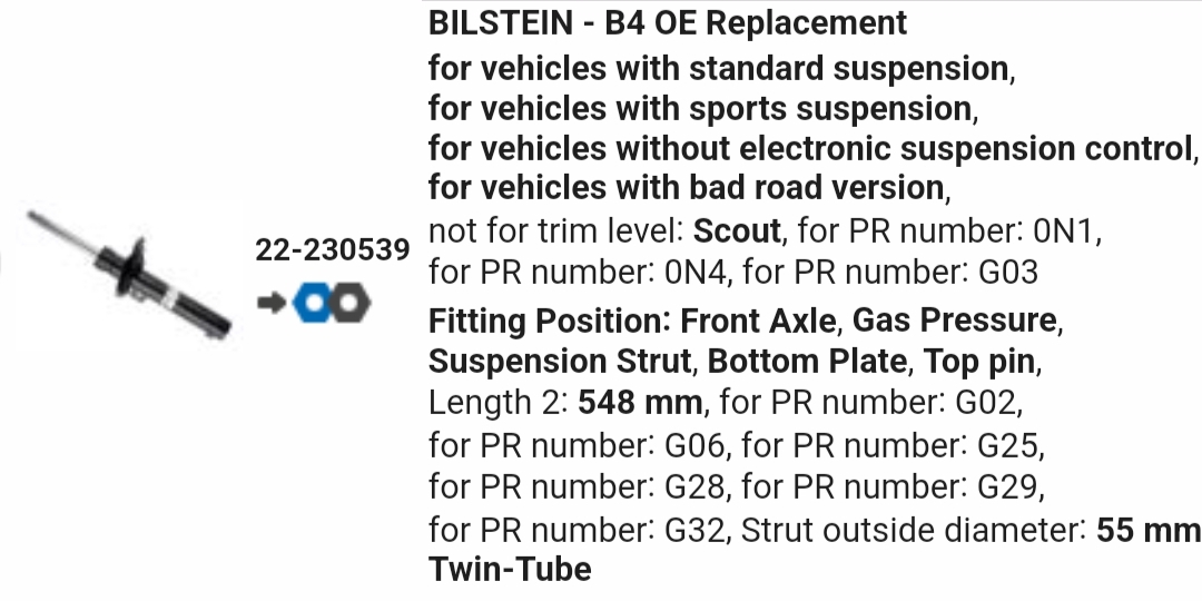

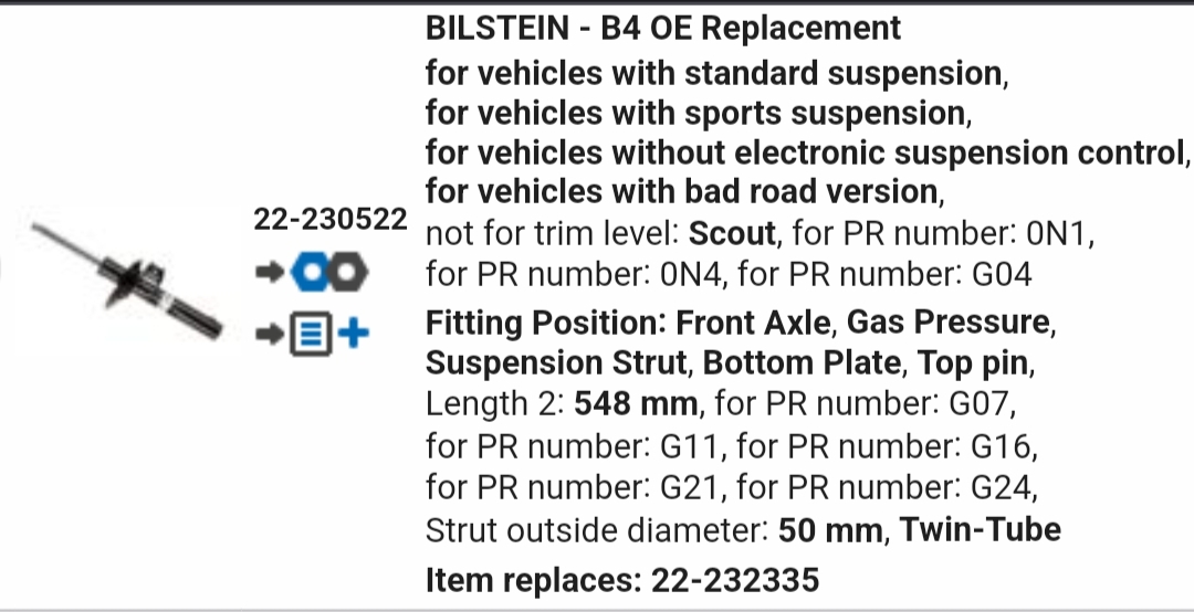

This is because I noticed the Bilstein website says the below, In which case these would be correct?

Bilstein are showing G07 against their 50mm strut diameter Bilstein B6 and Bilstein B8 front shock absorbers. That is clearly incorrect, because G07 front shock absorbers have a 55mm strut diameter.
Bilstein do a 55mm strut, but it says its for different part references 🤷

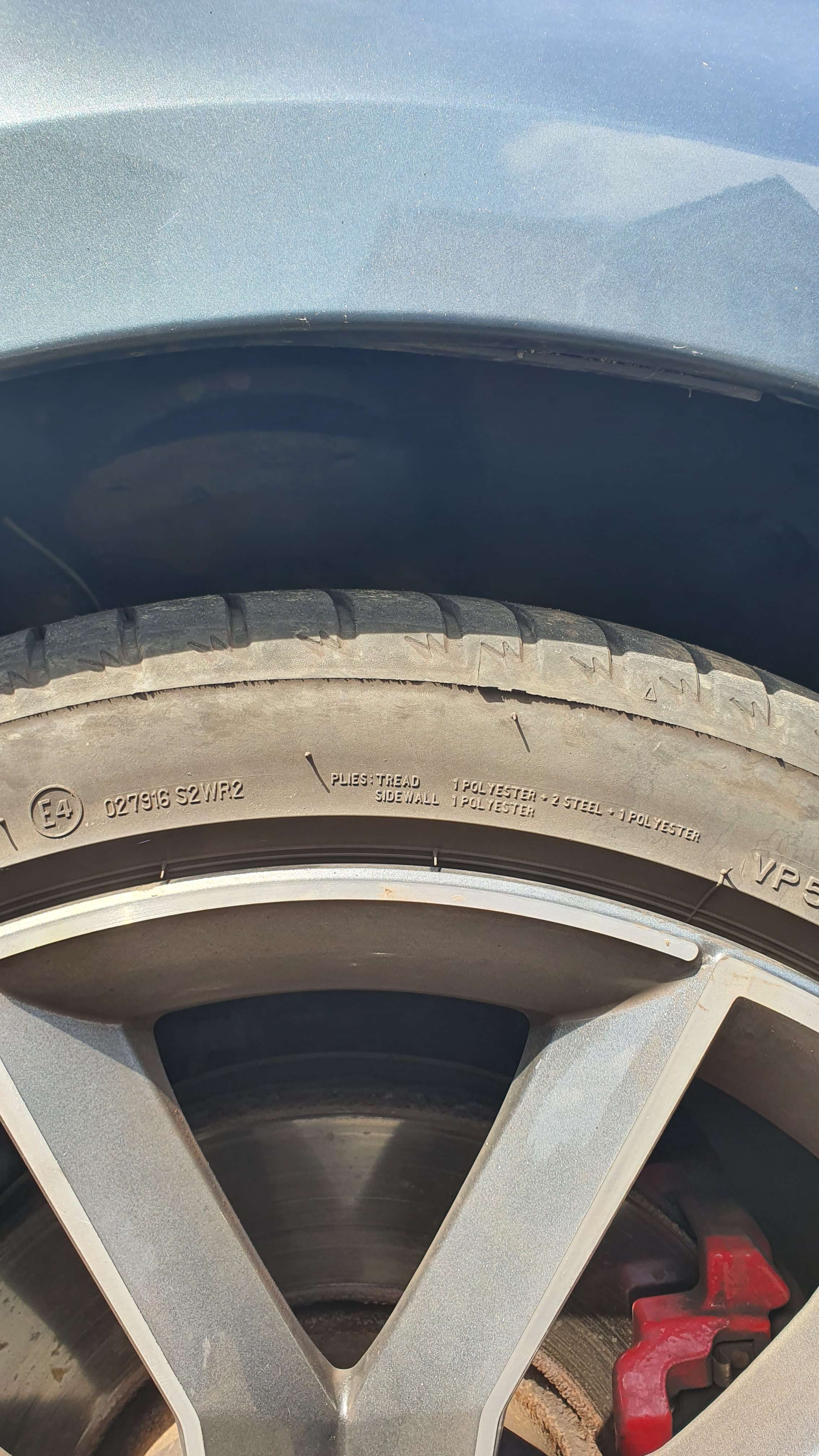

Picture of the front wheel.

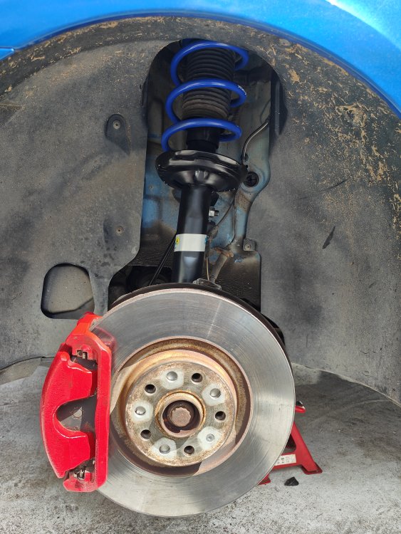

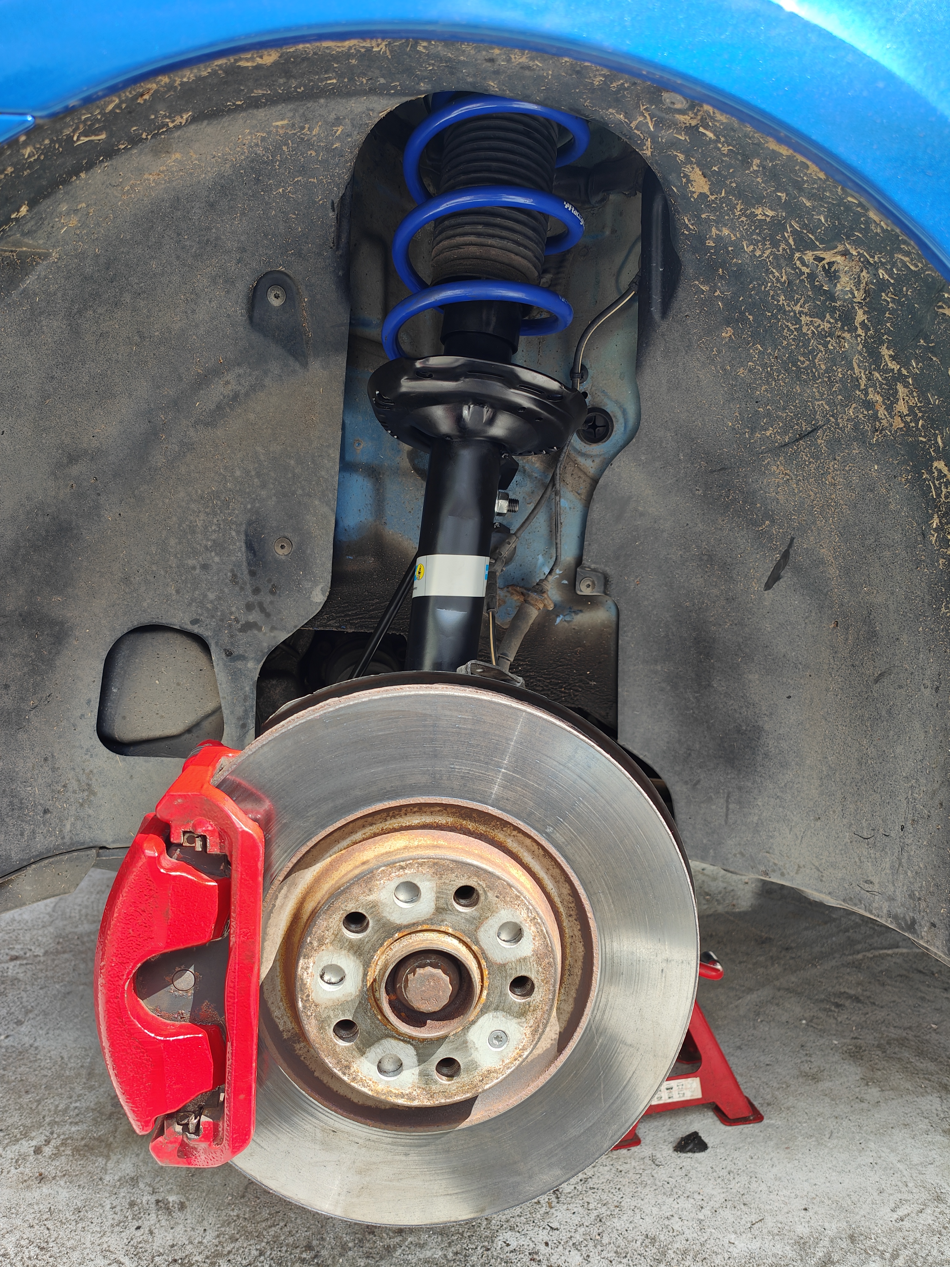

They are lowered over stock but they are still high. I've added Racingline springs and it's subtle but a very slight drop. Just enough IMO and doesn't scrape. Comfort is better because of the newer shocks, maybe 10% stiffer but barely noticeable.
Before
After
What they look like on
Edited by Dooge
@DoogeDid you need new springs or did the existing ones work OK?
No, existing springs work absolutely fine but I didn't like so much arch gap. I picked up these springs second hand but barely used. Plus, almost 100k on existing springs and rust makes me believe they have more chance of snapping. It's not common on these though.
