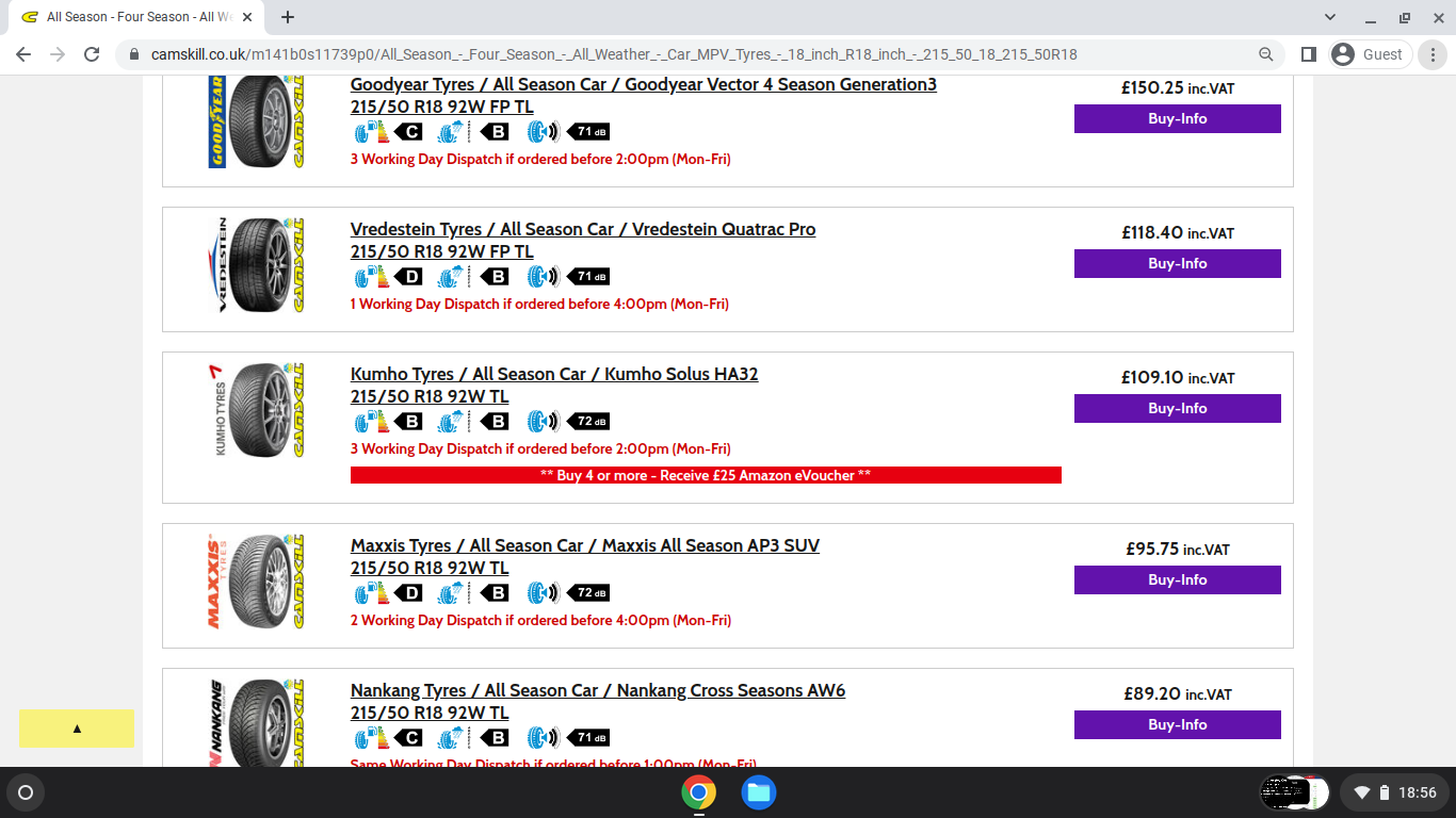

Bridgestone Turanza ECO Enliten
215  50  R18  96W XL
I've these on a 73 plate 1.5 DSG.
Appreciate on reading in to them they are designed for max fuel mileage.
But they are hopeless below 18 degrees C (UK).
Seeking alternatives as their grip is poor to say the least.
But to replace with same size etc I've found only one brand Goodyear Eagle F1.
There are many brands available but NOT with 96W XL which if ignored would require an insurance declaration.
Any thoughts.
@6nations   it is the 96W that is the issue.  Lots of choice in 92V XL in that size.
@Carlstonwill know if you have to stay with 96W XL
As to your hopeless below 18 degrees C (UK)   do you mean below 8*oC or really mean pretty much the temp that much of the UK is at or lower much of the yea?
Goodyear Eagle F1 are a tyre pretty much like slicks when it is damp even in warm weather.
Edited by Rooted
@6nations 215 / 50 R18 size, if you want grip all year, wet or dry, even frost and sleet then go for all seasons, not summer Eco spec which it was delivered with.
pick any of following (no particular order, but availability timescale or price might determine it anyway)
Bridgestone Turanza all season 6
Continental all season contact 2
Goodyear vector 4season gen3
Pirelli Cinturato all season SF2
Michelin cross climate 2 SUV
The Bridgestone Eco is aimed at (heavier) electric vehicles which is why it has the higher 96 load rating.  Vast majority of 21/50 R18 have 92 load index.
Other spec Karoq (even with heavy diesel engine) have 92 load rating, so don't think you need the 96 rated tyres
