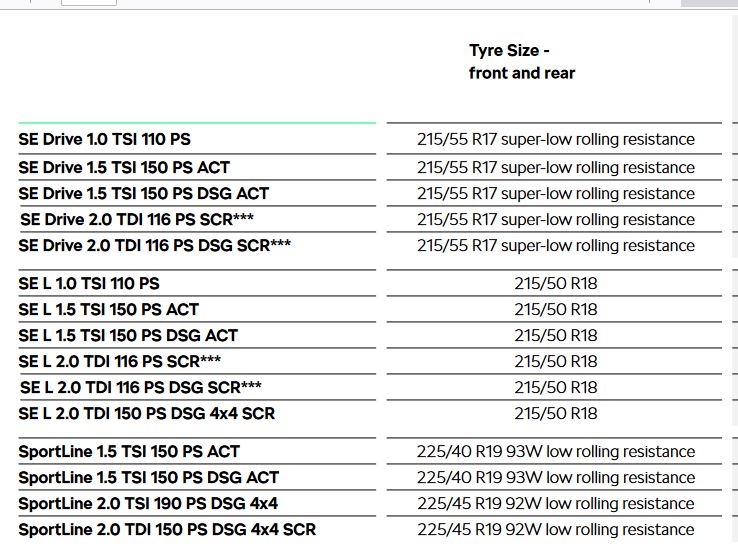

Current Karoq brochure:
Edit - just checked the 2019 Karoq brochure which I still have. All 18" wheels were as above - 215/50/18 92W with the exception of the 2tdi 4x4 which was 95W.  If a 2.0Tdi 4x4 didn't need 96W, you can bet your last penny a 1.5 doesn't.

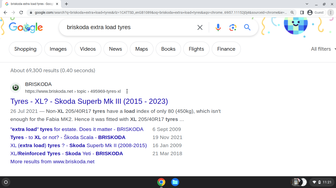

Fabia Mk2 vRS on standard 205/40 R 17,s came from the factory with or without XL marked tyres.
There was no change in tyre pressures if the Tyres were XL. Pretty low profile really.  The Sister cars Polo, Ibiza, A1 twincharger same engines / gearboxes and 132-136 kW came on 215/40 R17,s.
Go to Black Circles or similar sites and select the Tyre Sizes and Speed / Load rating and if you want Extra Load tyres or not.
Or just search BRISKODA and Extra Load tyres.

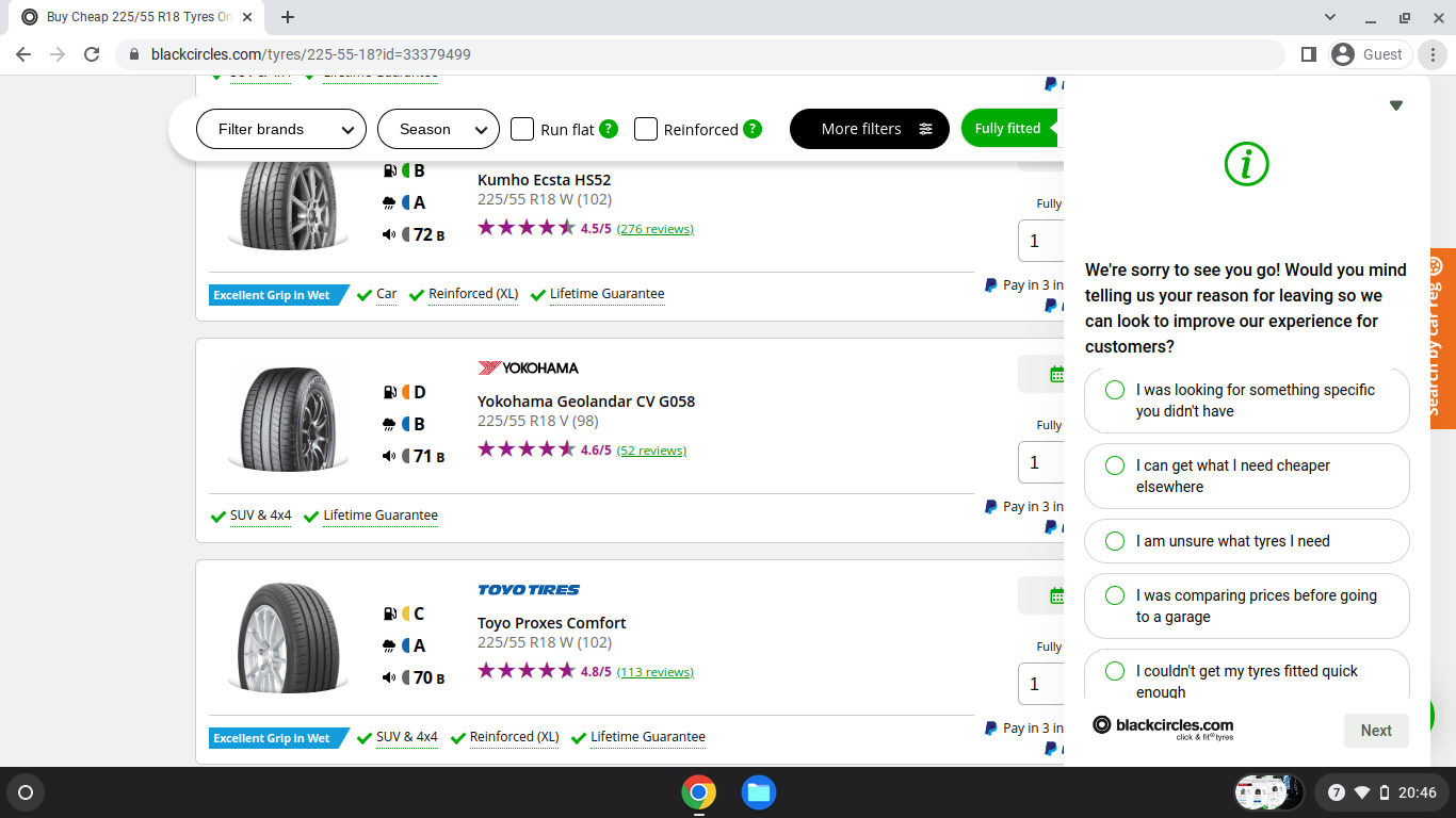

Regarding XL tyres, has anyone come across any non XL tyres recently, they seem to be pretty rare.  I would prefer these, as although the extra sidewall reinforcement in XL tyres makes them stand up better to say scraping along kerbs, they do apparently increase car ride ride harshness.  i would rather have a less robust tyre with a nicer ride and be prepared to risk occasionally forking out for a tyre that has suffered damage.  When I was wanting to change to all weather tyres earlier last year, sadly I couldn't find any non XL ones.
I doubt whether BlackCircle information on their website can be fully trusted.  For example, the Michelin Cross Climates don't seem to be indicated as being XL, but I'm pretty sure they are.  Maybe some of the cheaper more obscure tyre makes are non XL.

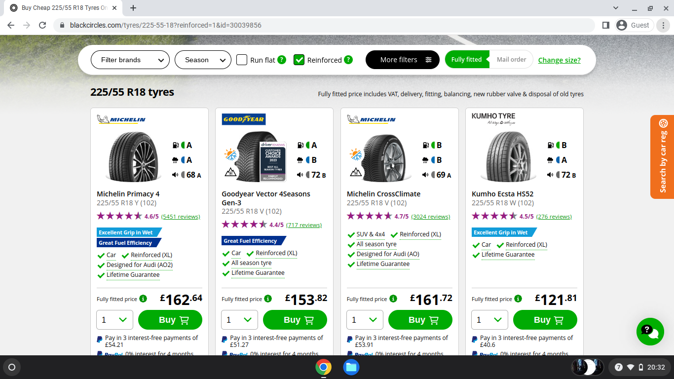

hi, in my search the Bridgestone doesn't state XL https://www.bridgestone.co.uk/car-tyres/summer-tyres-turanza/turanza-all-season-6
looking at this and the Goodyear Vector Season Gen 3 is also not XL but I think I'll go with the Bridgestone as good Tyre Test by TUV SUD

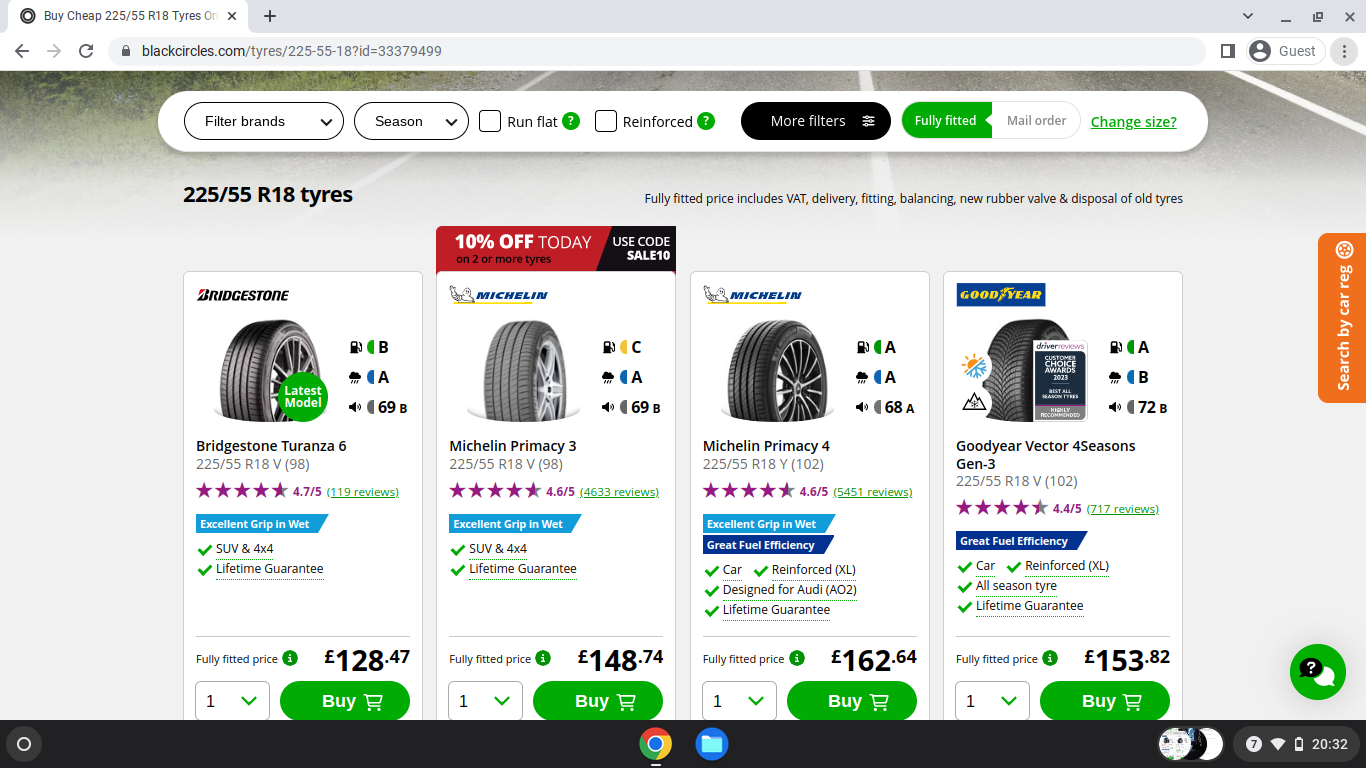

Ticking 'Reinforced'  shows differently from not ticking.
Primacy 4 & Vector 4Season XL and still comes up when you have not ticked XL.
Yokohama Geolandar not got a tick for XL.
Edited by Rooted

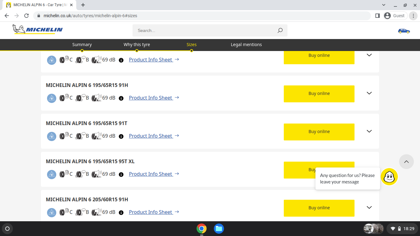

I wonder if, in practice, XL and non-XL are any different these days?   I recall seeing 4 ply and 6 ply belts years ago but  haven't seen any reference to that for years.   I read somewhere that Michelin, for example,  use the same carcass across many tyres and XL tyres aren't re-inforced as such.  In others words the diferent rating are more marketing than anything else.    Tyre companies surely can't make multiple speed and load rates tyres in each size?   Be interesting to compare the weight of an otherwise equal XL and non-XL tyre.
We had CrossClimates on  a Golf when they first came out and were only available as XL - the car rode far better on those than it did on the standard load Bridgestone Turanza's it came with from new.
I noted earlier the standard load 92W Michelin Primacy 3's on our Karoq say max pressure 51psi and that's around the same as others have suggested for XL tyres.
They will manufacture many combinations of speed / load rating and XL might be with the higher load / pressures but not always.
Different applications, world regions / countries.   Different depths of tread by size as well.

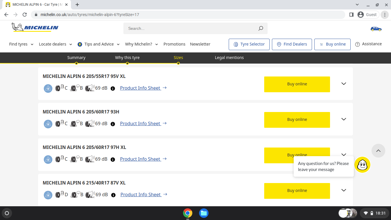

Perhaps we're at cross-purposes a little - I'm wondering if (for a given size) they'll make one tyre, but mark it with the various speed and load ratings so it satisfies the demand for those.
Some tyre sizes, such as the last one in your list, 215/40R17, are only available in XL with a load index of 87 .  Some online sellers don't note all the tyres they list in that size as XL, even though they are.
