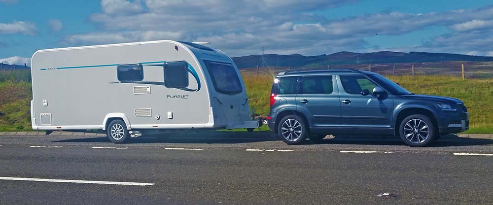

I have the Westfalia removable one fitted by a local specialist, but I don't think they reprogrammed the electrics as mentioned above. No problems at all towing my caravan which comes in at 79% of the Yeti kerbweight.

Couple of checks to see whether it has been reprogrammed correctly:
With trailer plugged in does the central screen show a trailer outline when reverse selected.
With trailer plugged in do the reverse alarms sound when reverse selected (they shouldn't!)
With trailer plugged in does the car's rear fog light not illuminate.
There are others, but those are the simplest.

Thanks for the reply. No trailer outline on the screen, reverse alarms very much sound when trying to hook up caravan, just tried the rear foglight one with my trailer and it doesn't light up.

Sounds like some but not all programming has been done.
