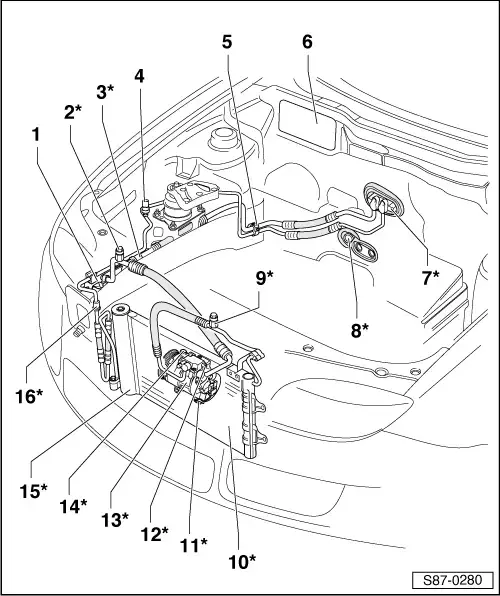

The A/C condenser is the thing that sits in front of the engine coolant radiator. The A/C evaporator is the thing in the cabin that gets cold. Just cabin-side of where the refrigerant pipes go through the firewall.
The thing under the driver's seat is probably a diesel fuel cooler.

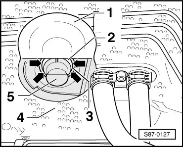

The evaporator drain is visible in the first two photos you posted, 8* in the first 5 in the close-up second photo, adjacent to the pipes going to the heater matrix. Find it under a flap of sound insulation (shown as item 1 in your second picture), and as described in that linked thread.
The condensed water is probably running from this drain, around the body metalwork to a low point near the fuel cooler, then falling to the ground.

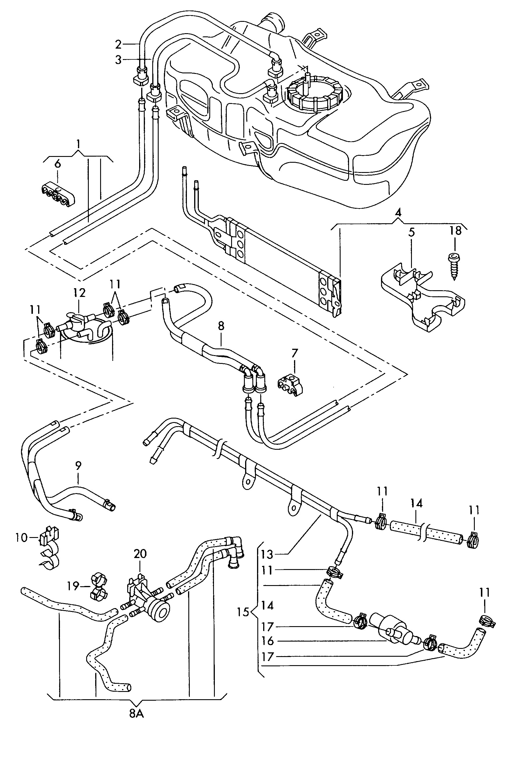

Many thanks Breezy I have now found diagram of fuel cooler and as it always dropped water there after the AC was on  I assumed it was to do with the AC.
Why it decided to drop the other side of the car is strange ,but if the AC works OK  and the condensate is not coming into the car then the engine under shield can go back on and case can be closed. At least I've learned something about AC ( and the fuel cooler I didn't know I had) in the last few days. I enclose diagram of fuel system the cooler being no 4. Thanks for replies Bob
