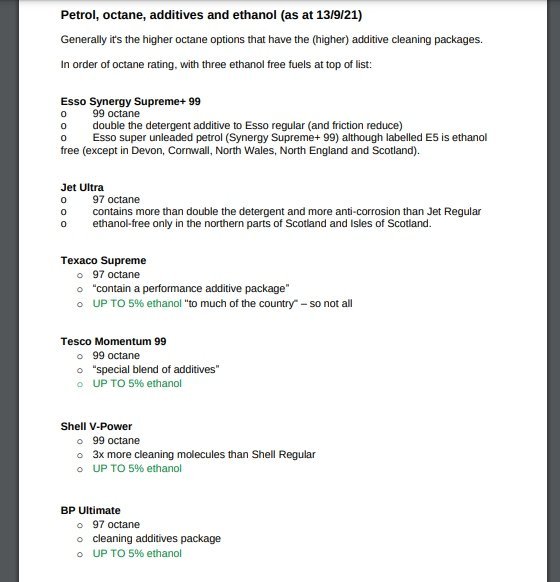

What new E5 / 97 min or 99 min fuel would that be?
Super Unleaded has been sold in the UK for a long time now.
E10 might well have more bio in than pre September 2021 but really i think he is blowing smoke.
276235547_1384336435_Screenshot2022-01-3014_03_59.jpg.d43b66a38bf086423e31cbd1b02722b8(1).jpg.36fe5772d927b86674b025b891bf3028 (1).jpg
