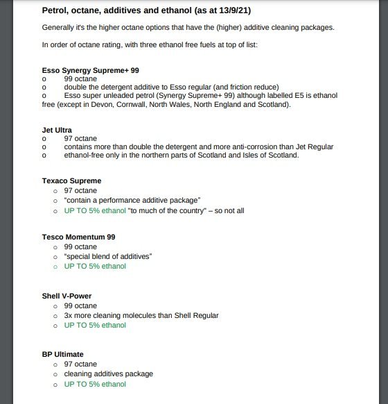

Those that have actually driven or owned Twinchargers might well have changed their usual fuel and then had an Exhaust Control Light or EPC light or both come up.
Often that just happens to be because a spark plug was about to give up anyway.
Not all E5 in the UK is the same, not even from the same Brands.
But it is booting the car and having turbo & supercharger boosting below 3,500 rpm that you get a warning to check stuff and take it easy til you find the issue,
or stick with your regular 97 or 99 ron min petrol.
Maybe that BP 97 had too much Detergents, or even their filling station tank was filled in error with 95 ron, as happended to me at a Sainsbury in Aberdeen years back.
(I had a switchable map from APR luckily to get home with, but still had a brown trouser moment in an outside lane  climbing a hill out of Aberdeen with someone right up my jacksy when it went into limp mode.)
Same thing when staying in Preston on the way to Santa Pod and filling up at Tesco Blackpool with Momentum 99 the night before heading south and the next morning the car running sh!te.  (I had been running tanks of it no problem in the north and on the way south other than when using 102 ron for special occasion.)
Luckily i had Hiperflo 250 (102 ron) in cans in the boot and put that into the tank.
