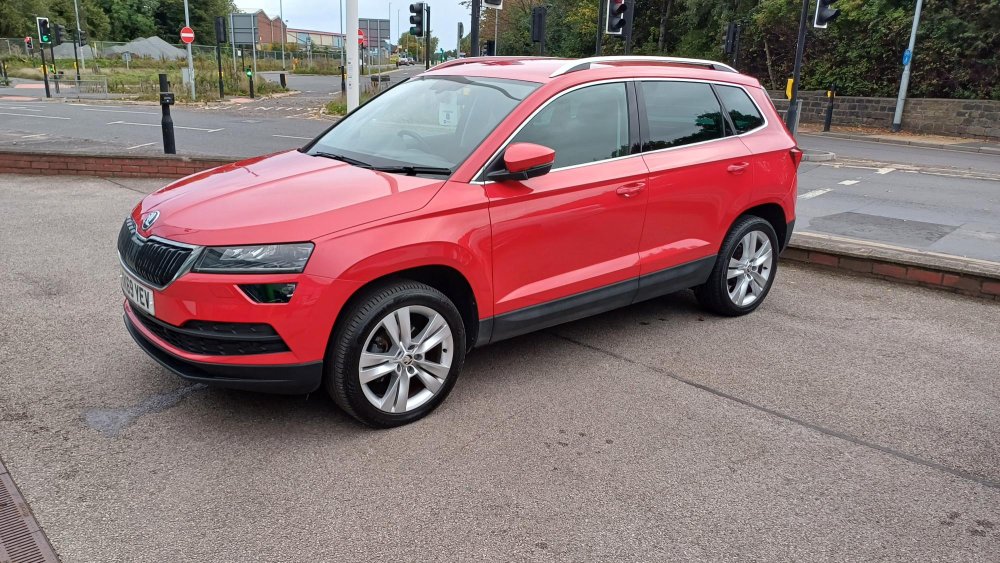

YK69YEV
TMBKR7N UXL2010434 Karoq SE L 1.5 TSI 150 PS DSG Velvet red metallic Engine number: DPCAC15770
Yes, would be funny if it were AWD (does AWD reduce mpg even if you have it switched off?) and good news if it has the DQ 381!
The car is being brought over from another branch, so that might explain things!
  • Sponsor
VIN suggests front wheel drive, DQ200 transmission family.

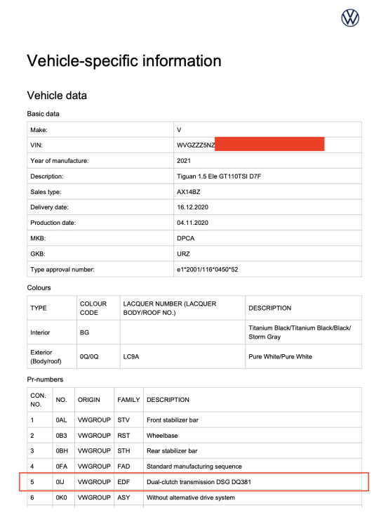

My December 2020 manufactured 1.5 front wheel drive Tiguan is the DQ381. Can't say I've notice much difference in real life driving between it and the DQ200 in my Skoda
