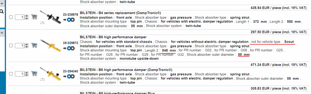

Was hoping Bilstein B6 would fit.

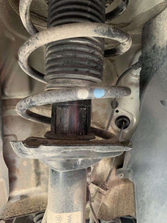

  • I may be wrong. But if you take a look at each spring, transport blocks are big enough, so that they can’t be missed. No real need to go to a dealer to check if they’re still ON. 😉
  • Have you checked the transport blocks have been removed. They fill in some of the from suspension to reduce the body movement in transport. Some dealers forget to remove them. They are usually in the

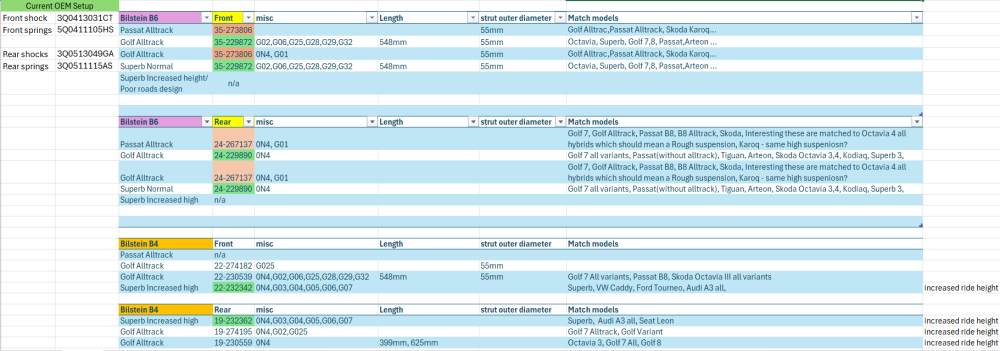

Do you want to try standard ride height shock absorbers, such as Bilstein B6, with your increased ride height springs, or do you want to drop the ride height by changing to standard ride height springs.
I would like to stay with the current increased height. Thats why I bought the Scout.
I dont know from where the height comes ? Only due to the 'longer' springs? If that is the reason - how the Biltein B6 for normal height will work with the longer springs ?
I am getting the daily feeling that the car is 'swimming' or and feeling like a boat. Its just that feeling that car is sitting only on the springs and even the smalles bump that are on the road are transferring to the cabin. It is very strange that the car leans a lot, there is a lot of movement of the body, it has the boat feeling but when I hit a bump or a sleeping policeman there is sooo much noise and it seems I am bottoming out the suspenion. Does that mean that the spirngs are soft or the shocks are soft ? As far as I can understand the Bilstein B6 are much harder shocks and I have to know what will be the end result before I spent a lot of money and replace the oem 3 years old suspension.

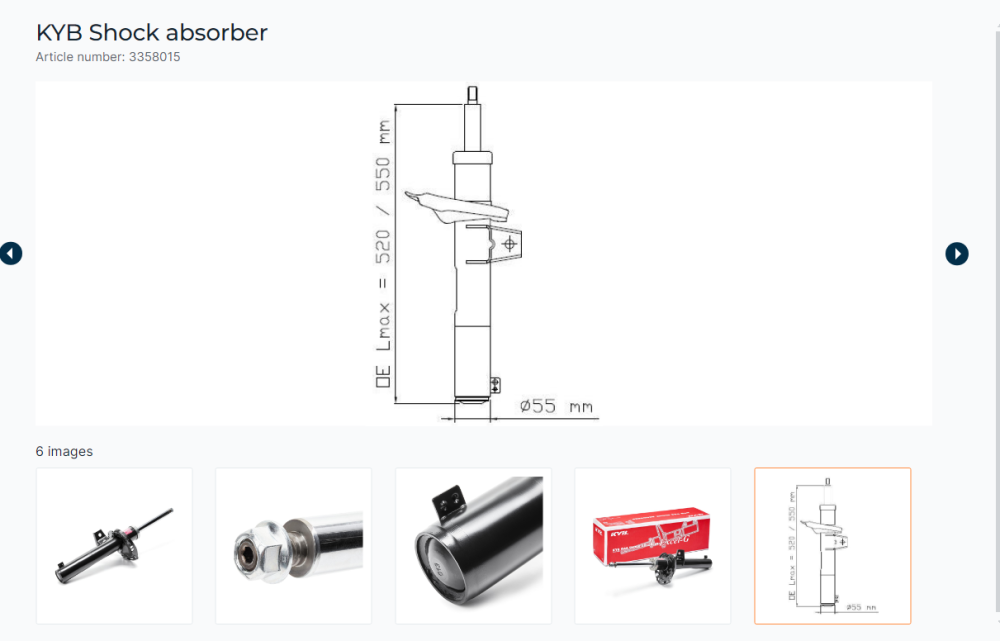

Wonder if these would work ? It suggests they will for “ increased height”, and KYB struts generally are good
https://www.autodoc.co.uk/kyb/14359022
and
https://www.autodoc.co.uk/kyb/14359027

Wonder if these would work ? It suggests they will for “ increased height”, and KYB struts generally are good https://www.autodoc.co.uk/kyb/14359027

Now, about the KYB, I am thinking that most of the OEM replacement will be pretty much the same and thats why I would risk with a time proven product as Bilstein. I am feeling more and more confident about that change. I am just afraid what will happen with changing the current soft dampers to B6 and keeping the old Springs.
Tonies,   I have the same doubts about going to B6 if the comfort on major dual carriageways/ motorway roads suffers.
I am certain the diagnosis is that the OE front shocks compress too easily but rebound too slowly so cannot handle well against repetitive rough spots or dual small “ bumps” , one close after the other.
 My car has increased ride height and weight range 5 springs ( 2.0D FWD manual gearbox) and I think this weight range spring in this model shouldnt be too soft a spring.
Simply, the OE dampers are too slow to re-extend on multiple slightly-rough areas  of road.
I would hope some replacement front shock brand will still be comfortable but respond more quickly on rebound, - but I would like to get it right the first time rather than experiment / risk everyday driving getting worse!
and

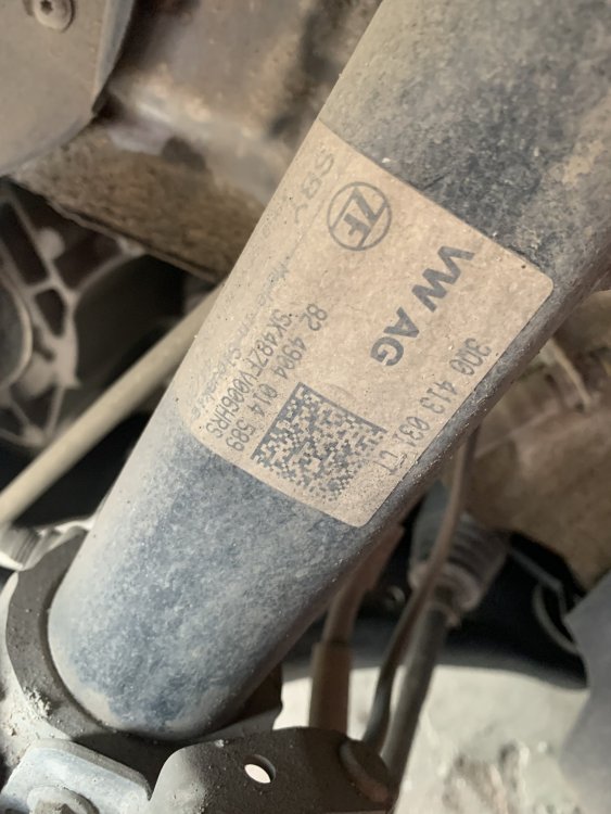

The KYB 3358015 front shock absorbers and KYB 3448024 rear shock absorbers are listed as aftermarket replacements for lowered ride height shock absorbers, standard ride height shock absorbers, and increased ride height shock absorbers, ie. it's a one size fits all approach from KYB so might not be a close match to the specification of the original shock absorbers. It's a similar story with most of the other aftermarket shock absorbers. However, these KYB shock absorbers should be long enough for the increased ride height car otherwise KYB shouldn't be listing them for it.
KYB 3358015 front shock absorbers are sold to replace the following OEM part numbers
OE 3Q0413031BN — VW
OE 5Q0413031CJ — VW

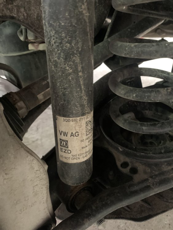

KYB 3448024 rear shock absorbers are sold to replace the following huge list of OEM part numbers
OE 5Q0513029DQ — VW / SEAT

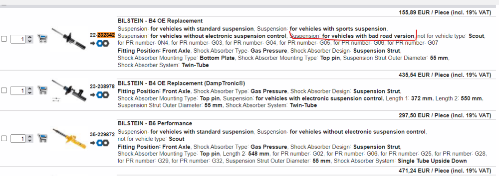

As far as I can see for Bilstein - this is the part number that is needed for my Wagon - 35-229872.
I did some research and we can see the sizes here 548mm:
Also we can notice the specified NOT FOR - Scout ...
However, According to the sizes because If I compare it to the KYB 3358015 above front size is from 520mm to 550mm (550mm that is supposed to be the size for the Raised vehicle ) - it means that B6 should also fit on the OE springs ?
Increased ride height cars are only about 15mm higher than standard ride height cars. If you've ever jacked up a car, you will have seen that the car's body goes up quite a way before the tyre lifts off the ground. Therefore, it might be worth giving the standard ride height Bilstein B6 shock absorbers a go.
As you can see below, autodoc are listing different Bilstein B6 shock absorbers for the (Passat B8 Alltrack, Karoq) compared to the (Passat B8, Octavia MK3, Superb MK3). I suspect it might be better to use the (Passat B8 Alltrack, Karoq) versions for the Superb MK3 4x4 with increased ride height.
Bilstein B6 shock absorbers for the Passat B8 Alltrack and Karoq for the Superb MK3 4x4 with increased ride height.

I am not sure that the comparision between Alltrack and Scout is correct because as far as I have  seen an Alltrack - it looks higher than my Skoda.
Also the regular Passat estate is also lower than the Alltrack:
Now, about the link above for the Alltrack version of B6. Its strange that according to the site above, the shown B6s are fitted to VW Alltrack series eg - Golf, Passat, even Tiguan, and for Skoda - only for Karoq. So considering that the Passat Alltrack is higher than Skoda Scout, and the presented part is also fitted to a SUV like Tiguan and Cupra Forementor, Seat Ateca - can we judge that this is not proper replacement for the Superb even with higher suspension ? May be the 'normal' B6 version for Skoda will be better approach? Sadly, It seems there is no website containing that Bilstein B6  Alltrack dampers what size are they to compare with B6 for Skoda Superb  - even the official Bilstein site...
Looking at the gknautomotive.com spring catalogue you can see that the Passat B8 Alltrack has similar length front springs to the Superb MK3 4x4 with increased ride height. So the Passat B8 Alltrack has +15mm increased ride height suspension just like the Superb MK3 4x4 with increased ride height.
This is good news because it means that the below Bilstein B6 shock absorbers should be ok for the Superb MK3 4x4 with increased ride height.

A little update and info from my side. I did go to the dealer and asked what are my current suspension setup and I asked for a prat numbers:
Front shocks - 3Q0413031CT
Front springs - 5Q0411105HS
Rear shocks - 3Q0513049GA
Rear springs - 3Q0511115AS
According to the front shock number - this clearly matches the Bilstein B4 but again nothing for B6... I am sure that Bilstein doesnt even know that the Scount is just a Superb with a rised suspenions/bad road.
I am attaching a few pictures that I got in the past from beneath the car. Front one seems to match but am I wrong that I see a different part number on the rear shocks ? It clearly can be seen as - 3Q0512011JC by ZF ? I am confused now.
According to the above information, which bilsten B6 will be most suitable to order for my Scout ?

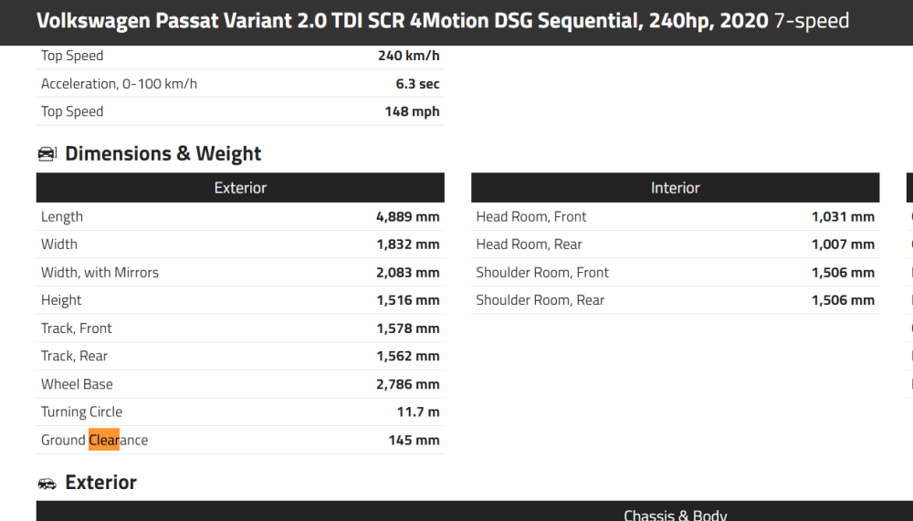

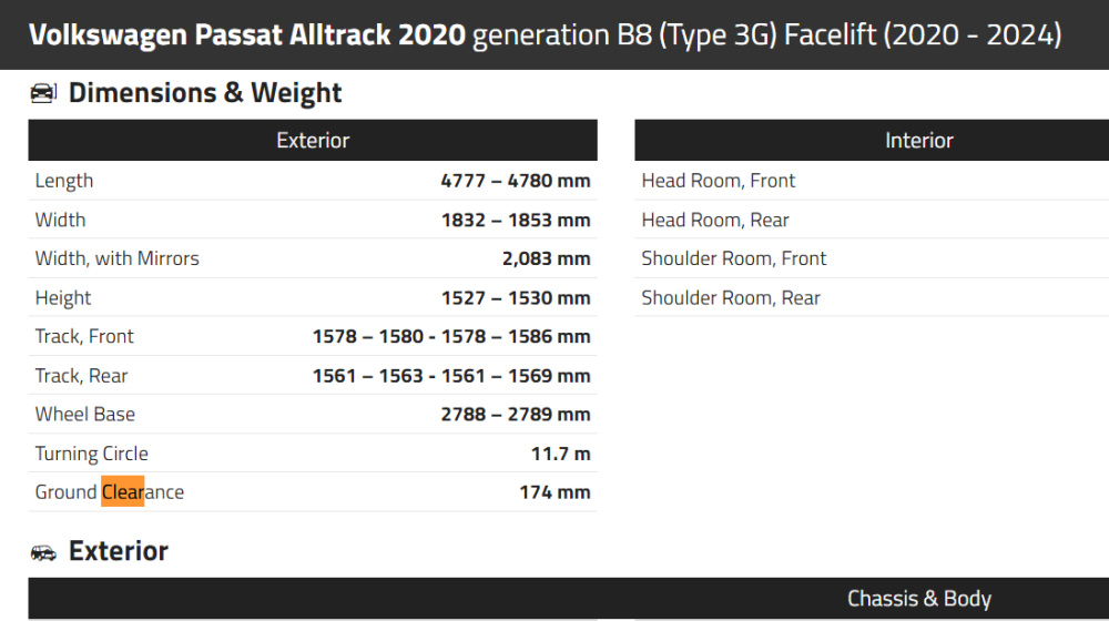

Is there any possibilities that the passat alltrack B6 version is logner than the Skoda Superb standard ride height one?
I am curious from where the differences in the ground clearence comes for the Superb Scout, Passat Alltrack and Skoda Karoq:
 Karoq 172 mm
Passat Alltrack 174
 Superb Scout 151 mm
There is clearly something related between the Karoq and Passat - just as it is stated and pointed that the Bilstein B6 35-273806 is for.
Hows that possible that there is not a single word about the technical data and size for Bilstein suspenions?
Do you think there can be any major differnces in the sizes between the two versions B6 - Skoda Superb standard height and the passat/karoq?

The front and rear springs are very similar between your Superb MK3 280HP Scout and the Passat B8 Alltrack. The Passat B8 Alltrack has slightly stiffer springs, but only about 0.25mm increase in wire diameter which is about 5% stiffer.
The front springs are so close that Kilen/Lesjofors sell the same aftermarket front springs to replace both 5Q0411105HS (your front spring) and 5Q0411105DP (Passat B8 Alltrack front spring).
Lesjofors 4095142 front spring (sold to replace both 5Q0411105HS (your front spring) and 5Q0411105DP (Passat B8 Alltrack front spring)
https://www.autodoc.co.uk/lesjofors/15270767
The 151mm ground clearance for the Superb MK3 Scout seems incorrect, if the Passat B8 Alltrack is 174mm.
The Superb MK3 Scout is clearly increased ride height just like the Passat B8 Alltrack. If it wasn't, you wouldn't have almost the same front and rear springs as the Passat B8 Alltrack.
As the Superb MK3 Scout springs are similar to the Passat B8 Alltrack springs it's probably better to use the Bilstein B6 shock absorbers that are listed for the Passat B8 Alltrack on the Superb MK3 Scout, rather than the standard ride height Bilstein B6 shock absorbers.
The Bilstein B6 shock absorbers for the Passat B8 Alltrack are probably a little longer than the Bilstein B6 shock absorbers for the standard ride height car. This is because the front shock absorbers on the standard ride height car use bump stops with a 70mm height, whereas the front shock absorbers on the increased ride height car use bump stops with a 90mm height. So if the front shock absorbers on the standard ride height and increased ride height cars were the same, using 90mm bump stops would reduce the front suspension travel by 20mm on the increased ride height car. Hence, it would make sense for the increased ride height car to have longer front shock absorbers than the standard ride height car.
