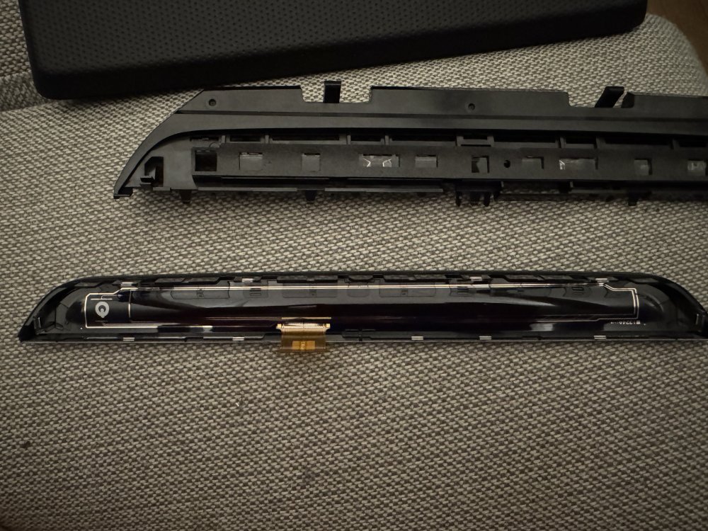

  • Hello, after reading this thread, I decided to share the information I’ve gathered so far. I started experiencing the same symptoms as others described here: randomly increasing volume, key press sou
  • LivornoBart
    LivornoBart
    Hello, I made a solution for this kind of issue and also made a short movie how to fix touch panel under the black panel which is under the display if you have problems with self clicking or volume go
  • mertpolat
    mertpolat
    @omeromeryigit Thanks for the information you shared. I followed the steps in the post one by one, and in the end my volume increasing issue was fixed. I solved the problem by cleaning the unit that

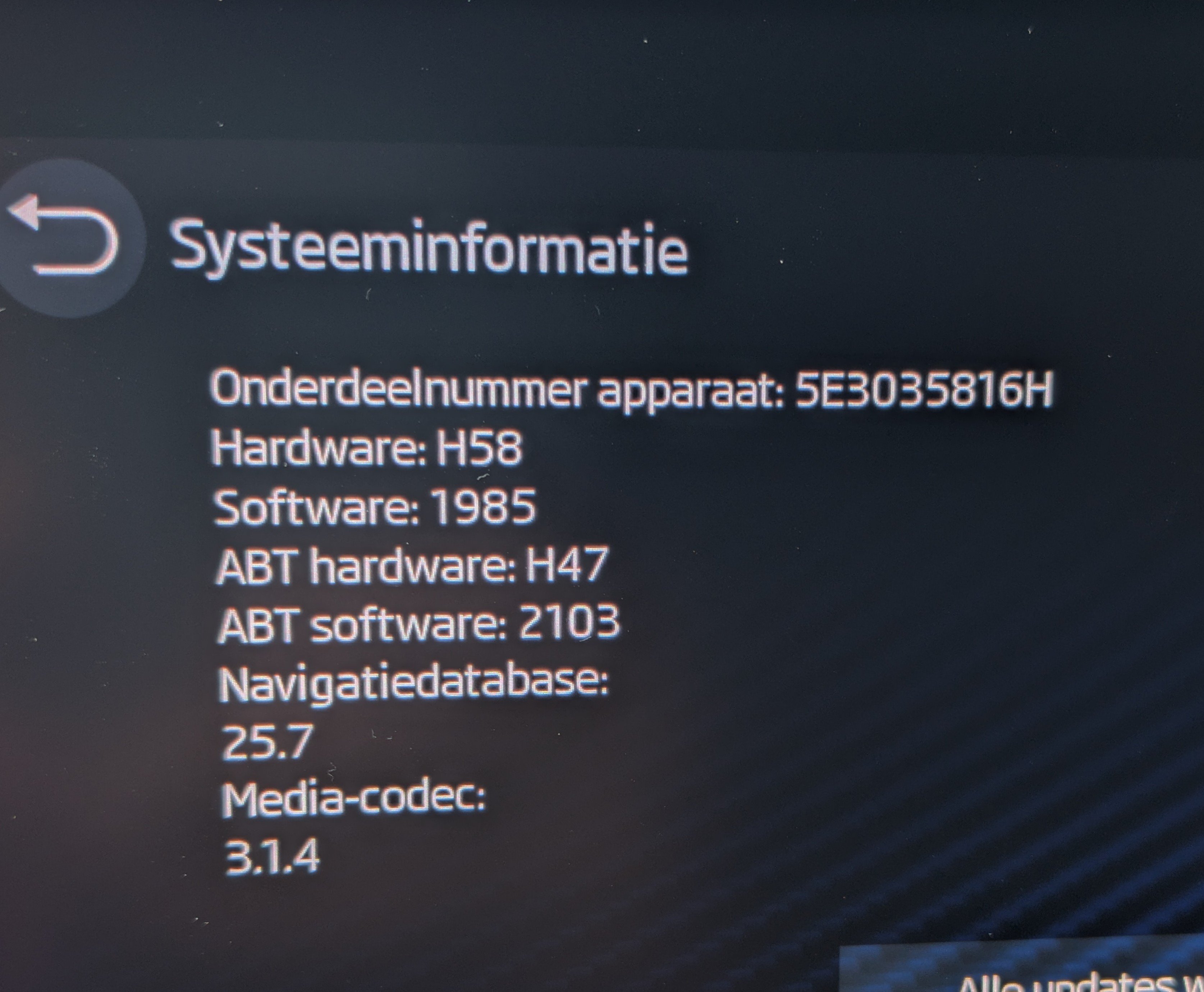

Today i replaced my screen. From h47 to a H49.
I hope the screen demons belong to the h47 and never come back. Easy to swap. 30 min work.
My dealer promised to refund me. He had no options but i have.
That’s good news.
So do you need to match the ABT software of the old one? Is there no component protection?
I upgraded from hardware H47 to Hardware version 49. The old version is not ok.
There is no component protection.
Only thing when swapping remove fuse number 30 and number 46.
One week update.
No problems anymore.
Hoor it stays this way.
Very happy with the upgrade. H49 hardware is much better then the h47

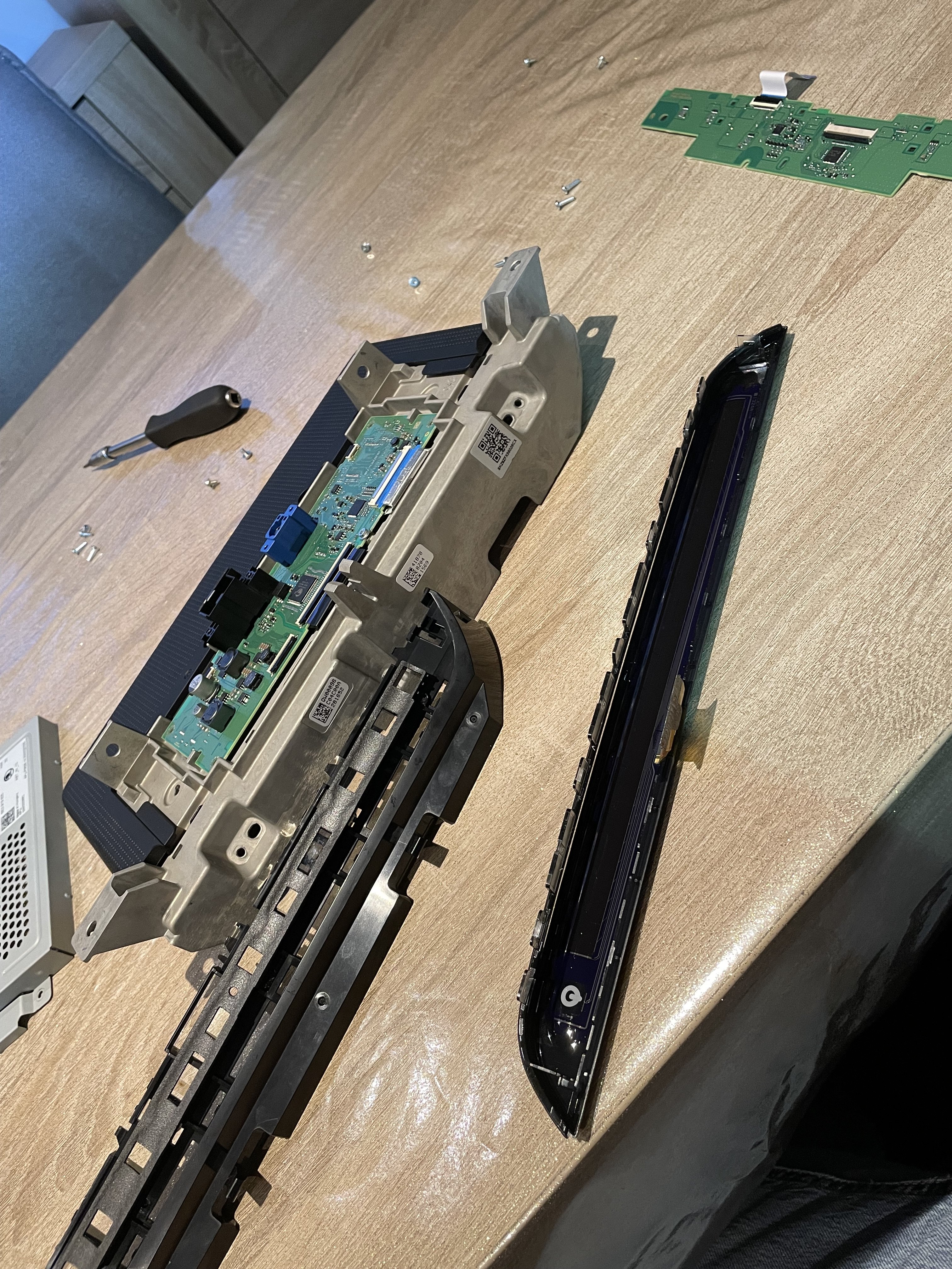

I'm hoping to first try just disconnecting the volume and on/off slider: my hope from other threads is that at least confirms what the problem is, gives me back things like Climate Control in the short term, and then I can look into getting a replacement.
When you say "easy to swap" though... I'm not sure where to get started. Does the screen unit pop out of the dash with a bit prising, or does the whole dash/trim need to get removed first? Any tools you'd recommend?
So far I've found photos of the screen when it's removed, but I can't really see steps to get it out in the first place.
Thanks.
First you remove the black cover at the back off the screen. Straight up. Then remove carefully the Strip from the passenger side to under the screen. Use a plastic removel tool.
In top there are two screws and left and right from the screen there are screws. 4 in total.
If you want to disconnect the slider leave the plugs in place. You can turn the screen around.
Then remove the 6 or 8 small torx screws. Look at the pictures here with connector you need to unplug.
Hope you have something with this explanation.
  • 4 weeks later...
On 16/08/2025 at 13:20, Alexsus said:
I have now been driving for four weeks after I cleaned the inside of the touchbar and have not had any issue with the volume turning up by it self.
Take it apart and carefully clean it with isopropyl alcohol. Let it dry and put it back together.

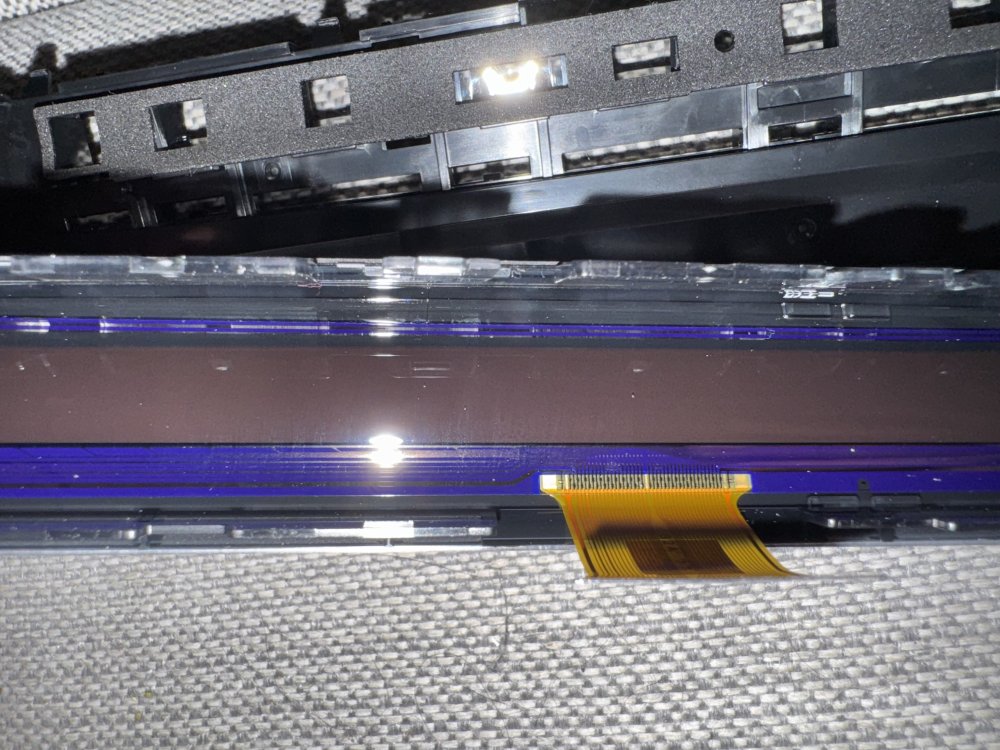

Hello,
Merry christmas.
Today i opened the screen, cleaned the scroll bar with isopropylic alcohol and repluged it.
For the moment, it works fine 👍🏻

I first disconnected the cable from the touch-bar to the stereo and reinstalled everything to make sure the touch-bar was the problem. This removed the problem for weeks.
Afterward I tried cleaning the reverse of the bar and reconnecting it, but after that I found the volume was turning itself down all the time. It didn't do this straight away - it waited until I'd put it all back together and driven a fair few miles first!
So I've decided just to disconect the touch-bar again: I don't think I know enough about what I ought to be cleaning, and I don't want to spend more of my weekends connecting and disconnecting it.
I'd rather it was all connected, but it's not a problem at all not having the touch strip working and it's solved the problem.

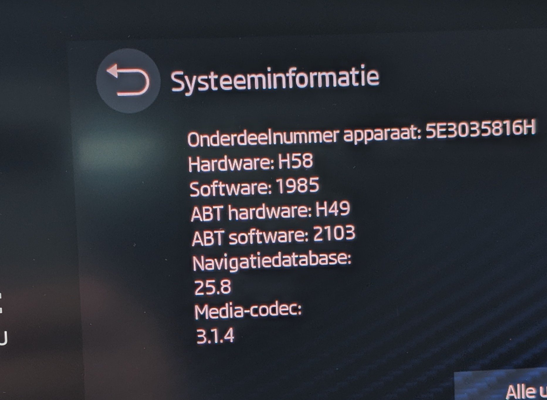

After reading all of the comments, I also decided to elaborate on the topic, and to see if there is some kind of update regarding this issue with Octavia MK4 model.
Basically, after buying as used car sometime in September 2024, car started increasing volume, restarting Infotainment system, and one day after work my wife could not start the car (some people from work told her that car was playing music on max volume for quite a while, so this is how we found out that it started Multimedia on its own). Battey drained completely so it needed to be changed. I got to a authorized service and they gave me replacement MMI, “which didn’t have that issue”, to test it some days. After no issues for 9-10 days, they ordered new MMI.
Infotainment display was changed sometime in December 2024 and I had no issues until 2 months ago, when after washing my car, volume started increasing again on its own. It was random, like previous time, but this time I didn’t have issue with MMI restarts nor starting MMI while car engine is not running - only volume up issue. Volume bar below the display was not changed at all.
Since I was still in warranty period of previous replacement, I contacted Skoda and they ordered a new Infotainment display - only asked for video as proof to factory. I sent it, and no additional questions asked (kuddos for that). Month later, new MMI came and I got a call to get it replaced (in the meantime, I didn’t experience any issue for a month! Nevertheless, I got it changed, and moved on as usual.
Couple of days ago, I went for a short vacation and left the car at the airport parking lot - and you imagine the stress of car not recognizing the key… Then, I thought it was the battery. But the key was giving a red light when pressing the buttons.
Anyway, 2 hours later, found somebody to start my car with cables and it got me going (Start/Stop option was not available, and bunch of yellow signs, but could be driven - 3 hours ride, no sign of volume, or any similar thing).
Since it’s weekend, I still didn’t have a chance to get it diagnosed in the Skoda service, however I wanted to write the post for all, due to the fact that my new MMI is actually H49, praised by some of you. I hoped it was not H49 - as this seemed like light at the end of the tunnel, but after checking, my new Infotainment replaced a month ago is H49 (picture attached).
Are there any news or developments, or any device that some of you might have?
PS. I suppose I will need to change the battery, but I managed to start the car with the same battery 3-4 times this morning.
