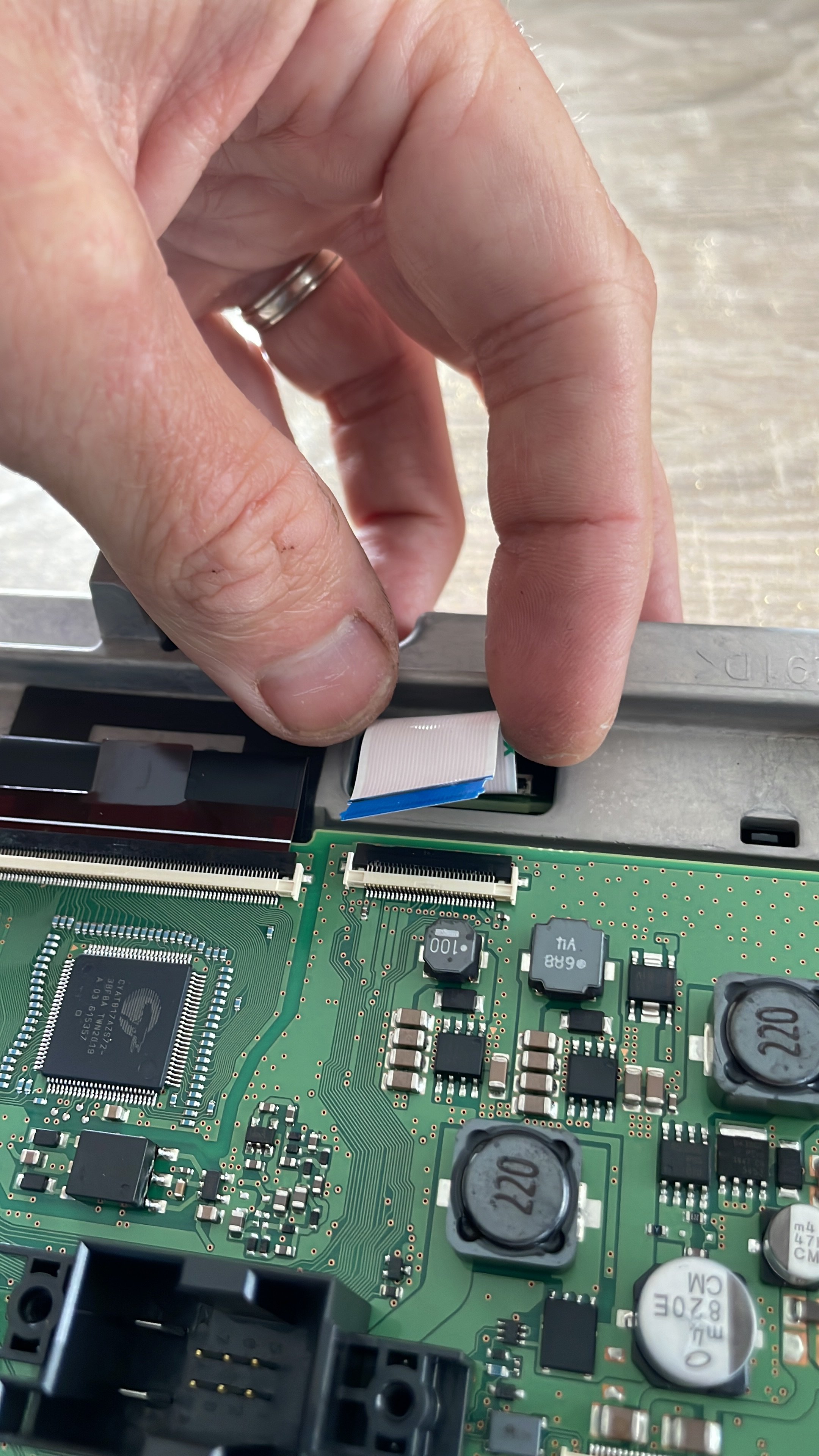

Hello, I removed the connection cable socket of the multimedia sound touch bar. I only control the sound from the steering wheel.IMG_20250616_203144.jpg
Can you still use the "power on" button next to the volume touch bar if you disconnect that cable? Or is there another way of turning it on and off?
When removing the specified film cable, the vehicle ignition must be on and the multimedia system must be running. From now on, the multimedia system will remain running every time the ignition is turned on.
Obviously assuming this sorted the issue ........
Nice simple fix, well done.

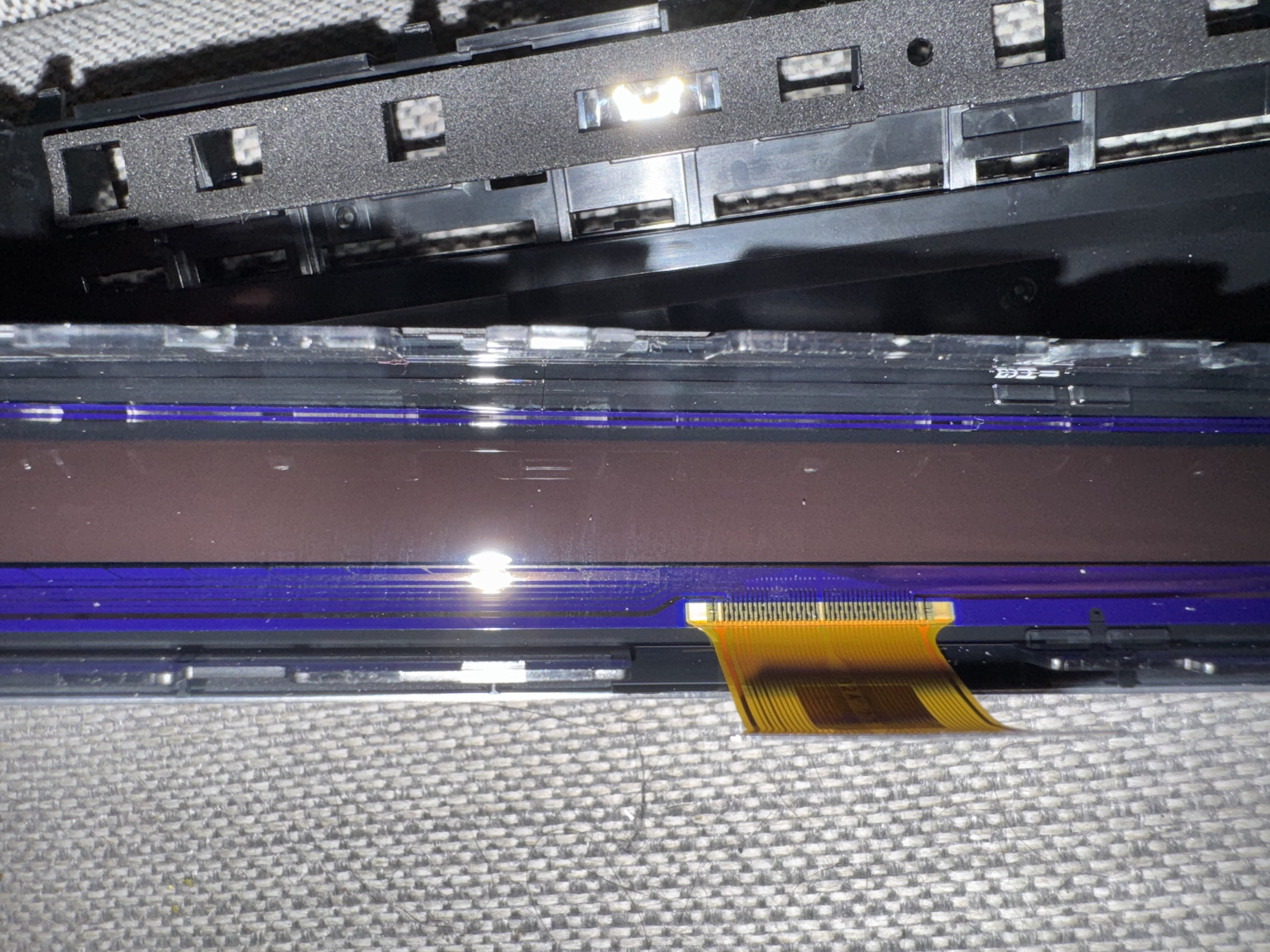

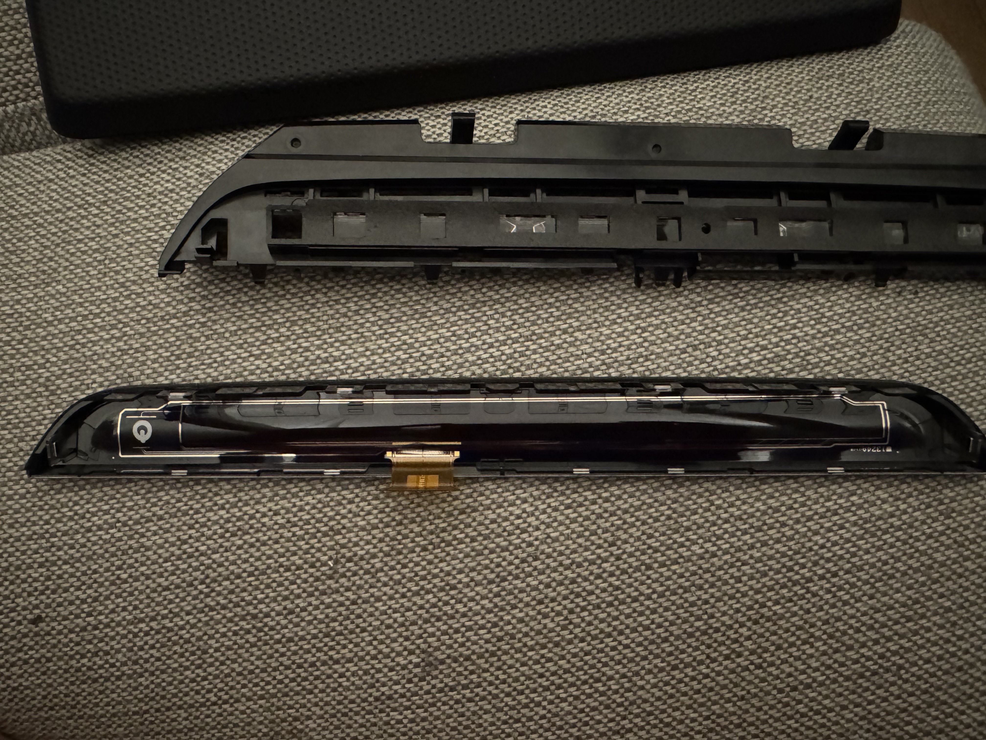

I have now been driving for four weeks after I cleaned the inside of the touchbar and have not had any issue with the volume turning up by it self.
Take it apart and carefully clean it with isopropyl alcohol. Let it dry and put it back together.
Bravo; how will this sound bar be disassembled? Can you share a video or picture?

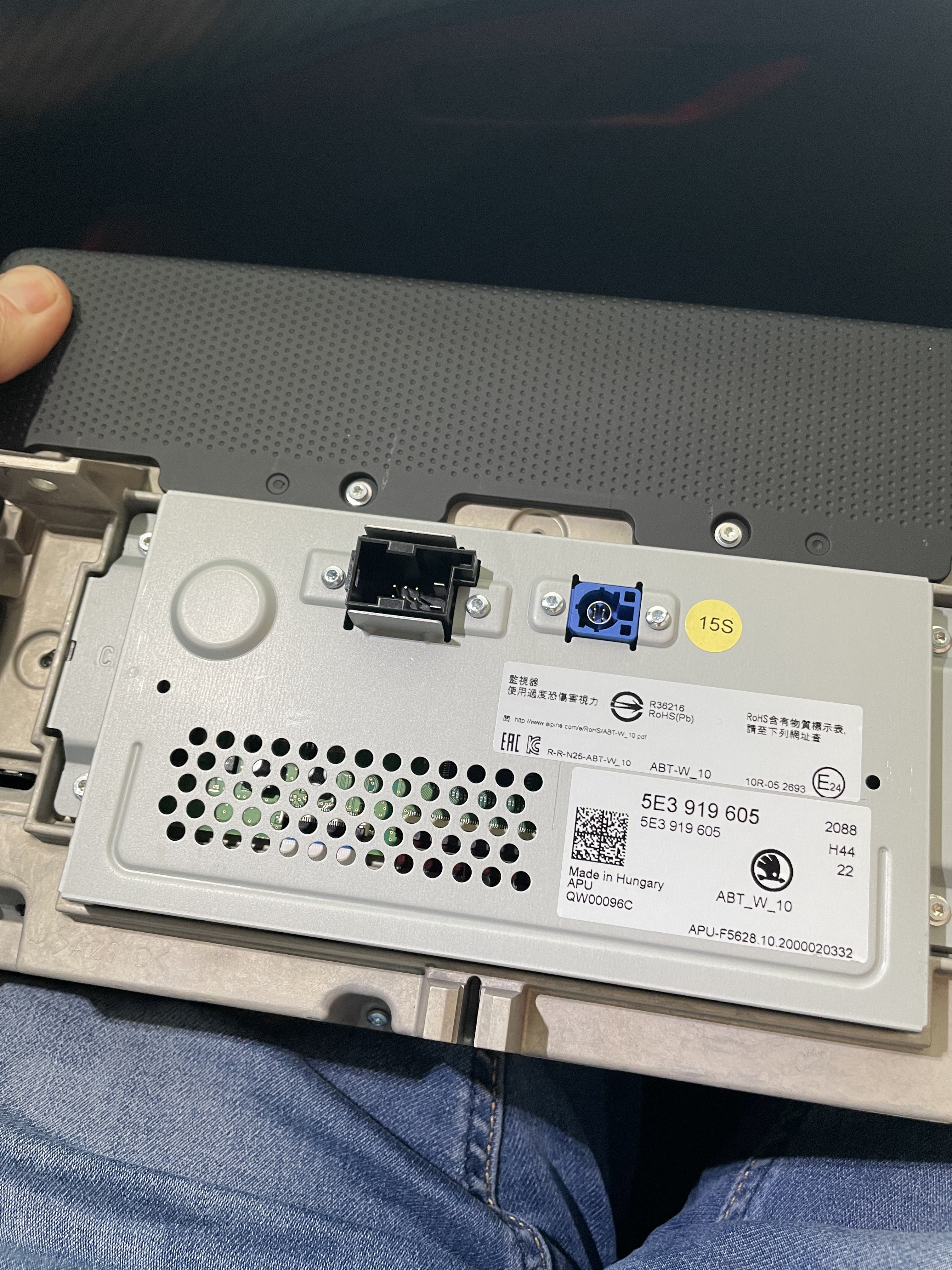

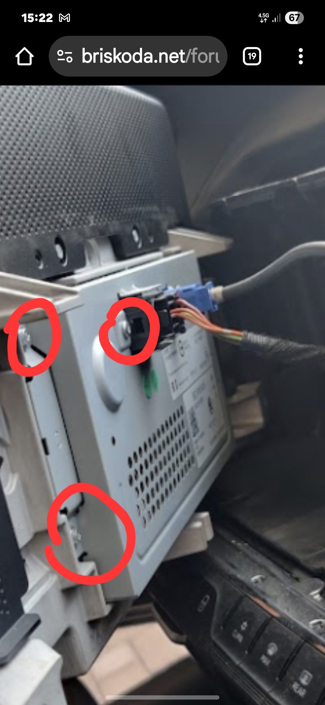

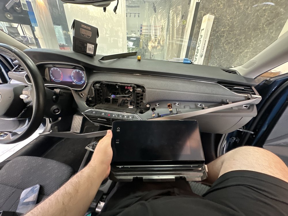

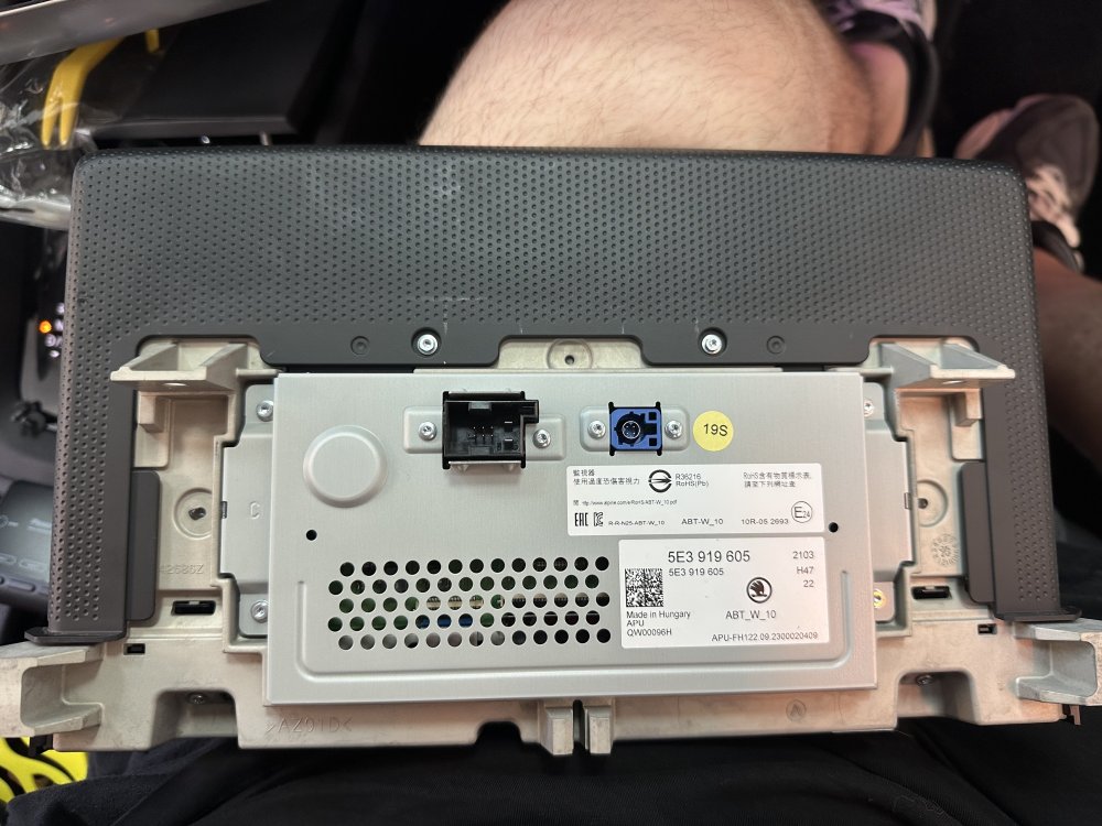

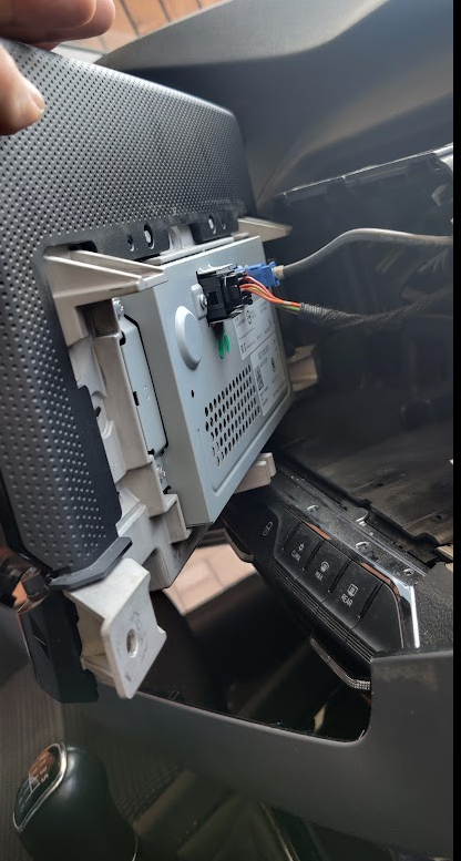

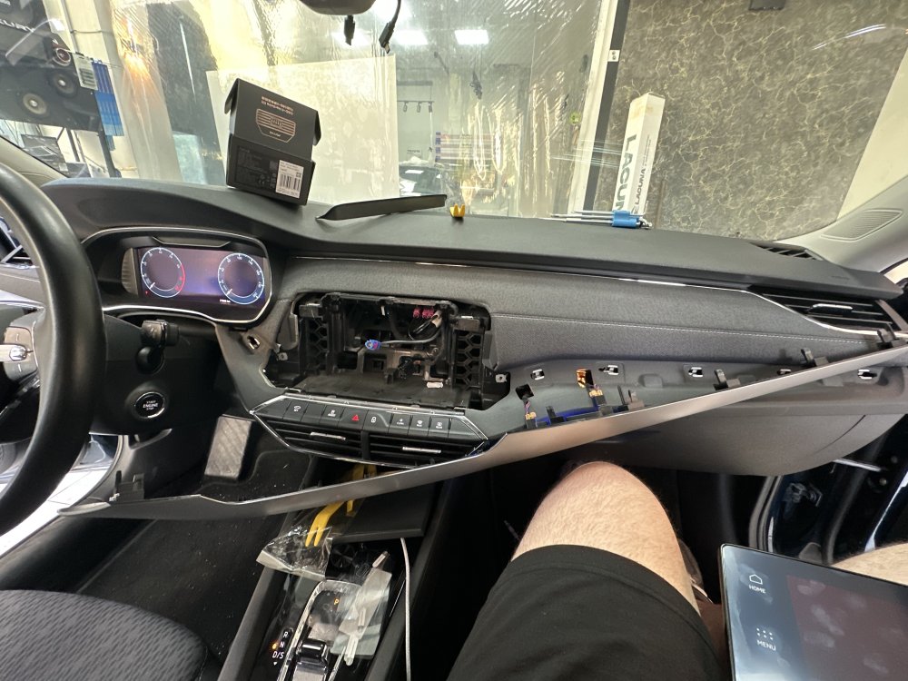

got the front plastic removed with my hands, and the screws are off too, but this plastic part at the back won't come of:
any idea where to pry open exactly? I'm afraid to break the plastic

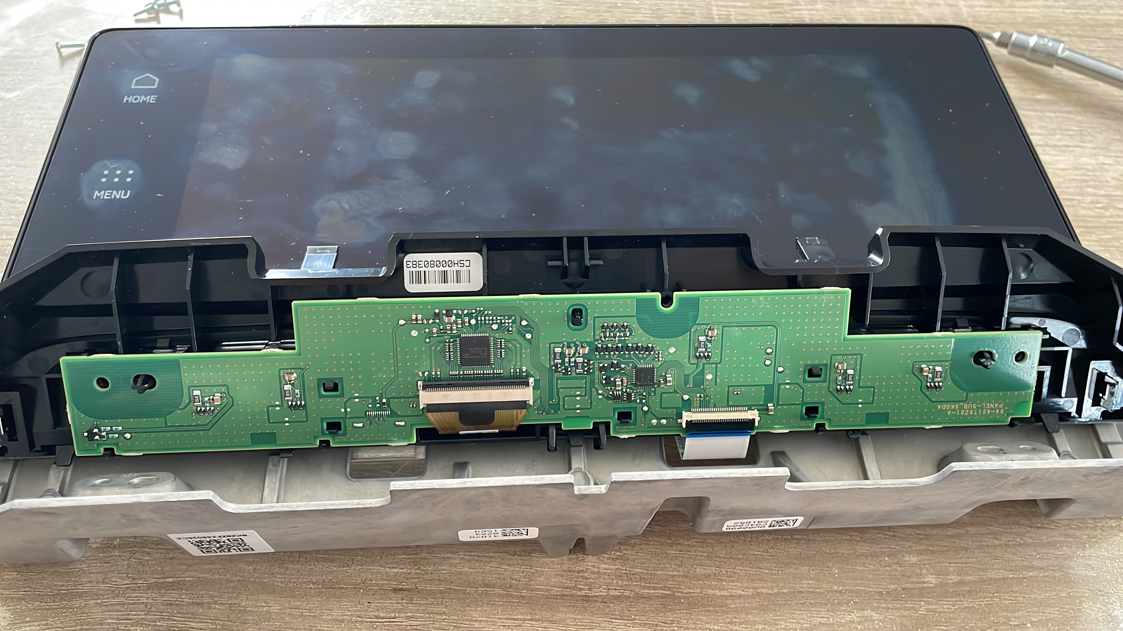

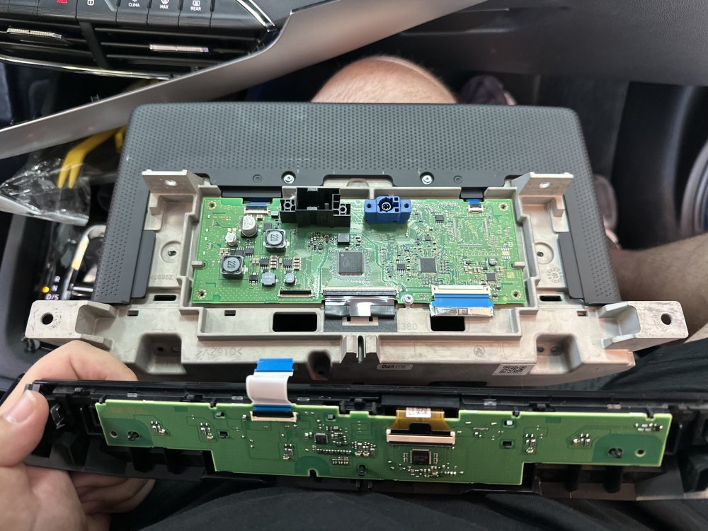

I finally managed to open the damn thing, but I see no flat cables here...
Can someone help me out which screws need to be opened to see them? And can I disconnect those 2 cables to do this outside my car?
1 hour ago, omeromeryigit said:
Thanks man! Made it work... and saved me alot of money!
Hello,
Did you cleaned both faces ?
