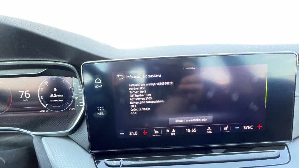

I own 2022 Octavia MK4. I am facing this issue from November 2023. Initially it is a rare occurrence and later a month, the infotainment restarts automatically and play radio automatically. Finally the dealer replaced infotainment controller. Then I did not see the issue for 6 months. The issue surfaced again from mid of July. I suspect the problem in touch bar under the screen. It is getting faulty signals. Planning to contact dealer next week. The attached video taken during the problem.
Latest developments:
The car stereo sound has again started to increase uncontrollably, without the ability to mute it. However, I noticed that if I turn off the stereo with the button, the Bluetooth communication, AC, and parking sensors work normally. Only radio broadcasting is powered off.
After a few hours parked in the sun, a light show began on the instrument panel along with the message “Safe CP” and the display on the stereo showed “Component Protection Active”.
After half an hour in the parking lot, the messages disappeared, but an airbag error appeared, which could not be cleared by turning off the car.
After 10 minutes of driving, I stopped by the roadside, turned the car off and on again, and now everything works without any problems. There are no errors on the display, the stereo volume does not increase, and everything is as it should be.
I have sent an inquiry to the service center and am awaiting a response.
Update to follow.
Where are you based? What are the temperatures over there "in the sun"? Did you have any sort of sunscreen covering your dashboard?
I’m in Croatia, pretty warm this days, dashboard uncovered.
The latest update: a display replacement was arranged at the service a few days ago, and in the meantime, the car infotainment was working great, without any problems, until today when it started to screech again while the car was turned off and parked. I recommend, as a first aid measure, to adjust the climate control to your liking and remove fuse number 30 from the fuse box under the steering wheel. And yes, the car was parked at sunny side of the parking, and temperature outside is about 30C.
Final update,
The display was replaced today at the authorized service center, a large portion of the cost was covered as goodwill, summer continues in full force, so we'll see.

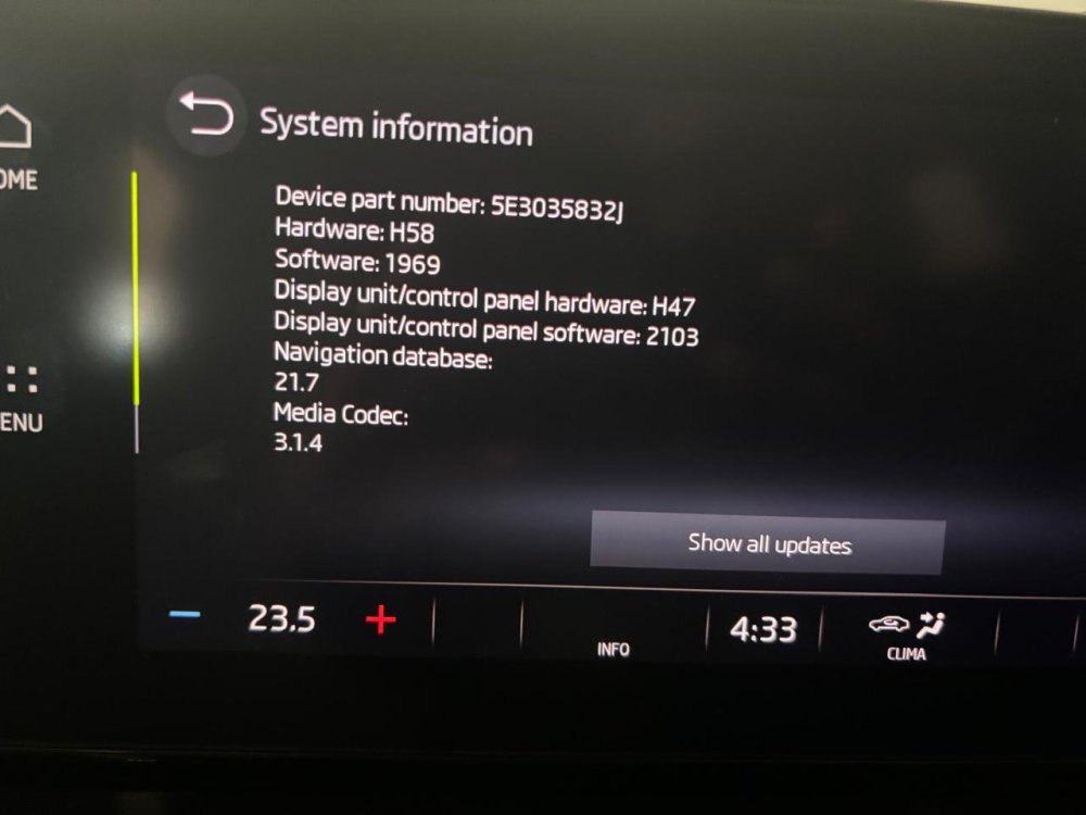

Just an update on this issue. The Skoda service center agrees to replace the display unit. The older version of the display unit is H47 and the newer unit version number is H49.
The display unit is replaced with new one. The new version is H49. Hope it should solve the issue.
@ArunD has this issue been resolved with the new unit? Mine is a H47 unit and has started to show these issues every time I switch the car on, the infotainment is unusable at this point.
Yes had the unit replaced and all working as it should now.
Yes. With H49, the issue is resolved. Its been more than a month now and I have driven 2000km. No issues.

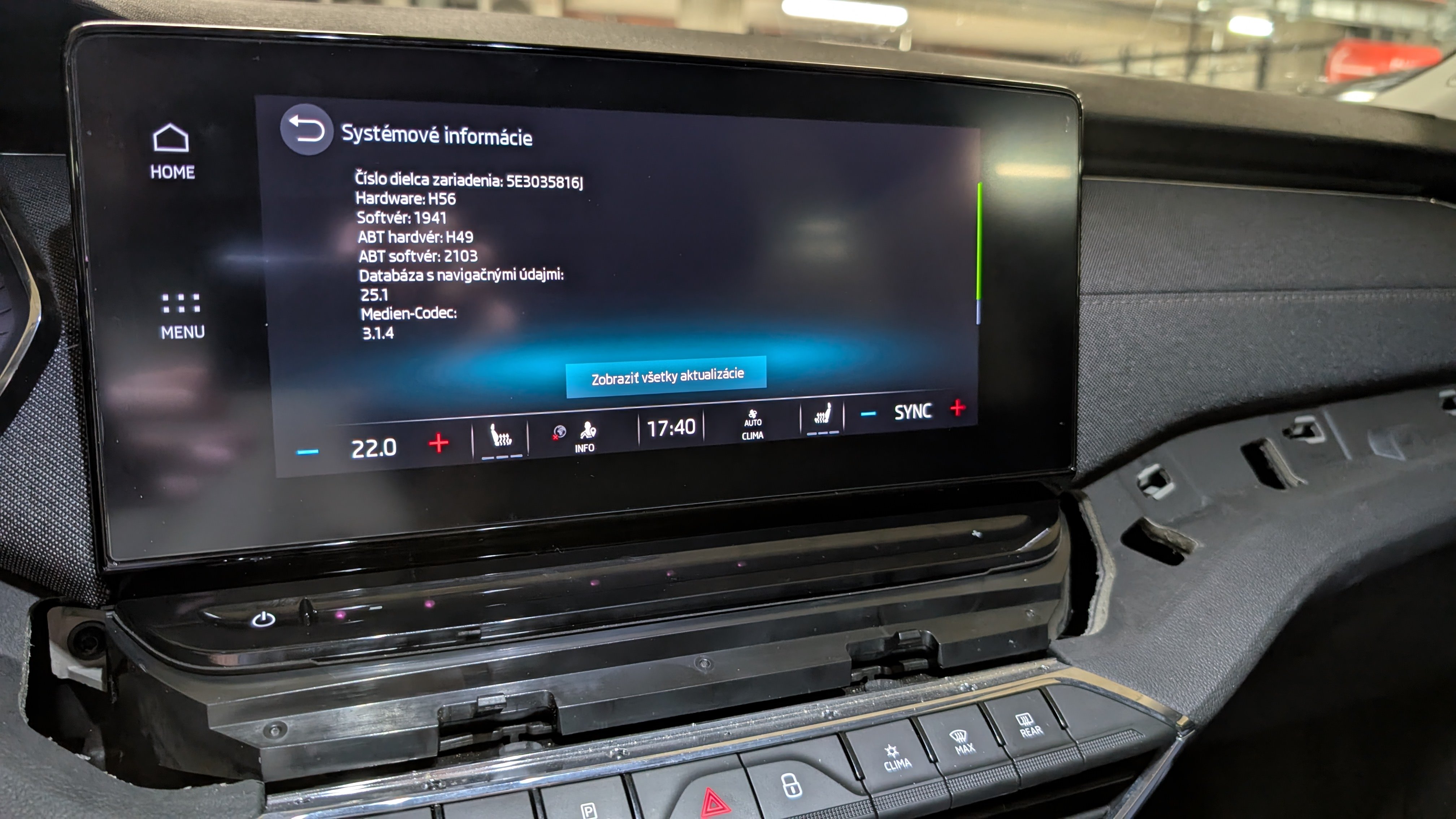

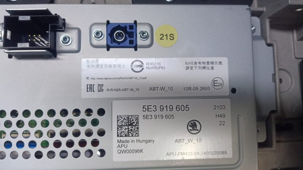

19 minutes ago, mmt said:
No coding needed and no component protection warning.
Now this is surprising.
Congrats! You saved yourself about 2k.
Hello @mmt ,
Congratulations for your work.
Can you share with the community more details about the source of the new display?
1.Is it brand new, OEM, provided by Skoda as a spare part?
2.Is it from an old car, from a junkyard?
3. Please share a link/URL from that site.
