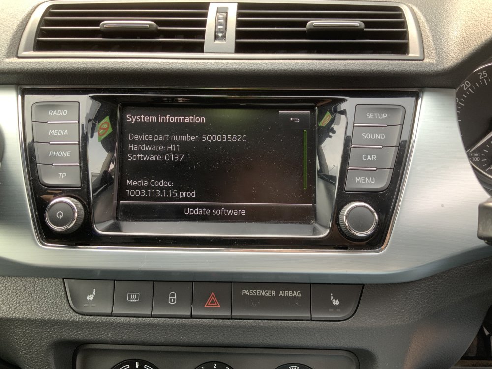

Pls post part numbers of your old unit and the one you bought from salvage.

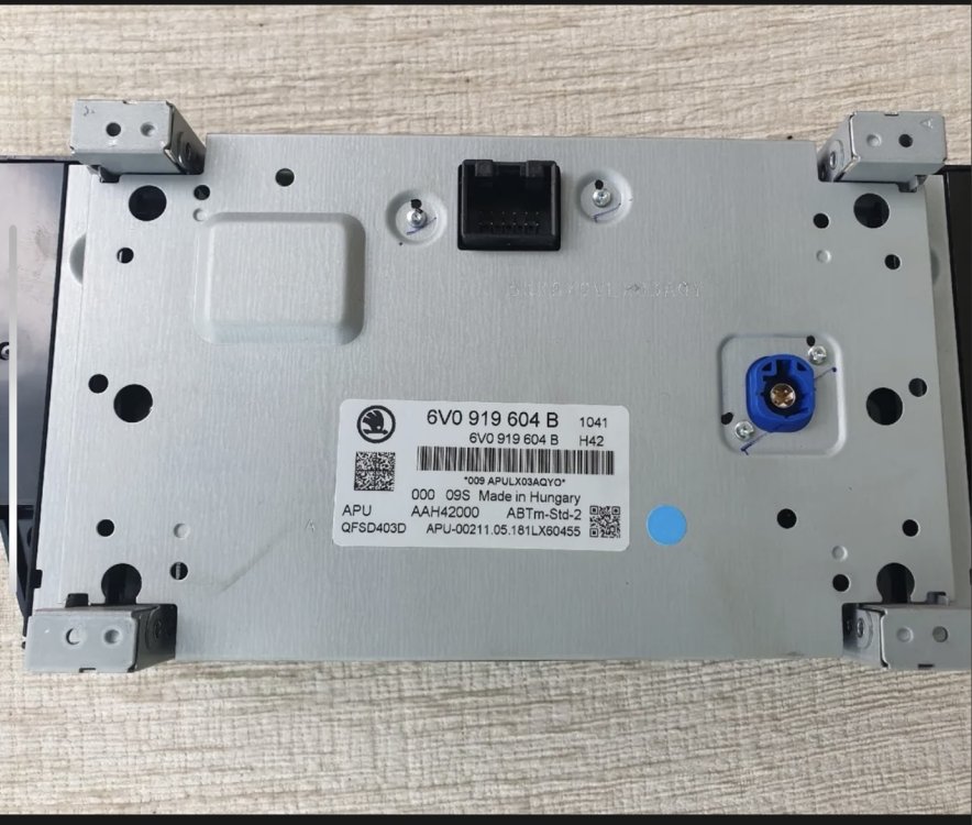

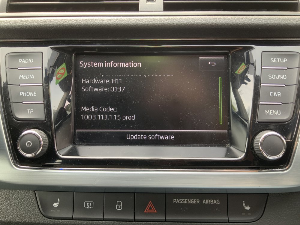

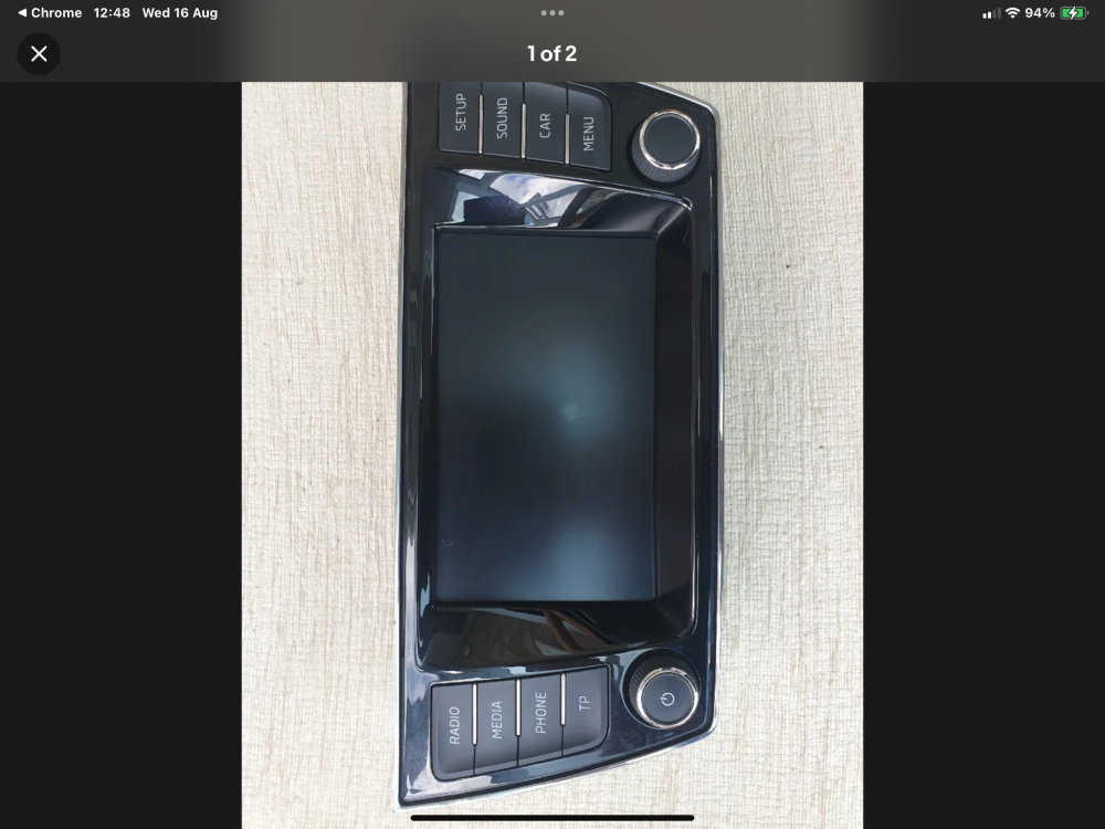

1st two photo rear of salvage unit 2nd pair of existing unit in situ, need to purchase some keys to extract unit as ones already have don’t work. Please bear with I’m new to this
The head unit comes in two parts, the display unit and the control unit itself. Looks like you've only got the display unit there.
