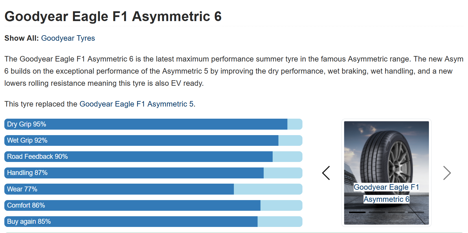

Have a mooch about on here.
https://www.tyrereviews.com/Search/Size/225-45-17
It's important to remember that different tyres can have quite different characteristics, on the same size wheel. Careful choice of replacement tyre may allow you to gain comfort without compromising other tyre characteristics you currently enjoy.
That site helpfully rates the different characteristics to allow you to make an informed buying choice. There is likely to be some margin of error, but it's a good place to start.
Bear in mind if you change your tyre width and profile, not only will you gain comfort, you will have to pay for that increased comfort by impacting other characteristics of the tyre.
If the only problem you have with your tyres and car handling is comfort, you may eliminate that one problem and inadvertently introduce a new problem by changing wheel size and tyre width and profile.
