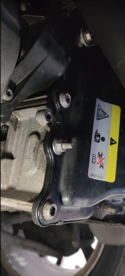

+1 on the above, I'd try cheapest repair first before sinking 650 quid into a fix you don't know much about, especially if there are no warning lights. I'd ask your mechanic to read the codes while he's at it to see if there's anything stored? Working under the car and not removing the mechatronics may well be the fix I had done though, in relation to the eBay guy.

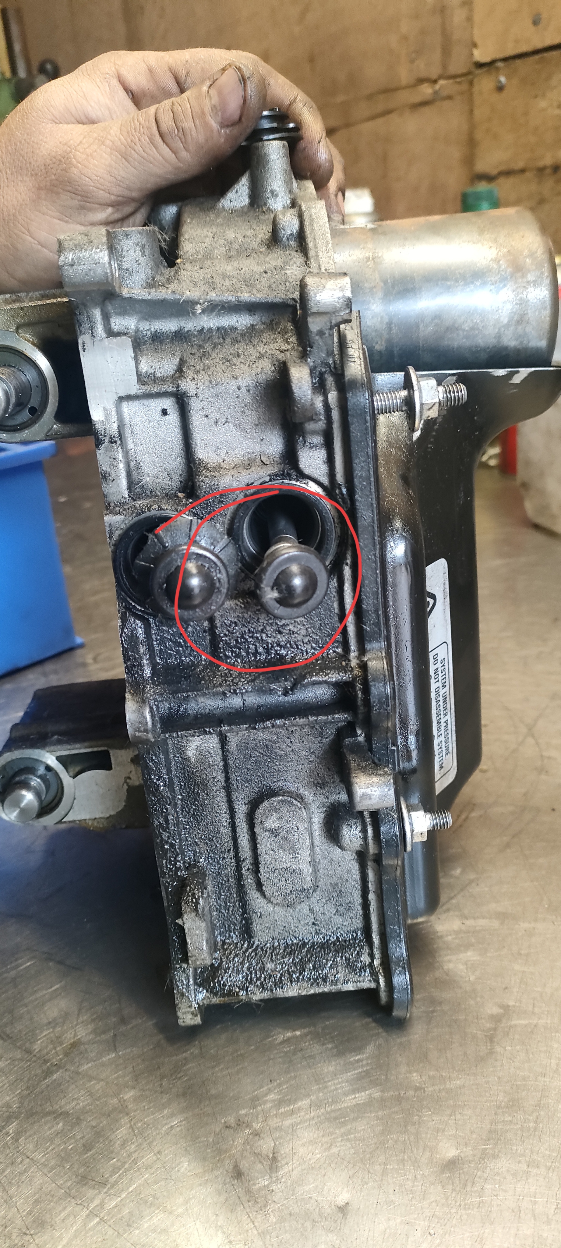

I had the mechatronic looked at by a gear especialist yesterday. they said it is leaking from the connector (i guess transmission valve) on the side of the mechatronic where the gear connectiong to the mechatroniic.. it is not leaking from breather. They offered me to replace the whole mechatrone with a brand new one for £1,500 (1year and 12k miles warranty)  or reseal for £360 without warranty. So, I am thinking I'll have it sealed with this expert VAG mobile mechanic for £260.

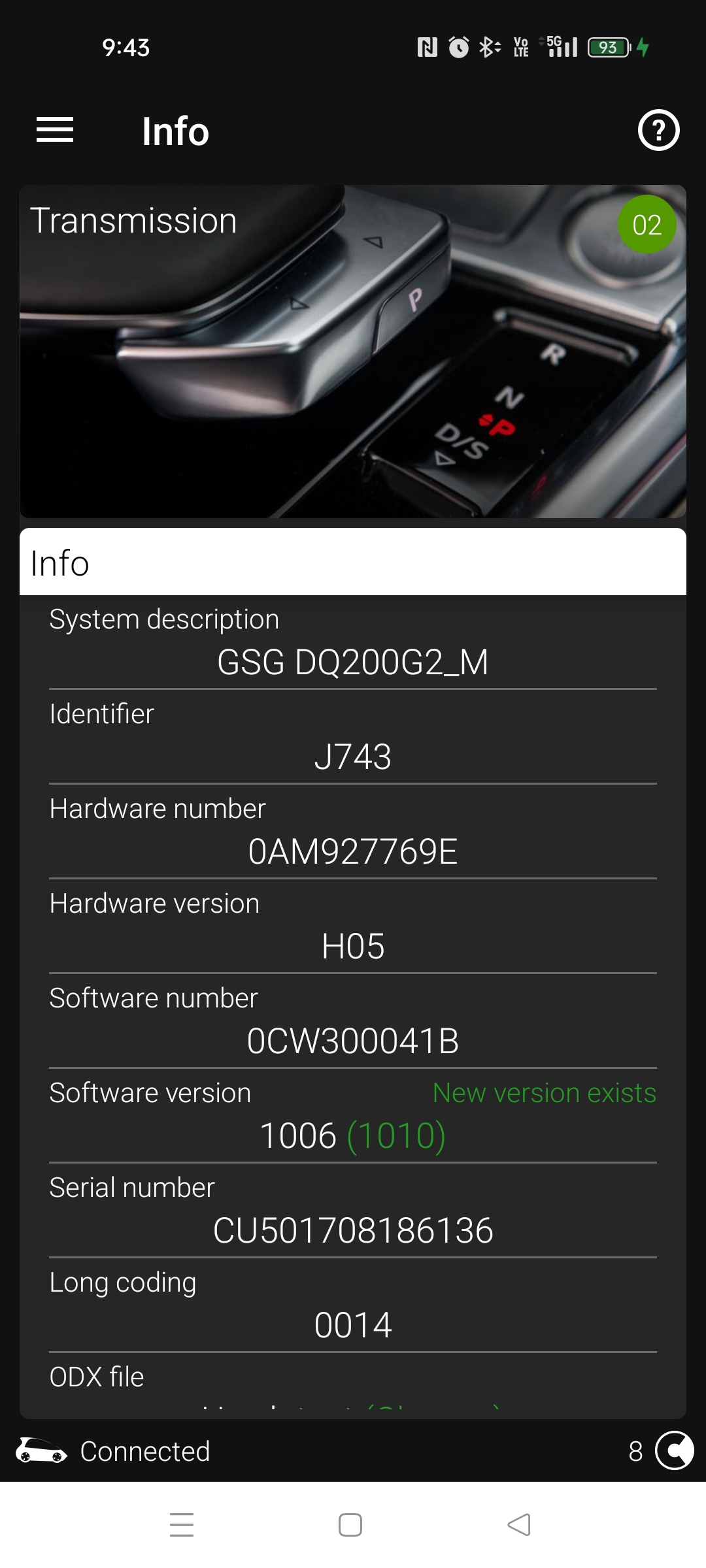

Just out of curiosity, did anybody update their transmission software version?  Mine is showing update available (1010).

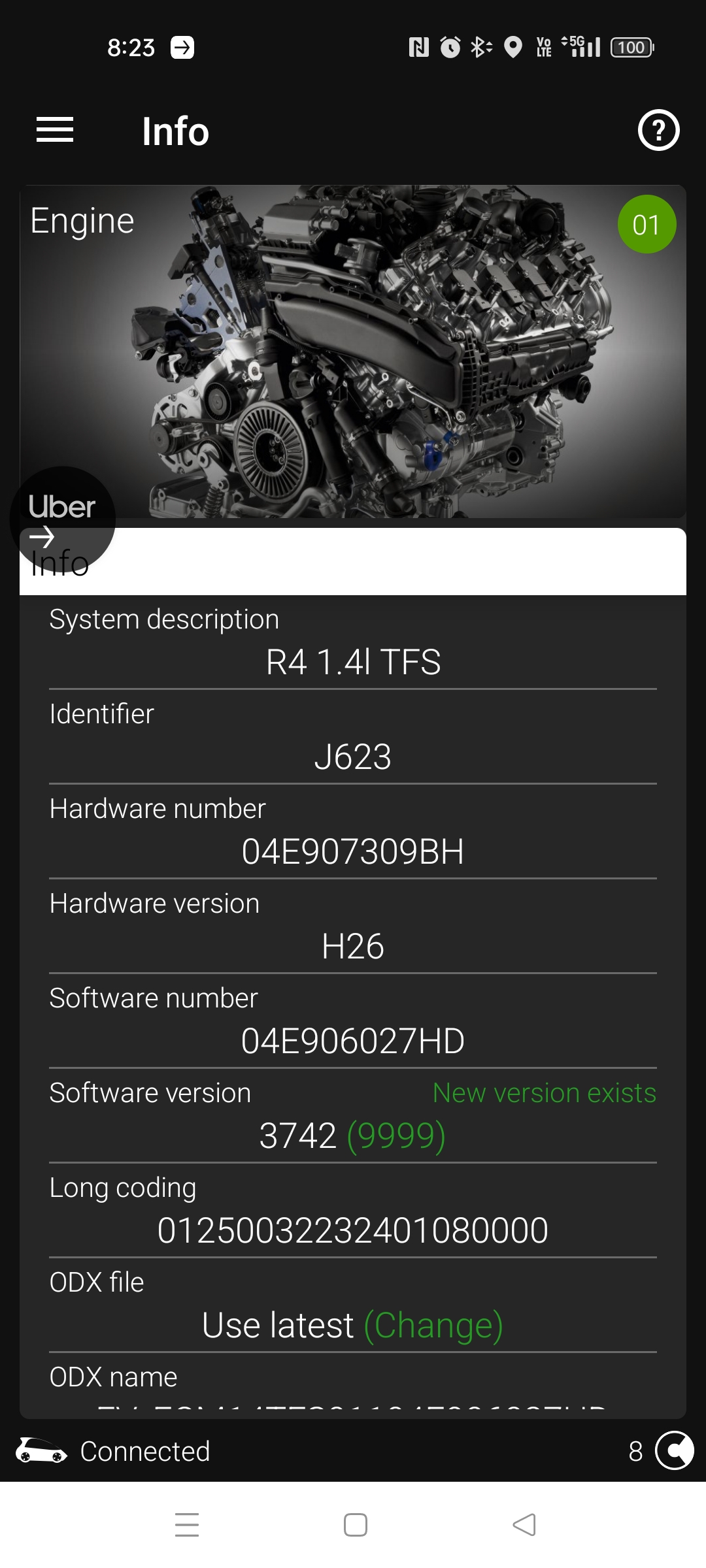

Screenshot_2023-10-11-09-43-54-59_e12f25f1a1eef3fba9ad2471f7cb9c73.jpgEven for the Engine as well, software update is available
Mine was done on a recall, probably around 2014/15
Hello, this is the update
I went to another garage and guy inspected the leak and said, it was leaking from the side connector (piston), not from breather. So his advice was, taking the mechatronic down and change the piston and refill with the oil and put it back .
When i told this to mobile mechanic guy, he said this is unusual and probably I need to replace whole mechatronic for £1300.. he said usually pistons and seals (green) are quite strong and they don't break.
Well, he said to take the mechatronic out he needs 2 fluids changing because he needs to drain both fluids. Then need to be programmed to relearn the clutch. Plus the labour and total costing will be £410. He gave me another option to have the gear and mechatronic oil servicing which is changing the oils and cleaning around the joining and so on wich is £260..he also suggested if it is not leaking too much..probably good cleaning and new fluid may seal it..
Guys, can somebody help me to decide. And also, do I need 2 fluids draining to take mechatrinic out?

Mobile guy didn't turn up, So, I went to the Garage who quoted me £360 to reseal it (including Mechatronic + Gearbox oil changed). They did the job day before yesterday and I had been driving since. Today I checked underneath and there is no sign of oil leaks or anything.
I think there was no damage of anything inside mechatronic. Just seal became weak. Fingers crossed no more oil leaking from the Mechatronic.
