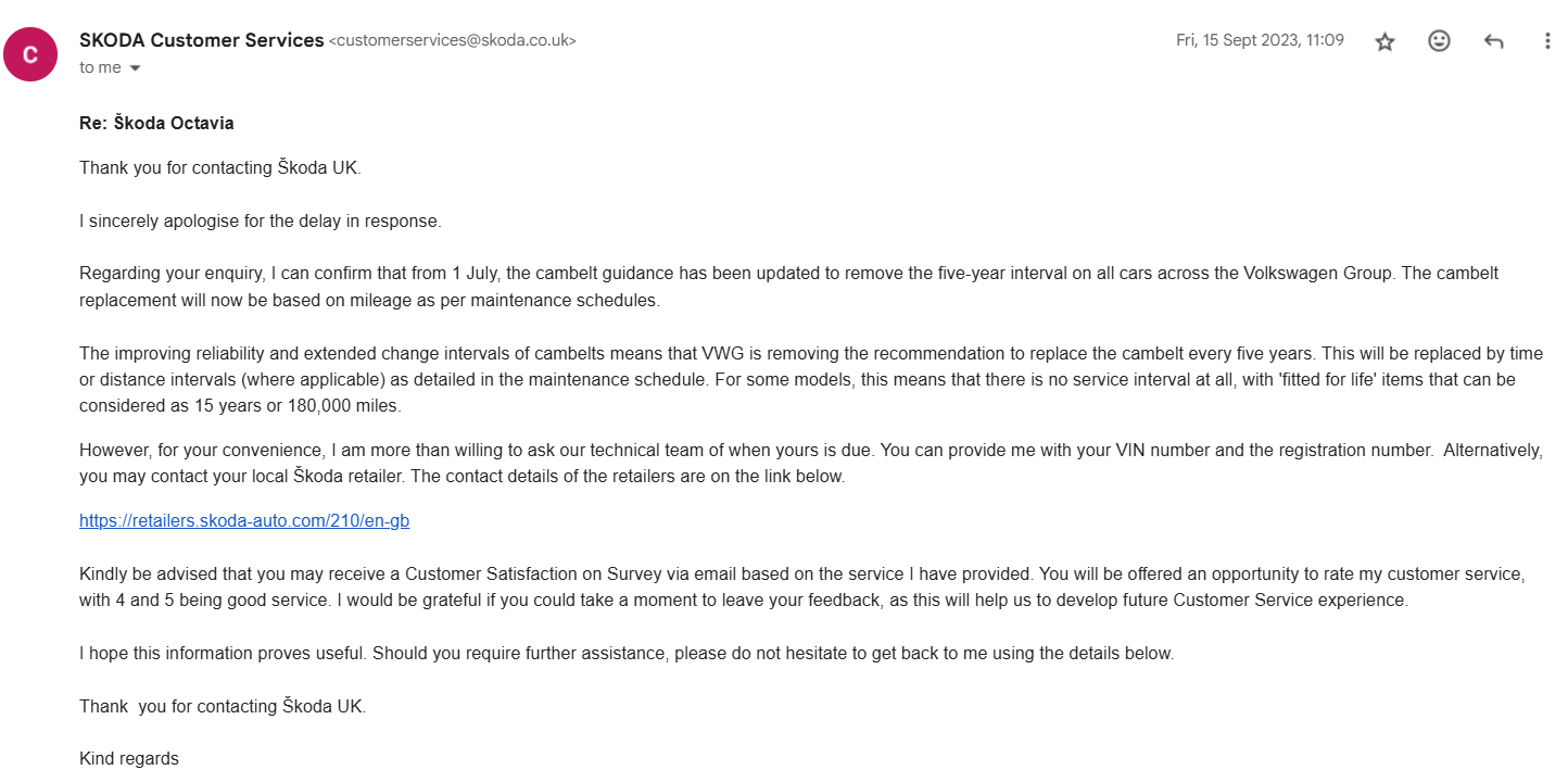

I saw a particular one at a Skoda main dealer with 67k miles - I rang them and asked if that 7 year old car had it's timing belt done - I was surprised at his reply - when he said I don't need to change it, as Skoda had very recently (2 months 'ish ago)  changed their policy on cambelt interval.
The main dealer has said (and he quotes Skoda):
"For some variants, this means that there is no service interval at all with a 'fitted for life' items that can be considered as 15 years or 180,000 ,miles"
He said, unless we lived in a dusty country we don't need to change the cambelt (and it is a belt not a chain).
Question to my fellow Skoda owners is - is this true - as buying a car of this age and miles opens a whole load of options for my son.
Is this true for ALL Skoda's - I drive a 2019 Superb myself - with only 30k miles - and was going to brace myself in 2 or 3 years to replace it - sounds like I'll be ok for quite a number of years - or have I got that wrong?

Hello Jakk, if this is a 1.4 TSI  you are referring to - that is correct. Previously, Skoda UK dealers were stating 5 years or (I think 60K miles) - whereas, IIRC, VAG (exactly same engine) was saying something like double that. I had mine changed at 6 years (recommendation was still 5 years at time) with only about 23K miles, my old belt and tensioner still looked new! - I believe the recommendation has now changed to inspections only until newly specified (significantly increased) period and mileage.

Finally got a reply from Skoda UK, and here it is (pretty much in full), and pretty much as expected after all the discussions and info here, in answer to my query last Friday which asked about the following vehicle:  2016 build/2017 model Fabia 1.2l 90bhp/66kw (Reg DF66 OEA, VIN TMBFM6NJ5HZ055263, CJZC engine) with a recorded approx. 45k miles;
Re: Škoda Fabia - DF66 OEA
Dear Mr XXXXX
Thank you for your recent contact with Škoda UK regarding your timing belt enquiry.
Please accept my apologies for the delay in my response.
I do appreciate your patience whilst I investigated your concerns.
I have contacted our internal Technical Support Team. They have advised that your vehicle is equipped with a lifetime timing belt with the recommendation of 180,000 miles or 15 years, whichever comes first.
I hope you find this information useful. However, if any further help is needed, you may contact me using the details below.
Kindly be advised that you may receive a survey about the service that I have provided. I would be grateful if you have the time to complete this, as it will help me to provide the best experience possible.
Thank you again for your patience and understanding.
Yet six months ago, the same Technical Support Team said the car was equipped with a belt which they recommended was changed every 5 years.
If I had paid £500 quid to have a belt changed on their recommendation and then I received a letter worded like that, I'd be livid.  Wonder who'll be first to ask for a refund.
But from who? The contract is with the garage and the garage were told every 5yr so they haven't done anything wrong. Do you take the garage to court and then let the garage recoup their loss from Skoda UK or do you take Skoda UK to court?  Potentially those 'no win no fee' lawyers could have a field day over this.
