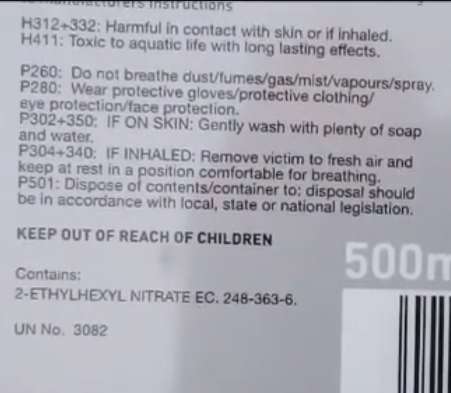

2 hours ago, EnterName said:
A good question, which I'm sure neither of us can properly answer.
However fuel sold has to meet rigorous standards.
Not sure fuel additives have to meet such rigorous standards or indeed what the standards for fuel additives are.
Certainly Millers don't seem to make any claims for their Diesel Power ECOMAX meeting any standards or regulations.
Just advice to watch what you do with it.
https://www.millersoils.co.uk/products/diesel-power-ecomax/
Fair point. However 2-ethylhexyl Nitrate is a common additive to diesel fuel https://en.wikipedia.org/wiki/Cetane_improver - and I doubt that Shell/BP/Millers/Fuchs, etc. manufacture this stuff themselves, they simply buy it and add to their fuels.
It is a very similar story with people buying Nurofen, and others Ibuprofen. I know some farmacist and they say that purity and quality of Nurofen is far superior to cheap Asda/Tesco Ibuprofen. Still, not a single Nurofen farmacist  saw the manufacturing process in person. I have been involved into manufacturing, design, etc. for many years and have seen many things. And I understand very well that buying in bulk is way cheaper than manufacturing.
I cannot prove anything, just like those who are against. It is just common sense. You can do what you are comfortable with.

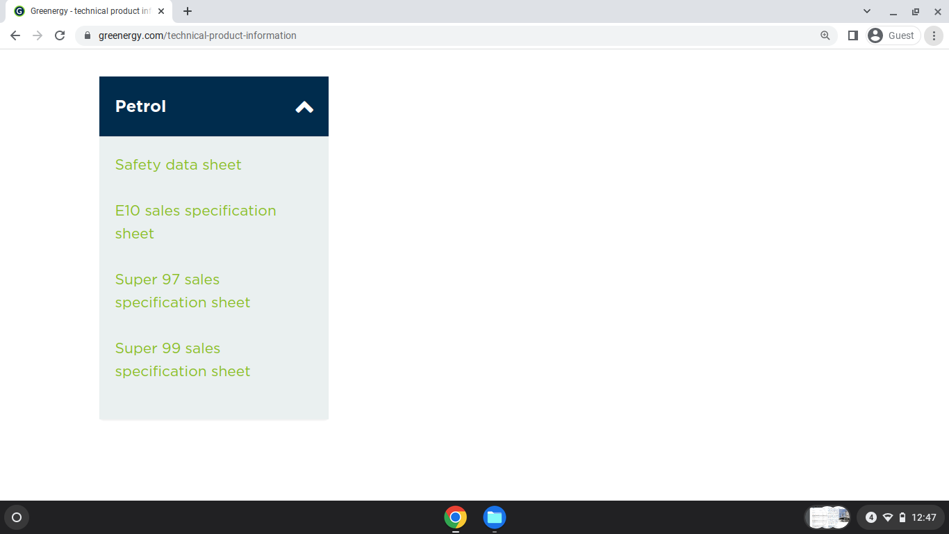

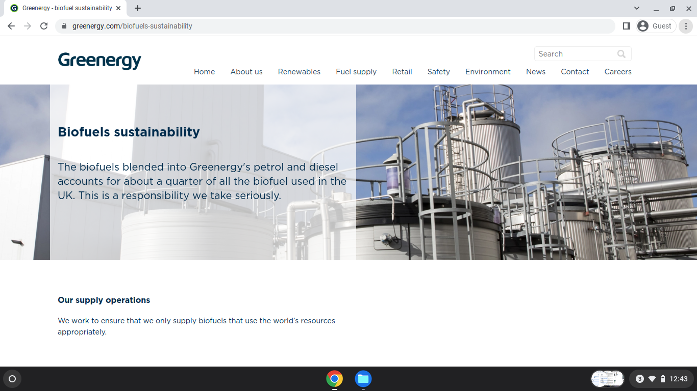

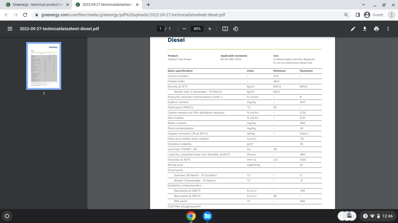

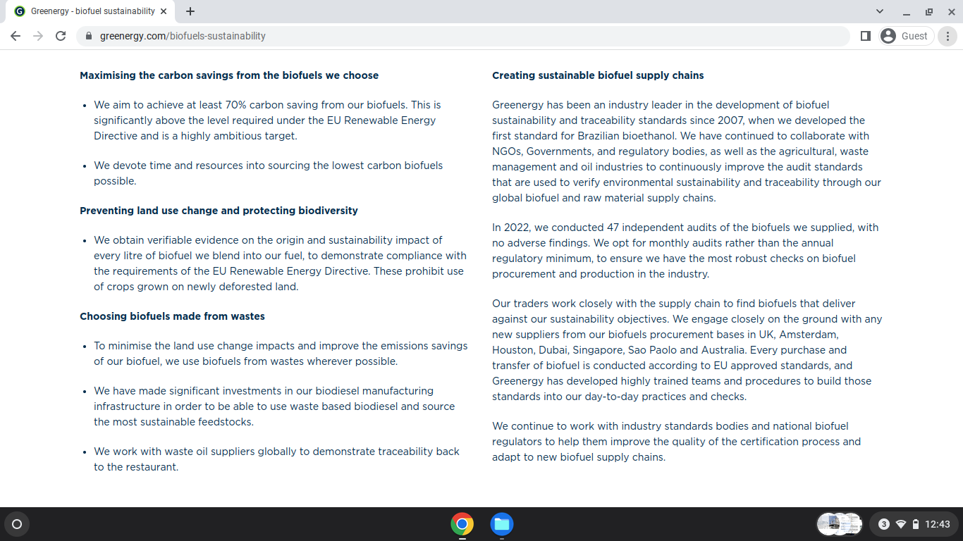

If interested in Spec of Diesel or Petrols, Unleaded / Super Unleaded then the Greenergy web pages worth a look.
