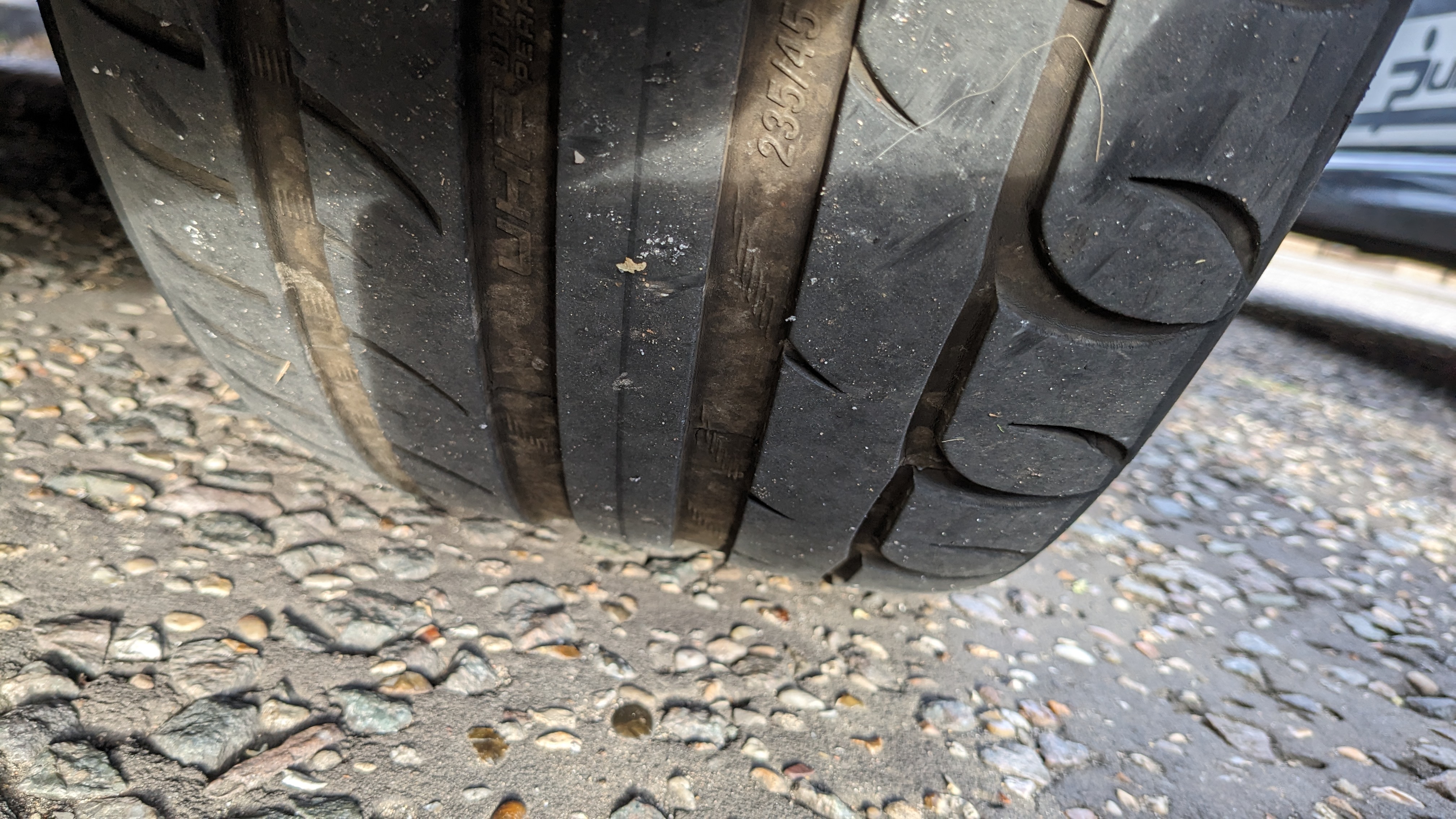

I have Riken UHP tyres fitted and they seem to be wear extremely fast and require 2 new front tyres. When I brought the car 3,500 miles ago they looked as it the reasonable tread left but now almost bald. Has anyone have any experience of these tyres at all? I have had Avon ZV7 before and 2 more fitted tomorrow morning.

Almost bald 😯 they are not even down to the treadwear indicators, their most productive life is still ahead of them, good news for whoever buys them as part worns.
Bad news that they are rubber bands for whoever has to drive on them or travel in the vehicle.

They have worn very evenly which is a good thing, you are still throwing away their best miles though.

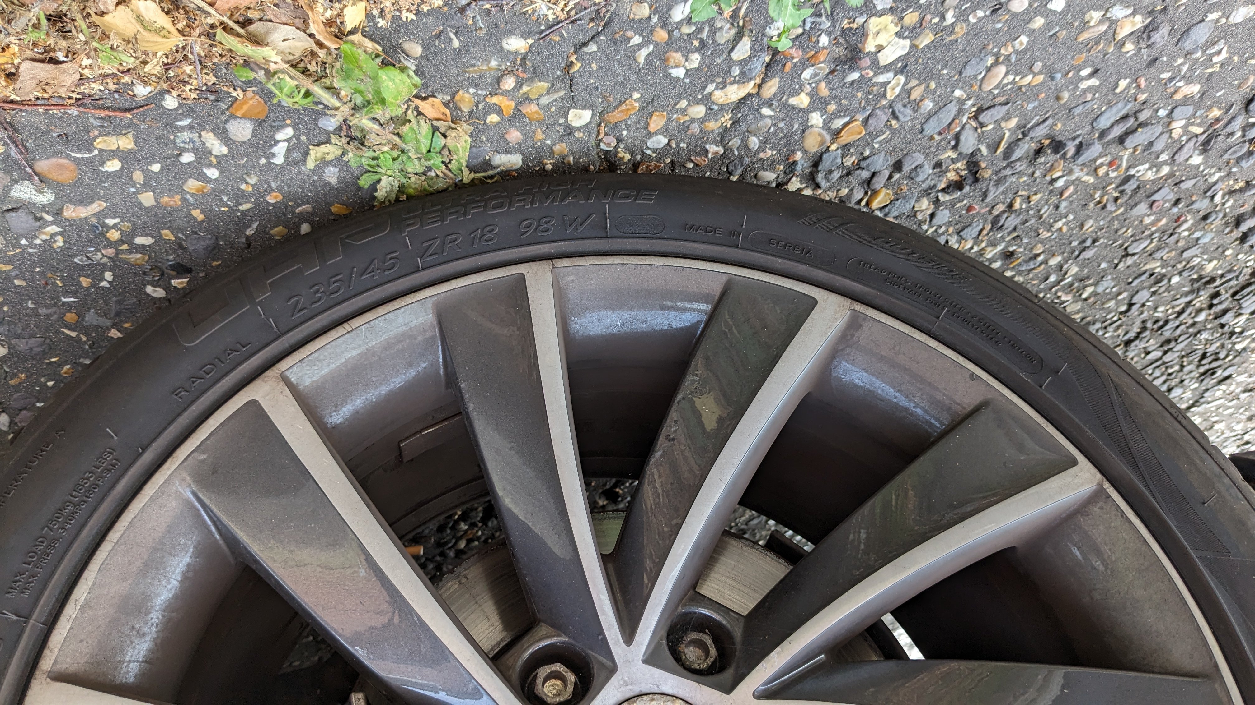

Is the 2422 shown in the photo the date code?
I think it is because its a removable tab in the mould, you can see the male impression of the counterbored fixing screws sticking out from the tyre rubber.
So those tyres have lasted just over a year, do you by any chance know from the MOT history how many miles the vehicle has done in that time?
Editted, probably less than a year unless they were shipped to the tyre place and fitted almost immediately post manufacture.

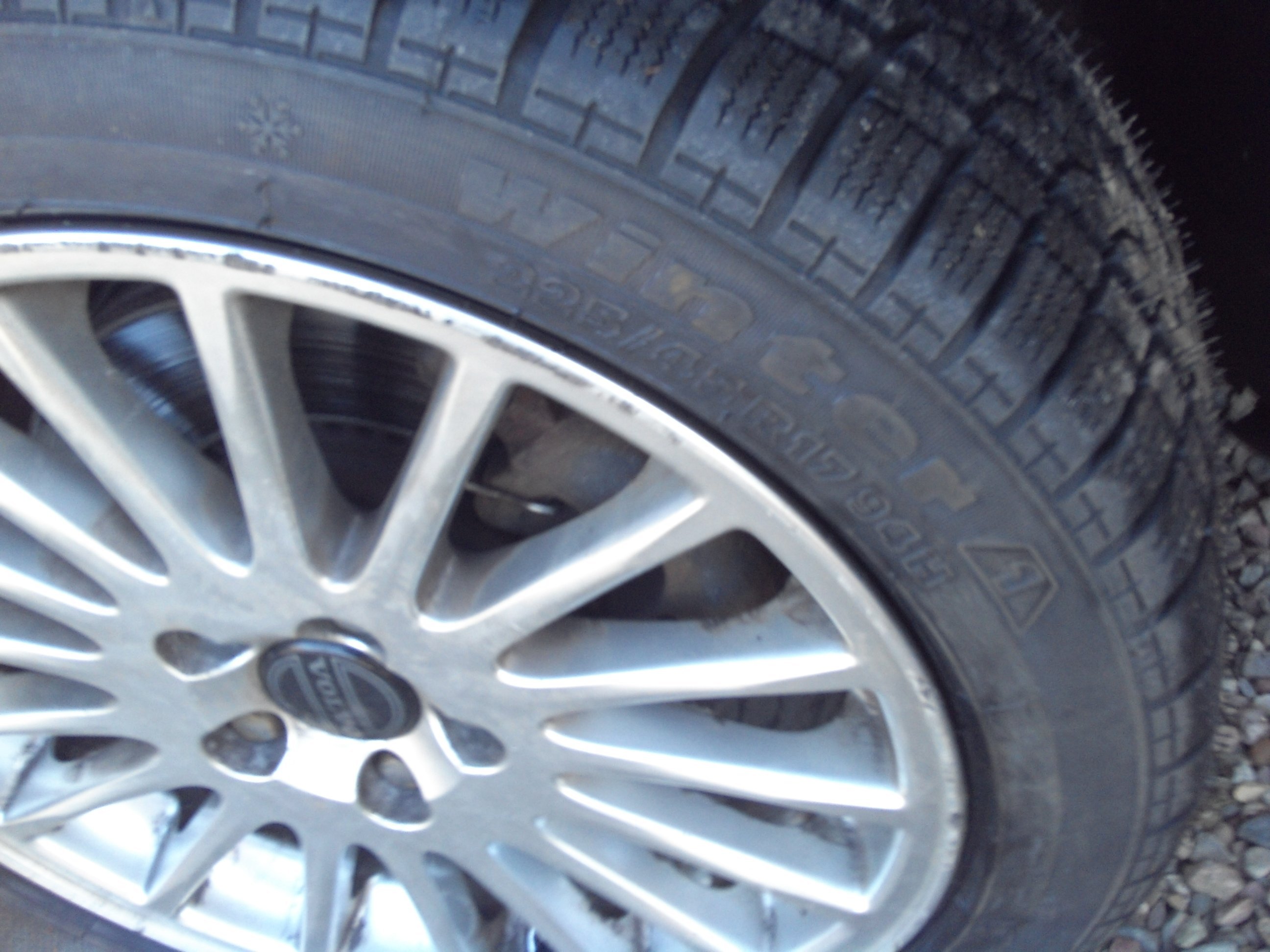

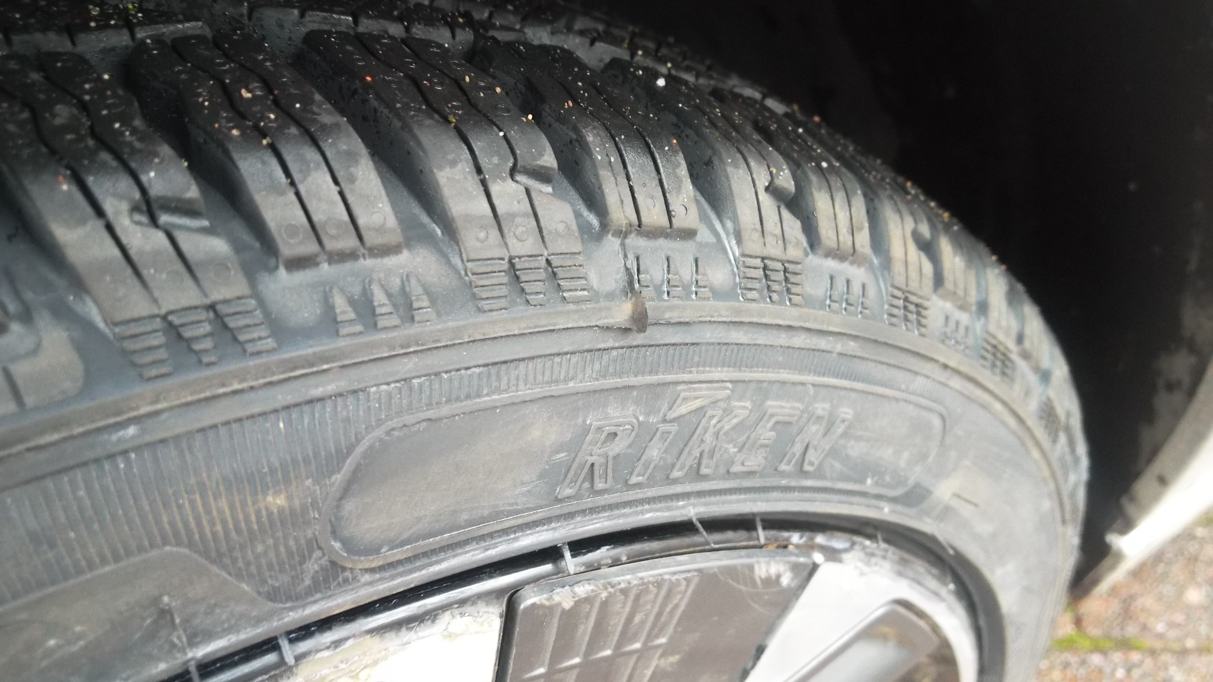

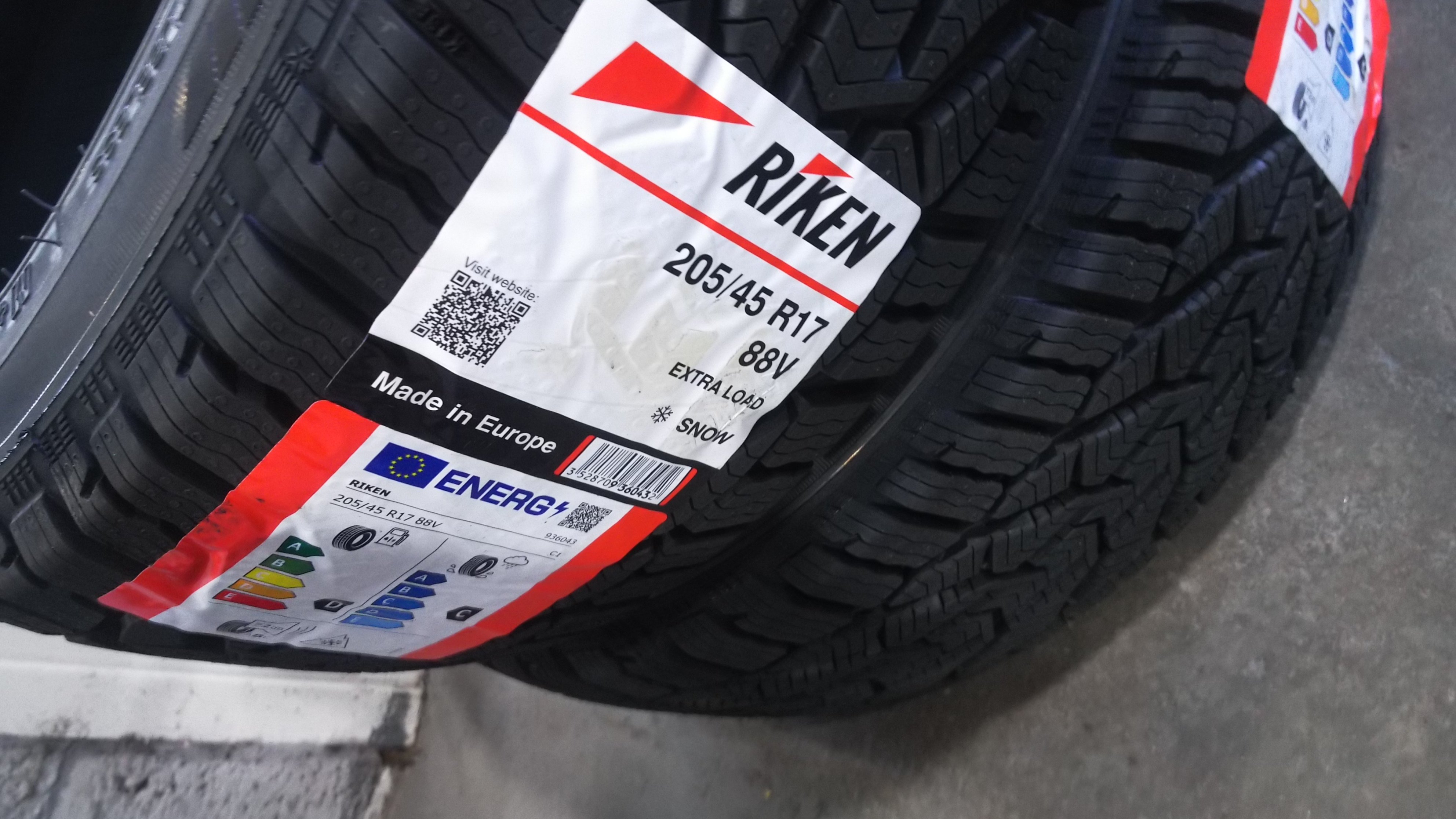

A company owned by Michelin and when i wrecked my Michelin All Season Alpin 6 i put on Riken snow tyres because i used to use Riken years back.
But then i used to use TIGAR Tyres as well, another brand / factory Michelin own.

Yes it is the date code, 24th week of 2022, and it was mentioned in the MOT advisories for 2021, 81,968 miles (that there were nails in both rear tyres. When it was tested again in October 2022, 125,490 miles there were no advisories. When I purchased the car in June it had been MOT'd by the dealer in April 2023 @ 137,642 miles (no advisories) and now has 141.300 miles on the clock so I'm guessing they were fitted around July 2022, as the rears have 5.6mm of tread left.

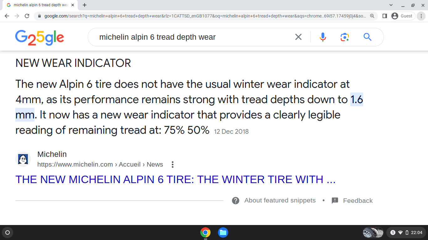

Has ROSPA Commissioned anything in the last 20 years as the manufacturers have carried on developing tyres?
Some come with very different depths of tread new now and ECO bias and with crap friction / traction / longevity,
Look as the tread lasts, pity their durability does not.

Yeah I've heard this claim made by Michelin. "Strong" is a somewhat odd term to use when describing tyre performance, and allows plenty of wriggle room for interpretation.
It might be true that 1.6mm of treat will shift water out of the way as well as 6mm, but I'd like to see some independent tests evidence to support it.
They changed that i think.
All season tyres with so little tread in winter conditions would be pretty much like the best of Summer / ECO tyres as VW Group fit with a full tread.
