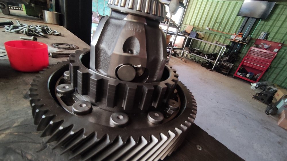

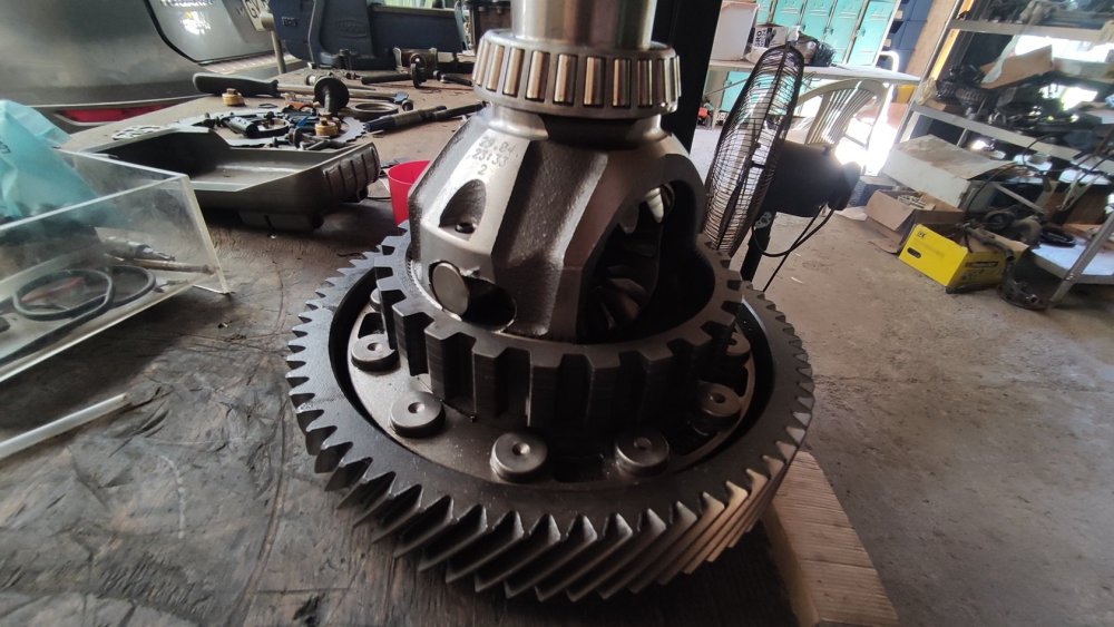

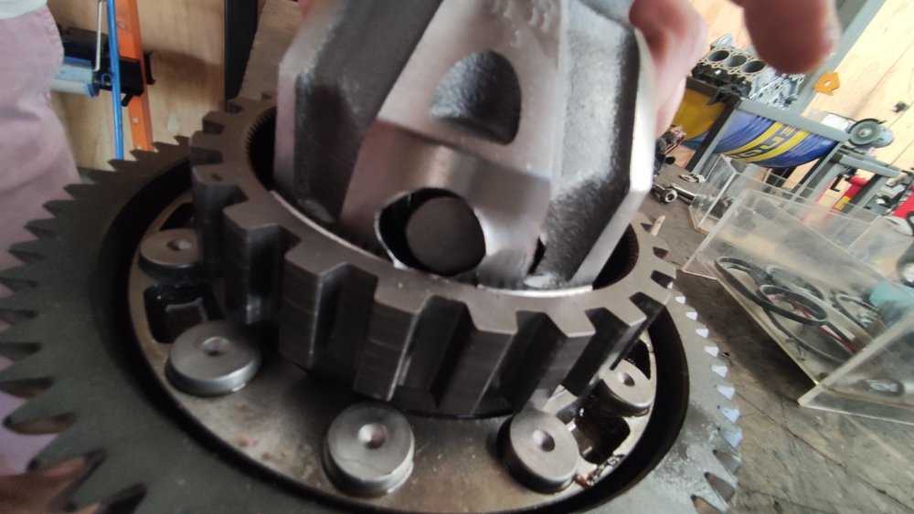

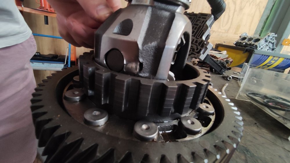

I found the issue....
The pin that hold the spider gears ate away its housing in the diff.
The pictures and video talk by themselves.
The slack I felt in the drivetrain could also be on CV joints or axle splines (I believe some DQ500s in T5s have this issue).
